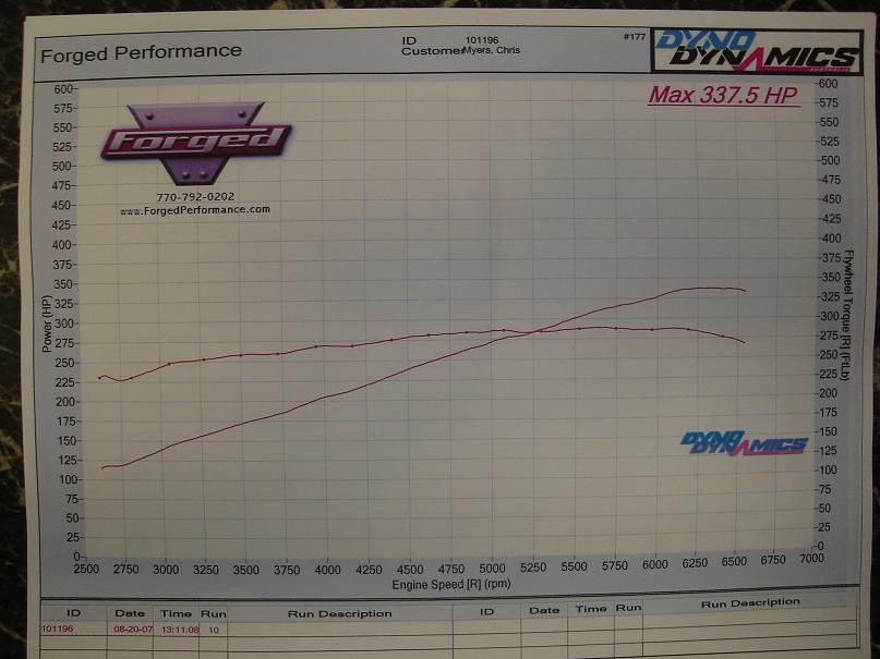

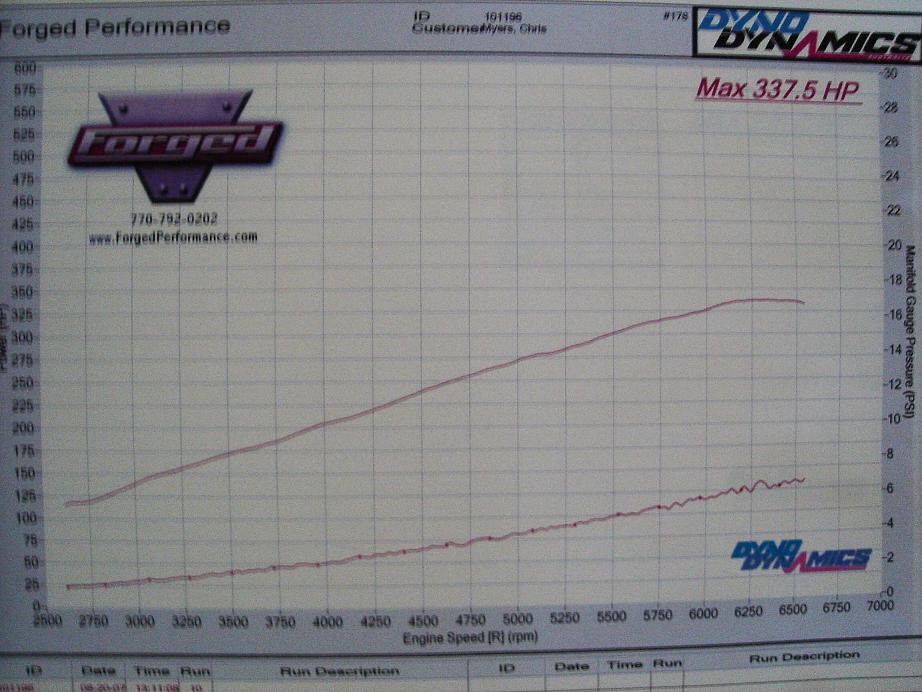

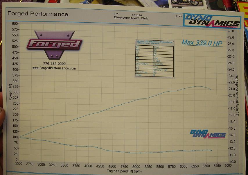

Well, just got back from Forged Performance where i got my car tuned/dynoed.
Ended up with 338whp and 285tq. I said id be happy with 325, so my goal was met. Dyno was a Dyno dynamics aka "the heartbreaker". Boost is about 7psi.
Had issues with my walbro so i had one installed at the shop. Had to limp it 130 miles to get there. On the way back had 1 issue. my charge tubing popped off the TB. I was like ****! when it first happened and before i popped the hood. Once i gave it a pass over i saw the issue and remedied it within 30 mins. Good thing i brought my tools, looks like im going to make a habit of bringing tools with me (gotta get one of those tool pouches).
So, the drive home was fun. Didnt really get into boost much. Maybe 3psi or so. Gotta get used to it. I also want to give the car a once over tomorrow to see how shes doin. Oil pressure dropped a few pounds, guessing that had to do with the SC resistance?

looks good!
good numbers on that dyno for being on the 3.33 pulley

hey, where's the power CURVE? *haha* just kidding, chris... glad you are finally boosted! sorry that i missed you while you were down... you should have shot me a PM and i would have stopped by the shop to check out your shiz...

Was this on a AT5 ?
Welcome to the world of load base dyno's !!!!

Nice.. Take it to a dynojet.. I make like 100whp on Sharif's dyno.. Oh, and his dyno puts a load of load....

no reason to waste money on another dyno IMO. dynojet would probably be like 350-360 whp

Good job on the self install. What would the 3.12 pulley do? like 360+?

A Mustang Dyno may put a little more load to the load....lol
I think Sharif's dyno is around 9% lower than a dynojet [ from what others have posted ]

The 3.12 pulley adds about 25-30whp on our dyno.
