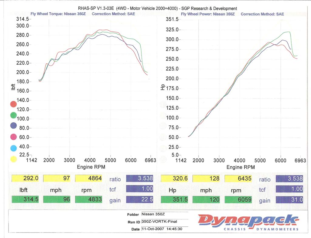

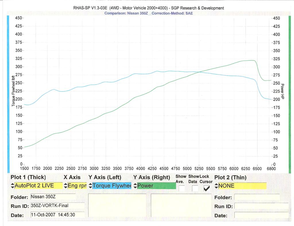

Well, we are back. The Z has been to Planet Houston (SGP Racing) and Mark and Thomas have performed miracles in tuning the ECU and UTEC. Mark utilized the Osiris Pro Tuner software to make the ECU work with the UTEC and minimize the problems others have been discussing (UTEC with Vortech with RevUp......harsh shifts, rough idle, etc.). Further, they spent quite a bit of time smoothing out the nuances of the RevUp tuning (variable intake AND exhaust timing) and the dyno sheets prove it. Notice the near linear final HP graph (the one in green) and near perfectly flat Torque graph, both perfect all the way to the rev-limiter.
Now, before the 'number guys' flame us for 'low numbers', bear in mind that this is on a DynaPack Chassis Dynamometer (you know, bolted straight to the rear hubs, no rubber-to-rubber interface) and our goal here was to extract as much useful STREET power in a reliable/rugged daily driver. Regardless, we picked the car up at SGP in Houston and set out on a 200-300 mile road trip to 'settle in' our baby. Along the way we distressed a wannabe in a Mustang GT (quite the confused look on his face) and got stopped once by Mr. LEO (Law Enforcement Officer, who turned out to be a 'car guy' and let us proceed unmolested once he ascertained 'is that an intercooler up front?' was actually a 'charge cooler' hooked to a Vortech).
It always pays to maintain a sunny disposition and carry a BIG STICK ! ! !
Needless to say, we are very pleased with our final result and highly recommend the Vortech (with our 'little upgrades') AND A QUALITY TUNE ! Thanks again to the consummate professionals at SGP Racing ('Performance, not promises') who made the final process the easiest of all.

Mark at SGP had related that it was running around 8-9lbs. during the tune via the UTEC and that sounds consistent with the 3.12 pulley on the RevUp motor kit. We are going to get the Innovate gauge hooked up to the MAP sensor in the next few days (just one of several small items remaining on the to-do list for this project......damn work keeps interfering) and then we will have instant feed-back every time we start the car up.

Okay, I feel better. I know dynapaks read lower and wanted to see what others are making on this dyno. I just got tuned by Mark at SGP and made ~310 whp at 6 psi of boost with the 3.12 pulley (non-revup). I found the leak and will have it re-tuned soon.
BTW, that power curve is so smooth and linear. Congrats!
