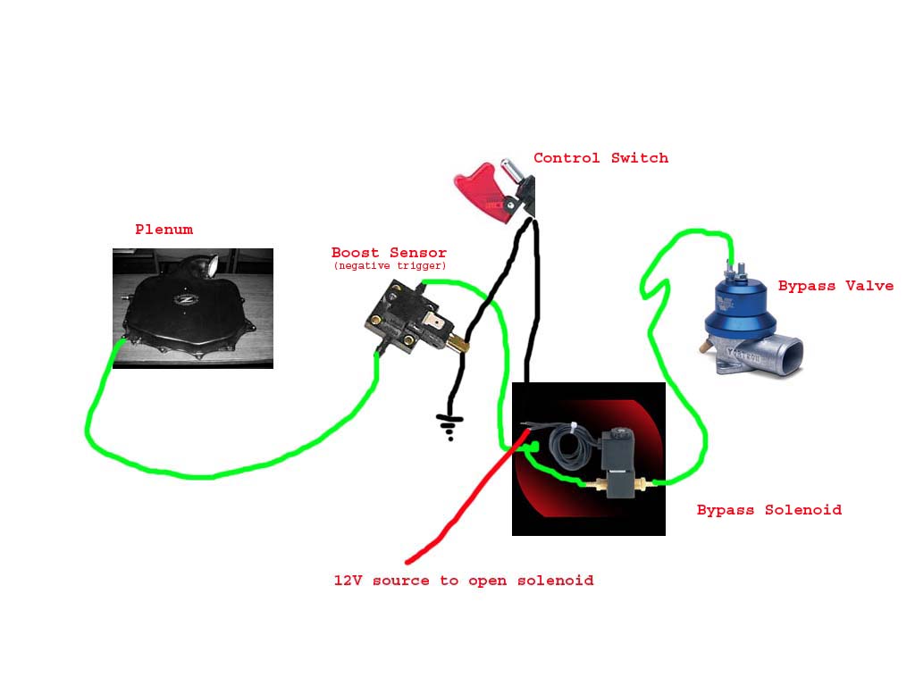

Hey guys,
a couple things got me thinking. SO i can see 15 psi on my vortech. Too much boost. simple solution would be get a 3.12. But thats a hassle to swap out when running race gas at the track which would support that boost level.
Is there a reason that this wouldnt work?? Follow along...
Using the boost pressure switch inlcuded with a standard water injection kit. Once a preset boost is reached it sends a trigger to the bypass valve solenoid, i referenced in another thread (available from Snow).
I'm not sure how that bypass valve solenoid works, but Snow uses it to dump boost out the bypass valve if it get a trigger from a low water level gauge. The only drawback would be is that it would dump all the boost (pretty much what the bypass valve would do if you could boost that high). So from a safety standpoint, it would be good. Not a cool as just bleeding enough to stay at a constant psi though...
So essentially, instead of a low water level trigger, it gets its trigger from the adjustable boost sensor.
Plausible?
That way you could have a switch on the boost sensor, so for daily driving, you could make sure not to boost too high even if you get on it. Then you could disable boost sensor the system and run full psi.
Pardon my poor PS effort

It has been done before with a wastegate.

no one can give exact specs on how to do it. if you know exactly the wastegate and the springs to use, please post it.

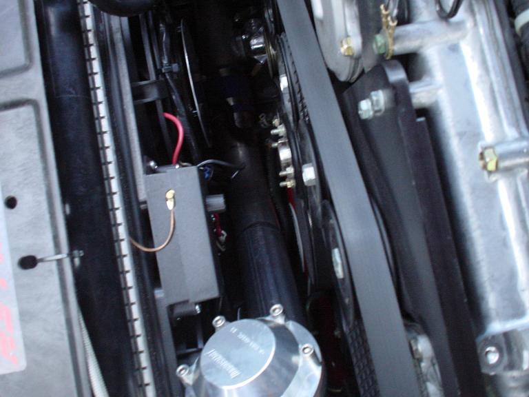

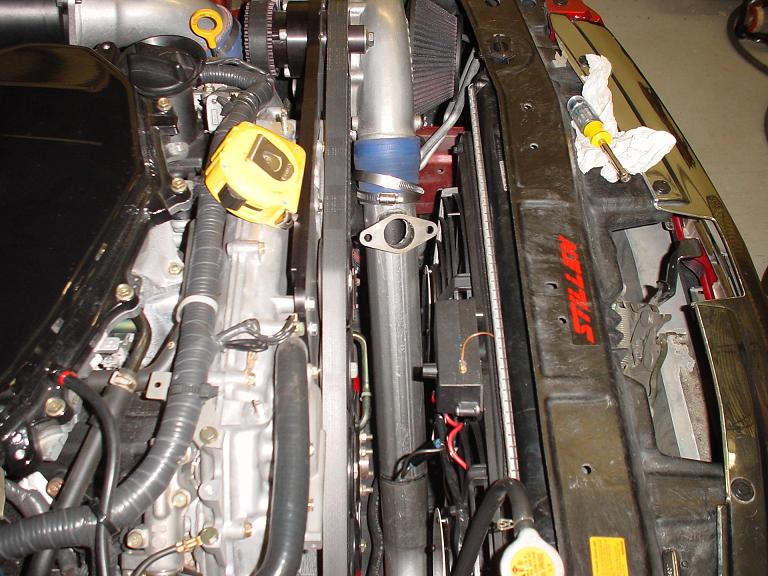

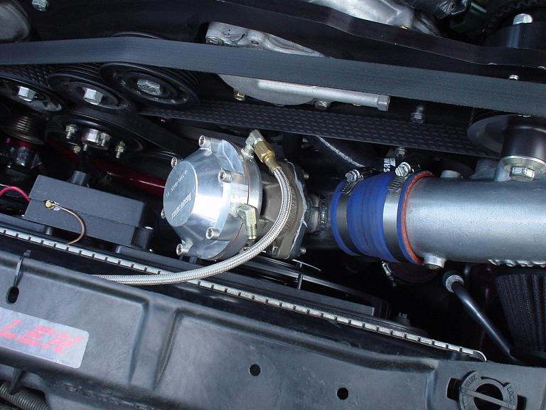

there's been like 3 people who've tried it, but only one person did get it to work and posted these 3 pictures
Who was it that got it to work--are they still around? It'd be really nice to have a writeup.

I talked to the guy who did it several times about it . He got it to work using a wastegate and an elec boost controler . He tried a manual one , but it wouldnt react fast enough .
My shop used a preasure regulator and it seemed to work ok , but we didnt go any further with testing with it on the dyno . We only dd a couple dyno runs with it on . I didnt want to go any further because of ther time it would have taken to get it to work good enough .
