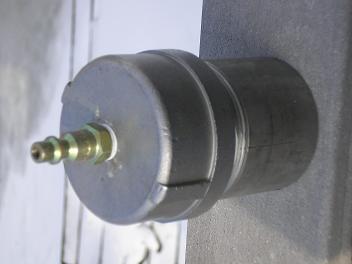

A little to much trouble for most of us . I just hook this baby up to the IC pipe right before the bov and then cap off the exhaust . Pressurize the whole system and walla , you found your leak .
