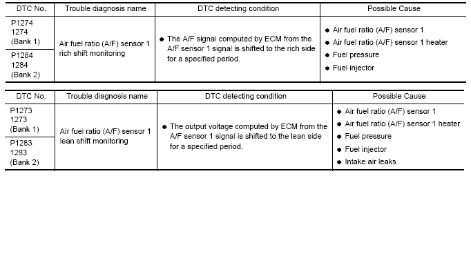

You've already found the thread where these are discussed. I'd recommend doing what turbonetics suggested and swap out the two factory O2 sensors on the downpipe. If the codes switch, then look at getting a new sensor because it's a likely possibility that one is bad (most likely the one that was damaged.
Your shop is telling you it's a MAF issue, when it's not. It's something with the O2 sensors.
https://my350z.com/forum/showthread....highlight=1273
Here's a good one.
Old Mar 23, 2008 | 08:50 AM
taurran's Avatar
taurran
Joined: Oct 2004
Posts: 9,482
From: .
Either take these out and switch the holes, or swap the plugs on the harness
If that doesnt work, find out which one was frayed and replace it.
Either way, the codes you're getting shouldn't harm operation. As long as the car is running strong and it is showing acceptible AFR's on an aftermarket wideband or on a dyno graph AFR, then there is really not much to worry about.
