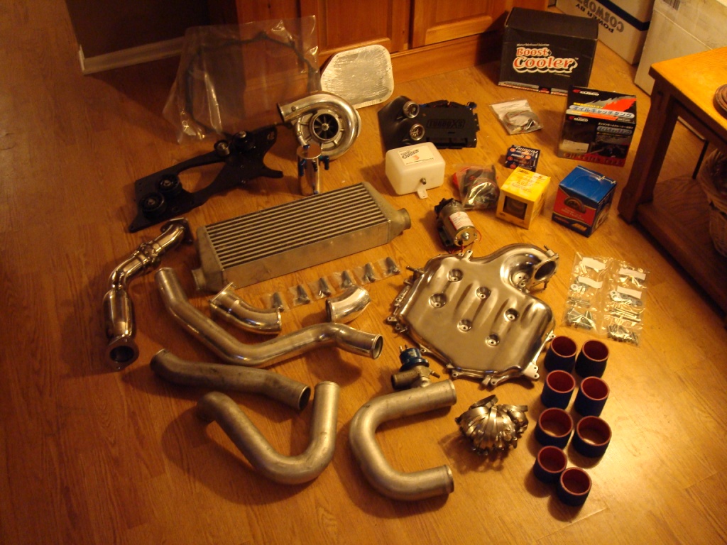

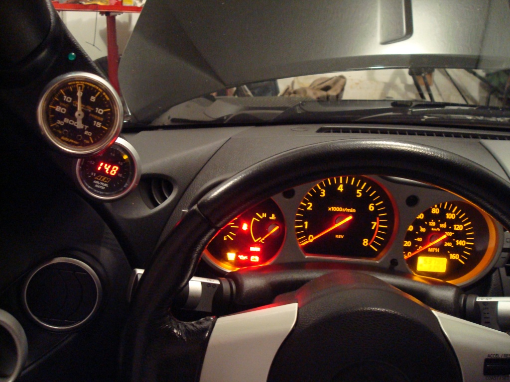

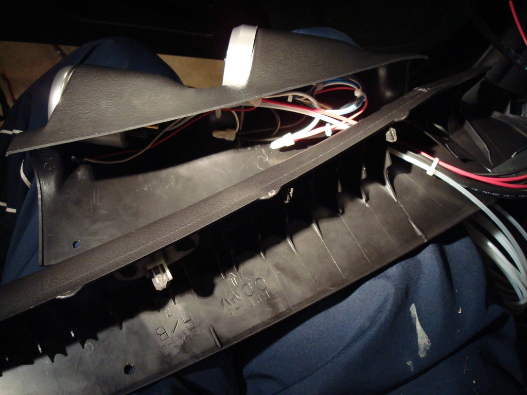

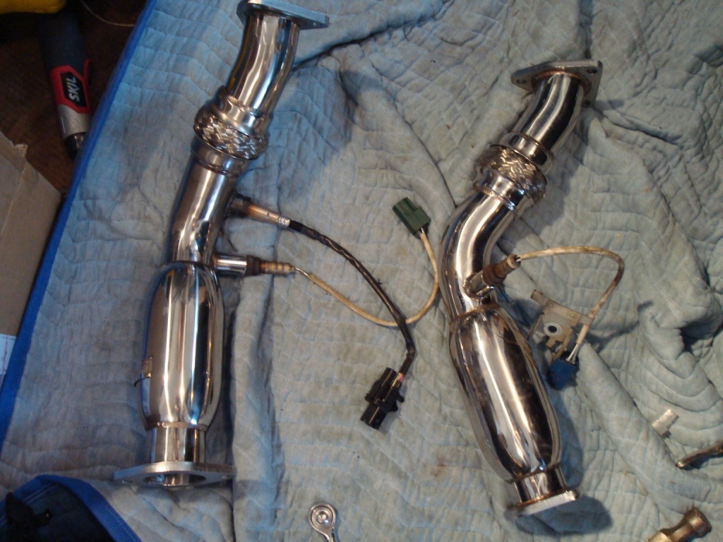

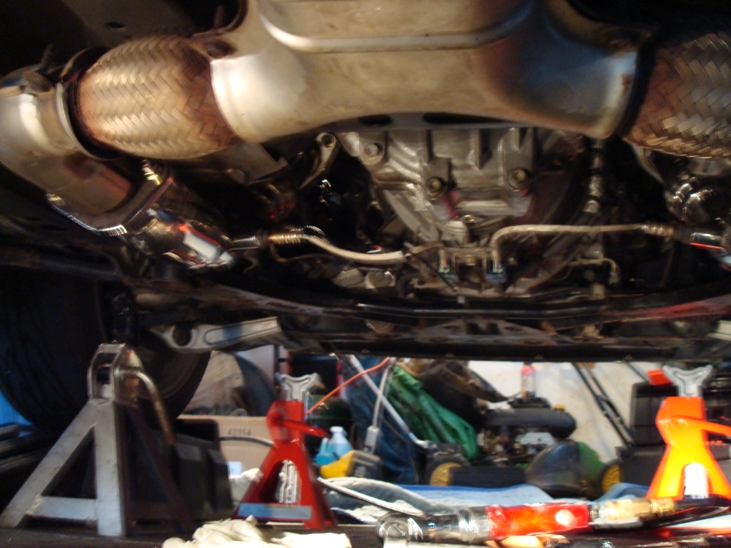

I wanted to make a little picture show of my install to share something with this site and all of you out there. I have enjoyed reading, looking at pics and videos of many of your cars so I wanted to return the favor. First of all I want to thank everyone who has helped me and those who have posted info on here. I knew nothing about my car six months ago when I purchased her. I spent months doing research on here and basically learned everything I needed to know. I have never done much more then bolt ons (exhausts, intakes etc.) on my previous cars so I owe it all to you guys for educating me to be able to do this. I started out with laying everything out and it seemed a little overwhelming. I had set a date for May 2nd for tuning at Forged so I had no time for any mistakes or setbacks. The hardest part was getting the little pieces and parts to make everything work together. I made many trips to various tool and car parts stores along with many orders on ebay and from vendors on here. Once I had all the parts I made a plan of the order in which to install everything. I started out with installing my gauges and test pipes. Also, I would appreciate any advice if any of you see something wrong or something that you would do differently. Thanks in advance and enjoy
Attached Thumbnails My 10 Day Build-parts-layout.jpg   My 10 Day Build-gauge-wiring.jpg   My 10 Day Build-gauges-installed.jpg   My 10 Day Build-megan-tist-pipes-wired.jpg   My 10 Day Build-megan-test-pipes-installed.jpg

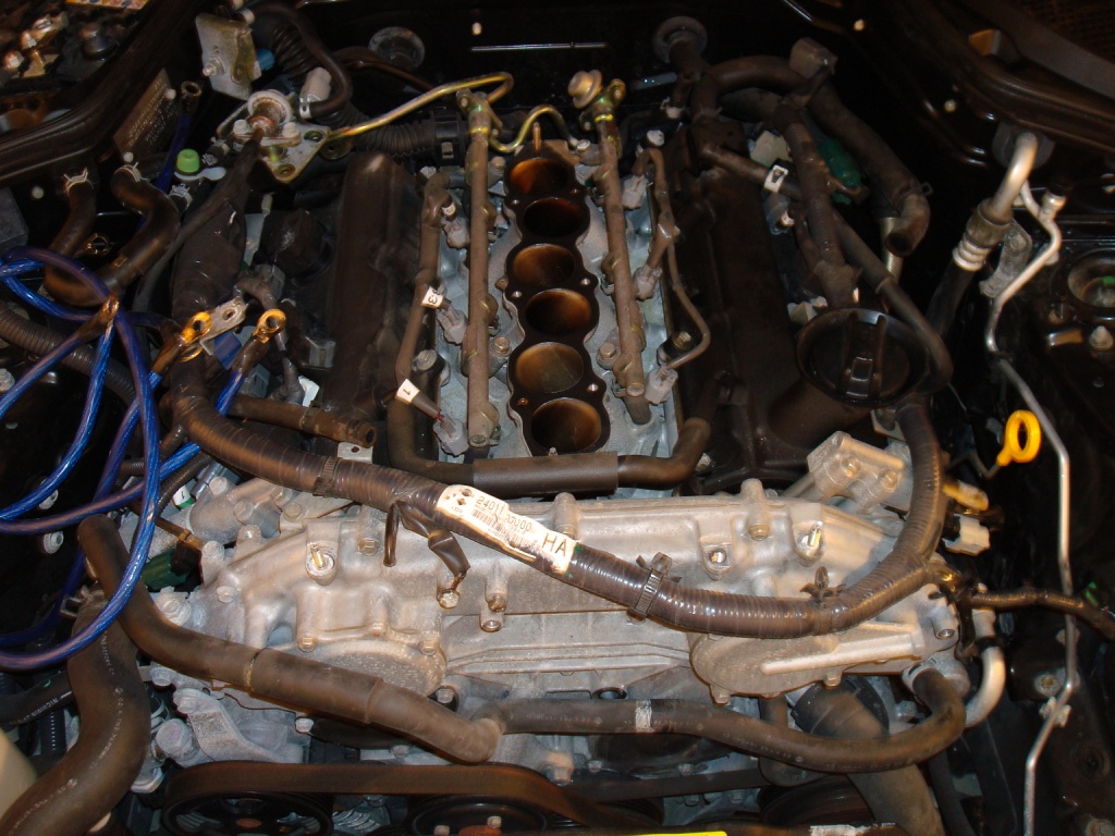

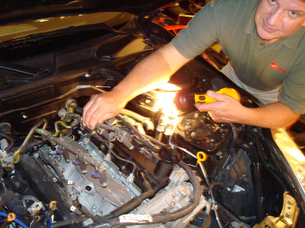

I put Detschworks 600cc injectors and replaced my spark plugs. I gapped them to .034". My dad even helped me out with this! Thanks Dad!
Attached Thumbnails My 10 Day Build-manifolds-removed.jpg   My 10 Day Build-installing-new-injectors.jpg

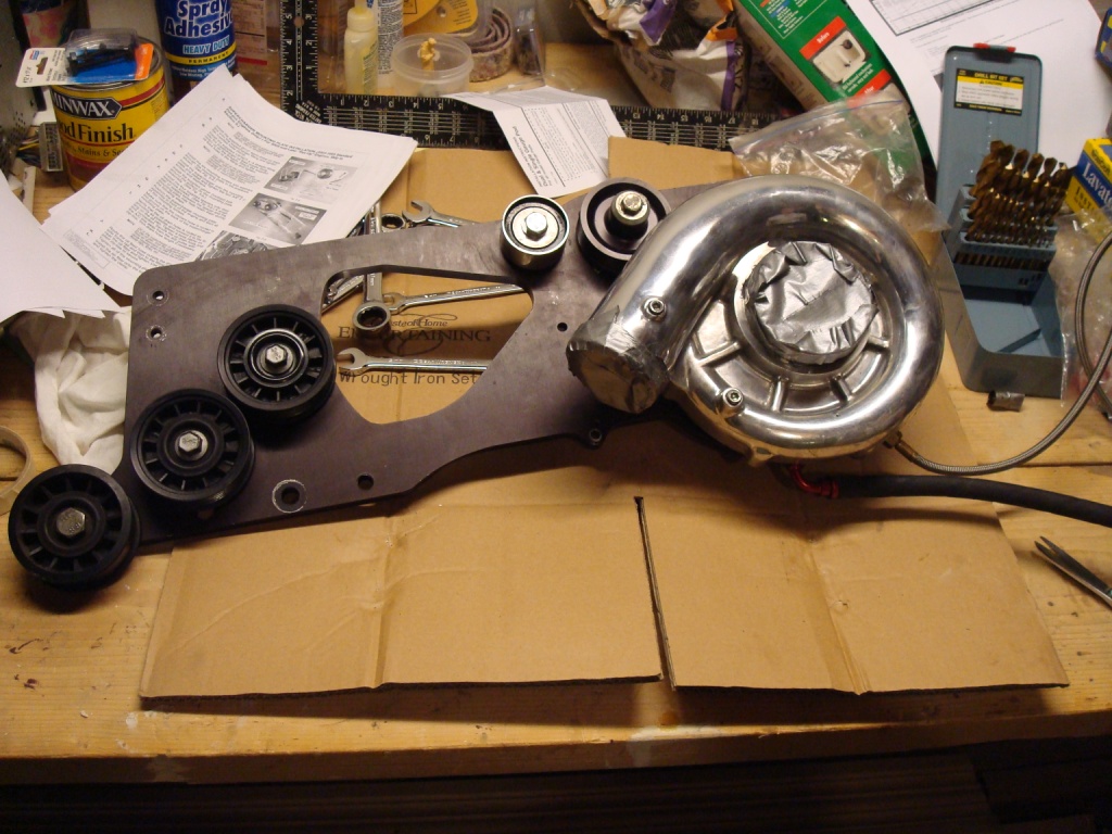

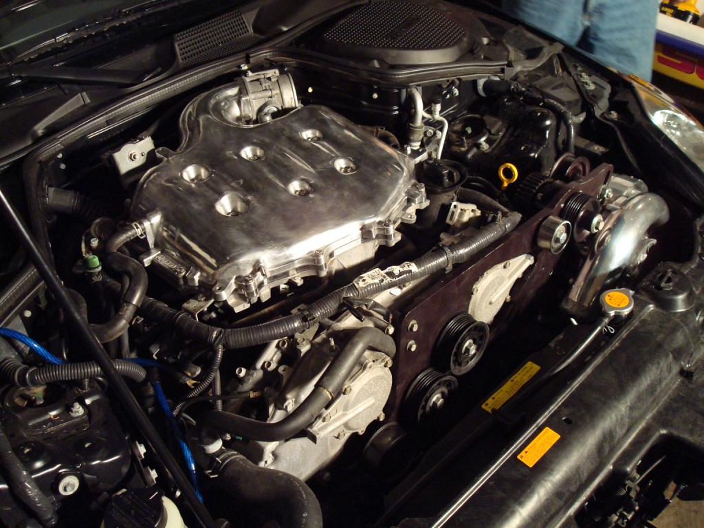

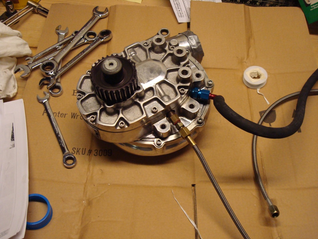

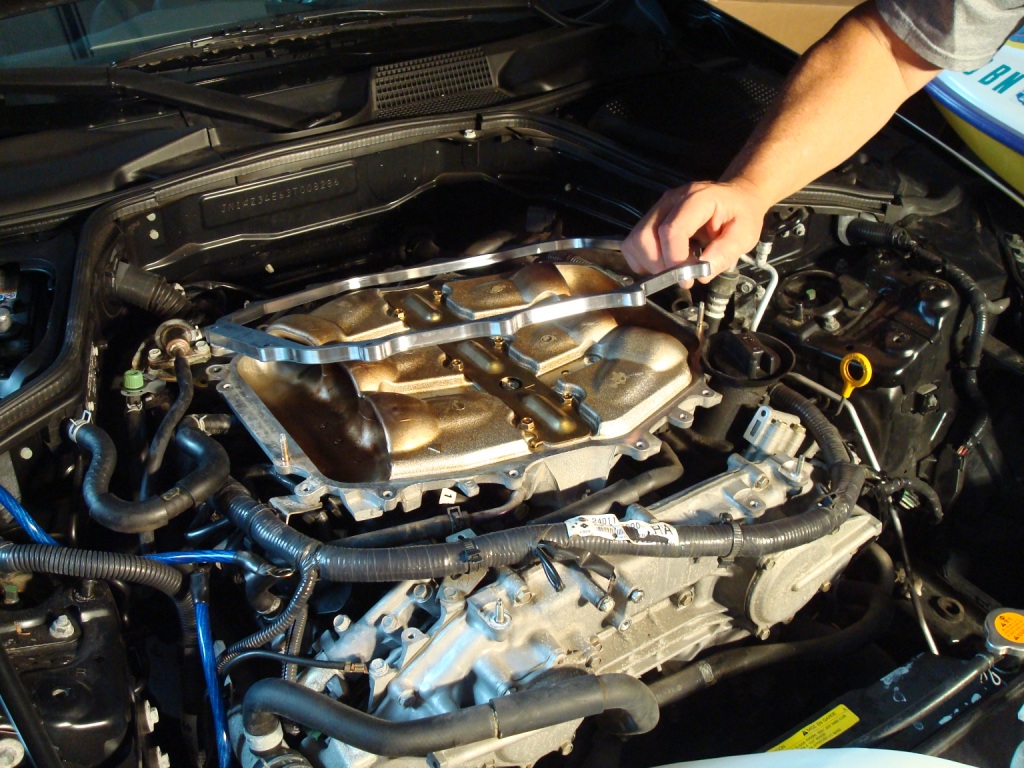

Default I then installed a spacer from Powerlab and started to work on the Supercharger prep.
This spacer looks like a very nice piece.
Attached Thumbnails My 10 Day Build-powerlab-spacer.jpg   My 10 Day Build-supercharger-oil-lines-installed.jpg   My 10 Day Build-supercharger-onbracket.jpg   My 10 Day Build-supercharger-mounted.jpg

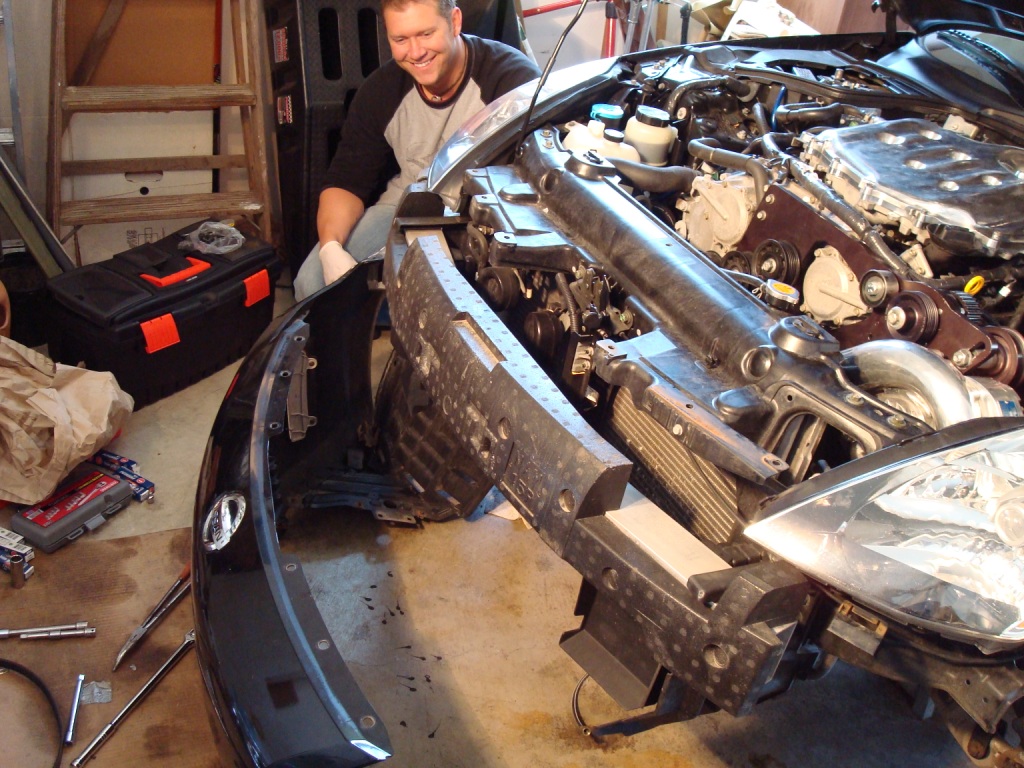

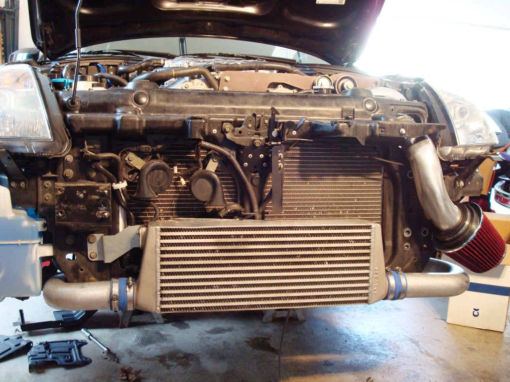

Default Time for the Intercooler and Pipes.

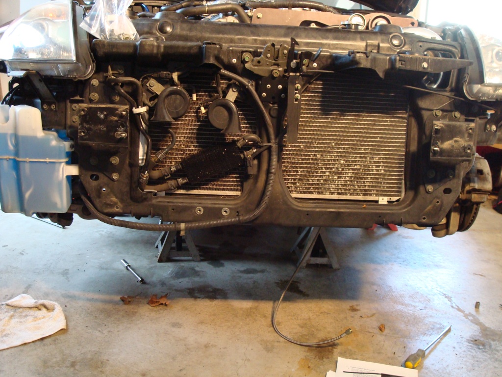

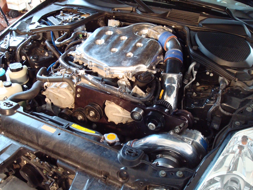

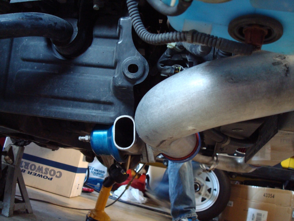

My friend Mike helped me out too. I moved the power steering cooler and just zip tied it. Everything seemed to go together very easy.
Attached Thumbnails My 10 Day Build-bumper-finally-off-.jpg   My 10 Day Build-powersterring-cooler-moved.jpg   My 10 Day Build-intercooler-and-intake.jpg   My 10 Day Build-pipes-test-fit.jpg   My 10 Day Build-bpv.jpg

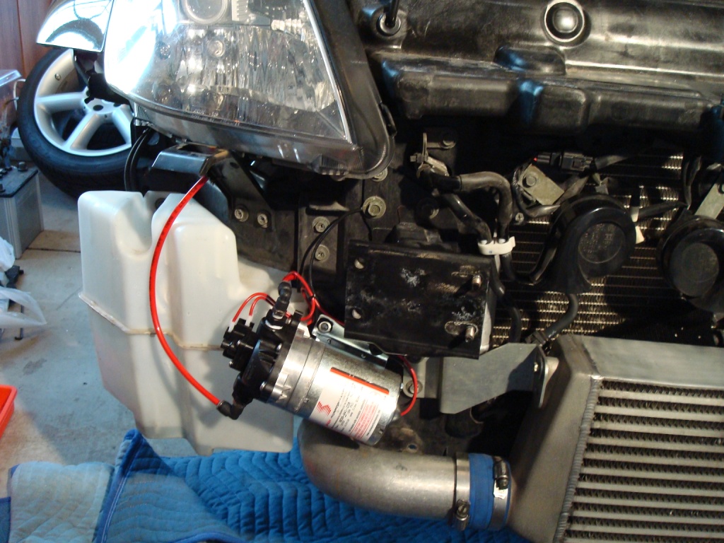

Default Snow Performance Meth Kit Install.

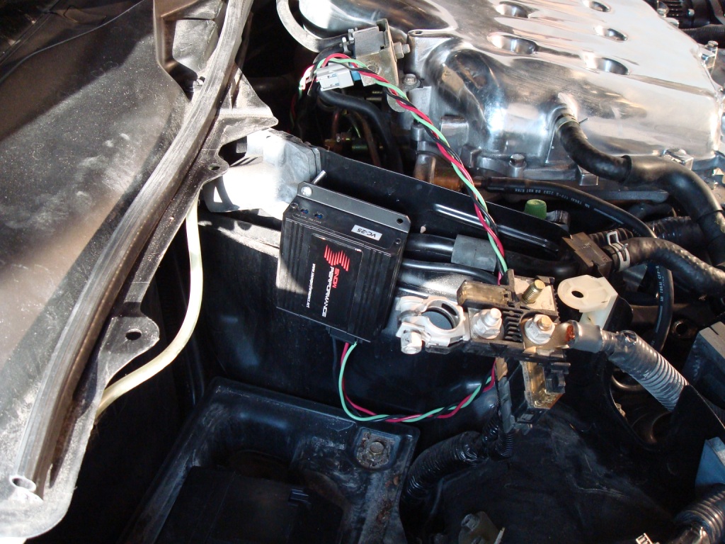

I decided to use my stock reservoir for the added capacity. I am going to use my own mix of washer fluid and methanol mix so I can use it for my windows and meth injection.
Attached Thumbnails My 10 Day Build-stock-washer-fluid-tank-tapped.jpg   My 10 Day Build-snow-performance-controller.jpg   My 10 Day Build-snow-kit-installed.jpg

wow, nice work so far Bryan! keep it up buddy! i love the addition of the cai. superchargers produce a lot of heat, the cold air really will help keep the temps down.

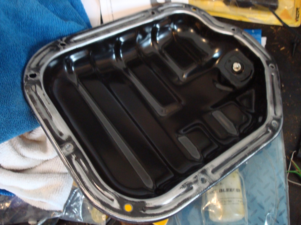

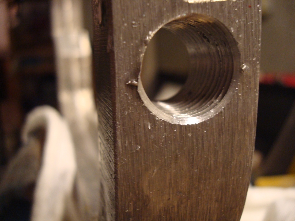

Posts: 1,304
From: Columbus

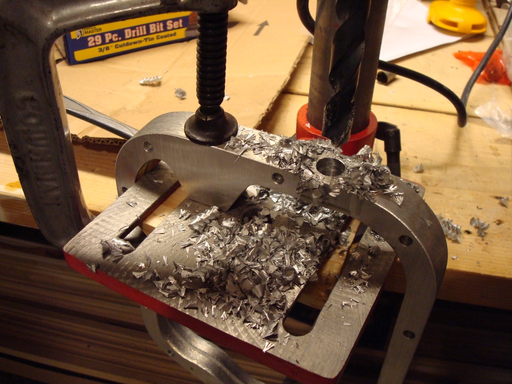

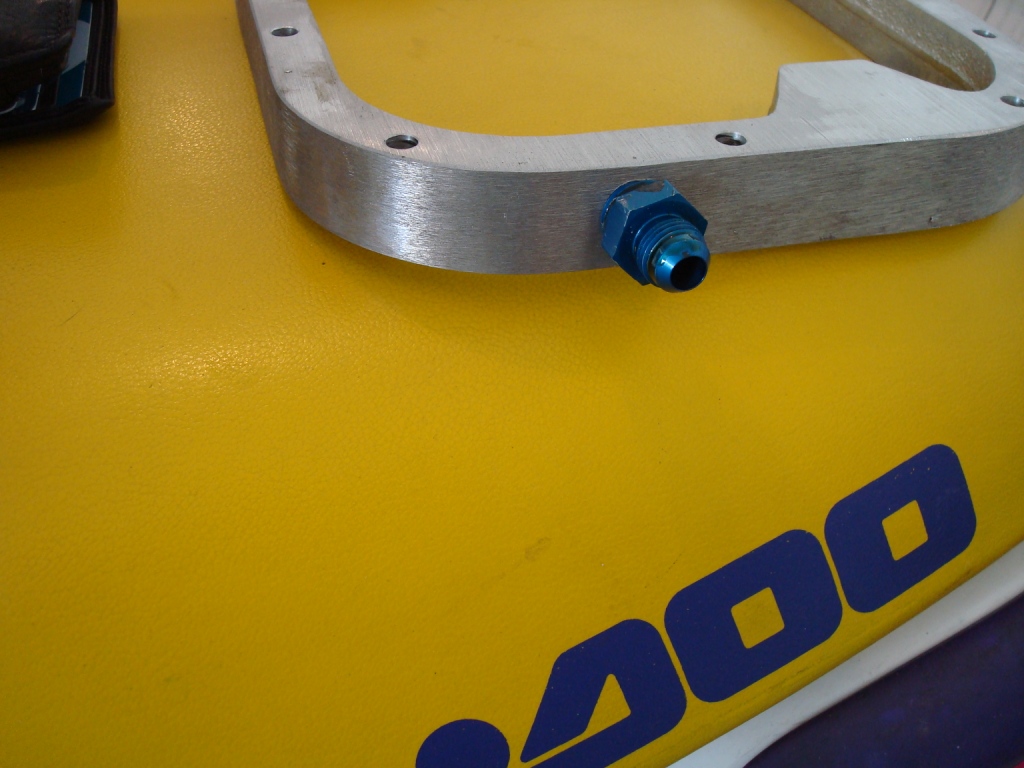

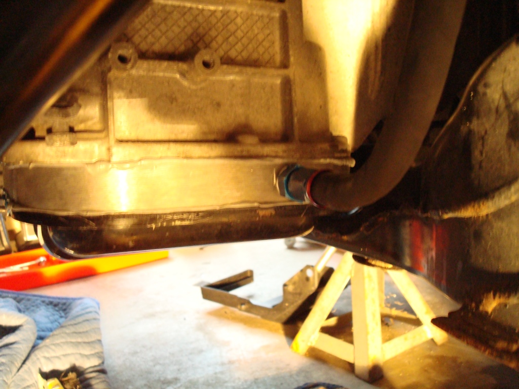

Default Oil return.
Fun Fun Fun....
Attached Thumbnails My 10 Day Build-jwt-spacer-drilled-out.jpg   My 10 Day Build-jwt-tapped.jpg   My 10 Day Build-fits-perfect.jpg   My 10 Day Build-wire-brush-wheel-makes-it-easy.jpg   My 10 Day Build-return-installed.jpg

Nice man! That return line setup is way cleaner than the stock line, i should have went that route. I also wish I had the meth, and the polished kit, and the intake...this makes me sad
