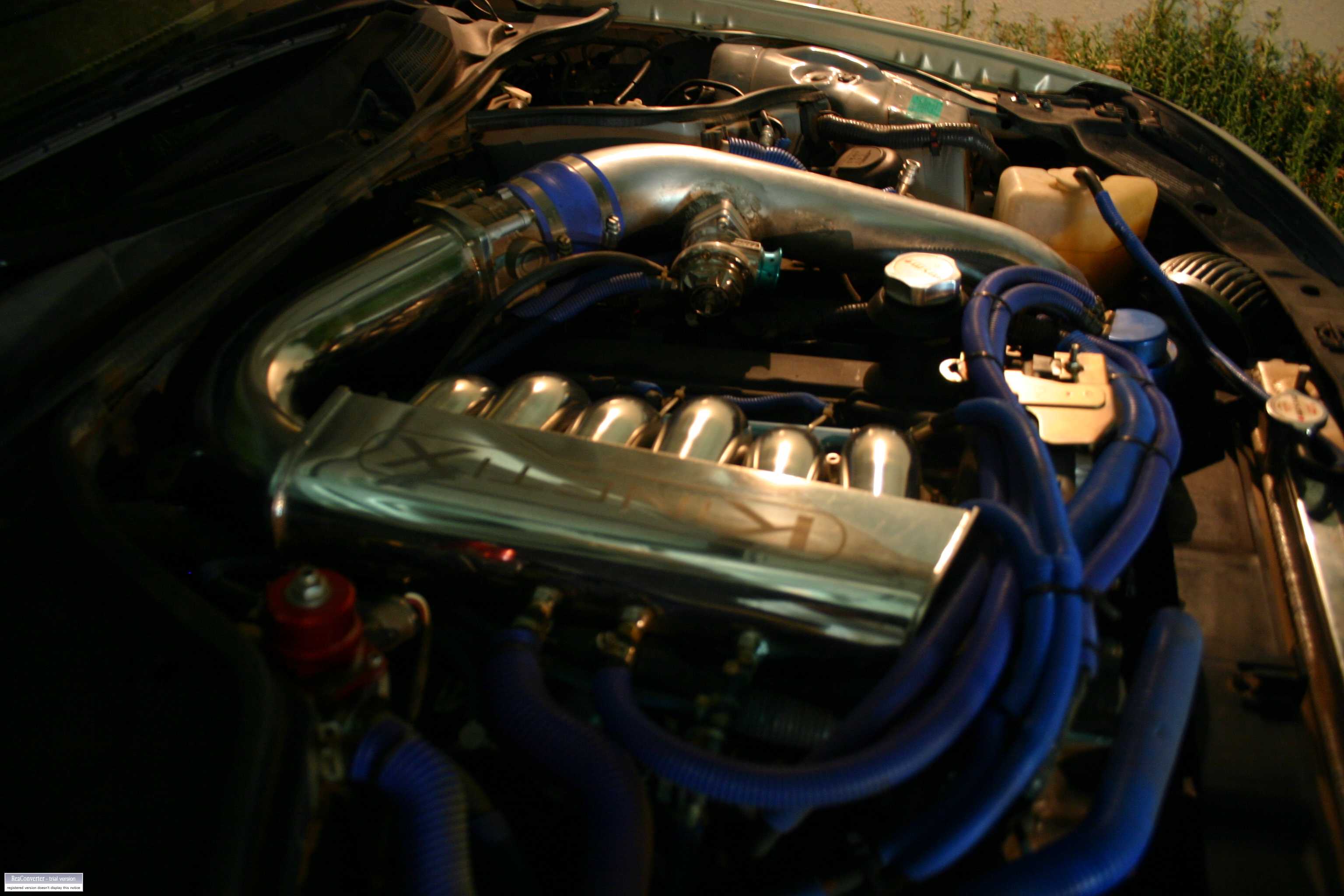

this is my first thread in this forum, i will write some highlights of my modifications that i put in the my car, this project i do it in 6 months, my G35 makes in the Dynojet 644 RWHP in 19 PSI, i will post the dyno sheet soon.
here a list of the modifications for the car:
Engine:
1-Greddy TD05-18G Twin Turbo Kit.
2-Pauter VQ35 Rods.
3-Arias Extreme Duty Turbo Pistons.
4-JWT C2 VQ35 Upgraded Cams.
5-ARP VQ35 Head and Main Stud Kit.
6-Cometic Metal Head Gasket.
7-Ferrea VQ35 Full Valve Train kit.
8-Greddy Type RS Blow Off Valve.
9-Tial Wastegate Springs.
10-Kinetix SS Upper and Lower Plenum.
11-HKS spark plugs two step colder.
12-HKS F-Con pro computer.
13-HKS Navigator.
14-HKS Twin Power DLI II.
15-HKS EVC 6 boost controller.
16-Unorthodox Underdrive Pulley Kit.
17-Greddy EVO TT Catback exhaust.
18-APS 2.5" SS Cat Delete Pipes.
19-Greddy Radiator Air Diversion Panel.
20-Stillen Oil Cooler Kit.
21-Nismo Nissan Radiator Cap.
22-Nismo Nissan oil cap.
23-NISMO Low Temperature Thermostat Kit.
24-Samco Sport Coolant Hoses.
25-Koyo Radiator R Series.
25-AEM air to fuel Gauge.
26-Defi 60mm BF Series (Metric) Amber Boost Gauge.
27-DEFI BF 60mm Fuel Press.
28-DEFI BF 60mm Oil Temp.
29-DEFI BF 60mm Oil Press.
30-Defi Control Unit II.
31-turbo timer.
32-Engine bearings.
33-JWT VQ35 Heavy Duty Valve Springs.
34-Oil Catch tank.
Fuel System:
1-Walbro GSS342 Fuel Pump.
2-RC Engineering Injectors 750cc.
3-CJ Motorsports Return Fuel System.
Suspension:
1-Tein Mono Flex Suspension.
2-Tein EDFC and Motor Kit.
3-Kinetix Racing F Camber & R Camber/Traction PACKAGE.
4-GTSPEC Rear Lateral Arm Brace.
5-GTSPEC Front Lower Tie Brace.
6-GTSPEC Rear Tie Brace.
7-GTSPEC 4 Point Mid Chassis Reinforcement Brace.
8-Hotchkis F&R Sway bars.
Drivetrain:
1-Relplacing Automatic Gear with manual Gear.
2-ATS/Carbonetics Triple Disc Carbon Carbon Clutch.
3-B&M Short Shifter.
Exterior:
1-VeilSide Fortune Wide Body Kit G35 Coupe.
2-APR GT-300 Carbon Fiber Wing G35 Coupe.
3-Carbon Craft Carbon Fiber Mirror Covers G35 Coupe.
4-Nissan JDM "Skyline" Trunk Emblem G35 Coupe.
5-Nissan JDM "350GT" Trunk Emblem G35 Coupe.
6-Zerosun Halogen Fog Lamp Kit G35 Coupe.
7-Black Roof.
8-spoiler kit.
Interior:
1-Nismo GT Titanium Shift ****.
2-Full A-Pillar Triple Gauge Pod G35 Coupe.
Rims , tires and brakes :
1-Volk Racing GTC 20 inch Gold color.
2-Nitto tire Invo (285 for rear and 255 For front).
3-AP Racing 14.25" 6 Piston F Brake Kit.
4-AP Racing 13,4 “ 4 piston R Brake Kit.
Special thanks to:
Kyle at import parts pro (supplier for all the parts except the body kit and Rims).
Han and Darren at intense power (supplier for the body kit and rims).
Hussam at MC performance the tuner and programmer for the car.
Attachment 204024
Attachment 204025

Originally Posted by Alberto
Race gas?
Nice numbers, and build. What do you do at lower boost levels?
at 12 psi 520 WHP, in 19 psi the fuel setup is half regular fuel 95 octane with C16 for the other half of the tank.

Nice ride...you mentioned you went from automatic to manual? Just curious how much that cost and how much work was involved.
i bought 350z manual gear brand new from the dealer, i got it for a very good price around $1500, the other parts like the pump, the ECU for manual gear around $1000, the work was going smoothly except the cluth pedal set, i used in the bigining barke pedal set which was very hard and heavy, then i ordered 350z clutch pedal set from the dealer, after i install the 350z clutch pedal set it's now perfect.....
