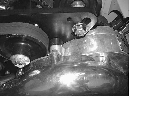

I found this pic on the installation manual.
So I guess the black spacer has been correctly installed by my shop.
Back to the start again then, I'm gonna cry!

Originally Posted by Xendric
This serpentine pulley was replaced when I got the right parts the second time around, and it was already placed on the revup mounting plate. I haven't measure it, tbh, but it should be the right one, as it came preinstalled on the revup plate.
Also, it's not the pulley that hits on the intake of the blower if I remove the black spacer, but rather the bolt that holds it in place on the plate.
So, 3.12 or 3.33, the center should be sitting on the same place, right?
After looking around on here I saw a revup kit with that spacer in place, so my other theory is out. Let me do some more research and I'm sure we can figure this out.
