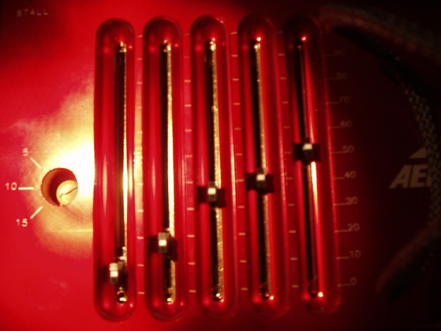

So i dropped my car off this morning at Motorsport Dynamics......i went in with about 300 rwhp(due to running seriously rich)......and i came out with a solid 340rwhp proven on the dyno.....i blew an intercooler hose clamp, or i would have hit 350........i'm supposed to take it back when its fixed and they'll finish up the last slider's adjustment, if it needs any at all
I gotta tell ya......if you have a Z that needs tuning in Norcal, this guy is the shizzle......this guy Henry is so educational to listen to that even my girlfriend was in stitches while he explained what they had been doing with my car, and how the FMU works, and it's strengths and weaknesses, etc.........i left there realizing that i had taken my car to the right guy
Here's a pic of my FMU final settings for the curious........but don't use these on your car!!!!....they only work on mine:

I know that parallax view looks like the scale setting is on 15, but it's actually on 13.......and of course, when i got home tonight i broke out the tools and a flashlight and fixed that intercooler hose clamp already.........i can't wait to go back to that place.......i learned soooooo much just talking to this guy for half an hour!!!!.....no one will ever tune my cars except Henry and Ed at Motorsport Dynamics

Don't push your boost until it's finished being tuned. I can't understand why you'd blow an intercooler hose. You might want to look at all of your hoses and verify that they are all supertight before you take it back in there. Otherwise they'll be tuning a leaking system.

Electrik, do any of the lights on your EFMU come on to notify you that additional fuel is being supplied? Not a single one come on in my car...let me know.

Yes lights should definitely come on when you are on boost. If no lights come on when you are on boost then you have a serious problem. If you're not on boost you won't get any lights. I've posted before, maybe you missed it, but there's an easy way to test your FMU. Disconnect the rubber hose that has clamps on it from your plenum. Blow into that hose. Have someone watching your FMU as you blow into it. You should be able to blow into it hard enought to get at least the third light to light up. If you hear any air leaking you need to isolate the leak. If not lights light up you might have a crimped boost sense line or power problems on your ECU. Also as the lights light up you should hear your Aux fuel pump kick in. If any of these things don't occur, you need to fix the problem before you run your engine again.

Dan......i couldn't see any lights come on as i drove around........but under boost on the dyno, the lights came on for my tuner
This FMU is tricky to tune........and if your car's totally heated up, you might not see boost until 4K in some cases.
My tuner advised me to get new fuel management as soon as it's available, which might not be for a while.......there are some downsides to this FMU due to it's design.
each slider represents a range of boost, although there is only one fuel setting possible for each slider.......as such, it will be rich when boost actuates a given slider, but it will have leaned out when it gets to the end of that range.......so a linear boost/fuel graph is impossible.
another interesting thing about this FMU is that it tries to smooth the transition between sliders by momentarily flickering back and forth between the two.
after all was said and done, my air/fuel was set in the range of 11:1-12.5:1, depending on where the FMU is looking at that particular time.

I don't care if your car is overheating. If you're running your engine at WOT above 2500 RPM you should see lights come on. Now yes, just cruising around and not opening her up you're engine isn't seeing boost because the throttle plate isn't allowing enough air to go pass through to overcome intake vacuum.
Bottom line, if you're on boost, your FMU better know it and respond by lighting up the appropriate slider LED.

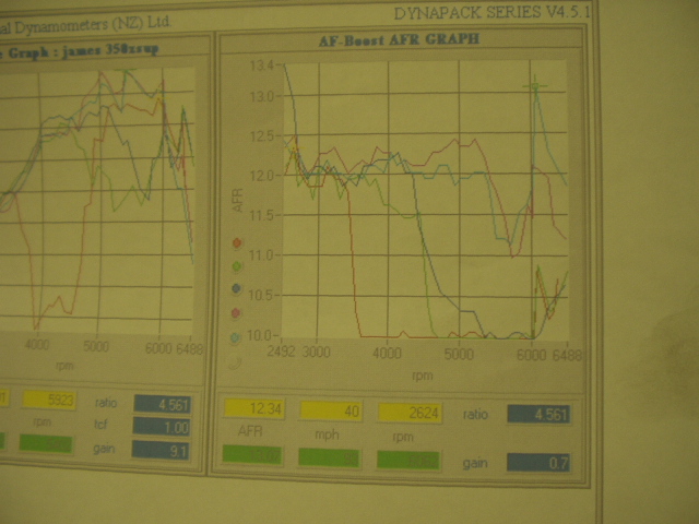

Hmm, I'm having a thought here right now, but can't say what it is. Does anyone have their A/F sheets off their dyno session?

yeah, i have mine at home
Old Sep 10, 2003 | 02:02 PM
ravaz's Avatar
ravaz
Posts: 919
From: Raleigh, NC
OK, if you dont mind later, I want to ask you a question about yours, I will scan mine and compare.
Old Sep 10, 2003 | 02:06 PM
elektrik_juggernaut's Avatar
elektrik_juggernaut
Posts: 1,962
okay....i'll take a pic of mine

EJ: My FMU looks almost exactly like yours. Mine is set at 13 like yours and the sliders are very close to where yours are.

here's my AF readings ravaz.....i hope they help.......but they're a little screwy because of that intercooler hose clamp

I just picked up my car yesterday from Altered Atmosphere. It is running amazing, even though i told them to tune on the rich side since i run in events almost weekly. (the muffler has like twice the carbon in it than it used to last week) But it still pulled a nice 357rwhp with that rich of a tune. My sliders are similar to the picture but my 3-4 are closer together. Ill have to take a pic of it.
