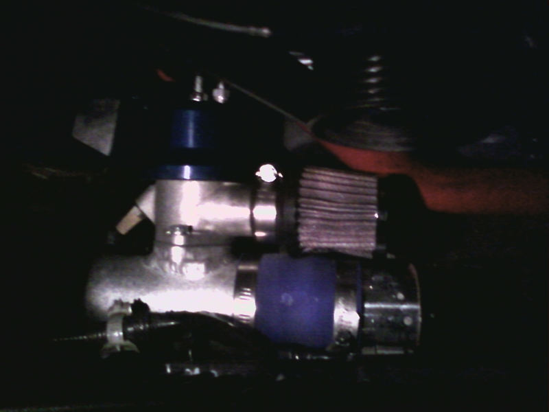

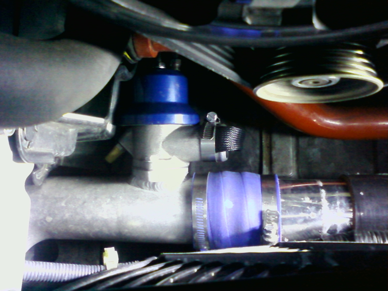

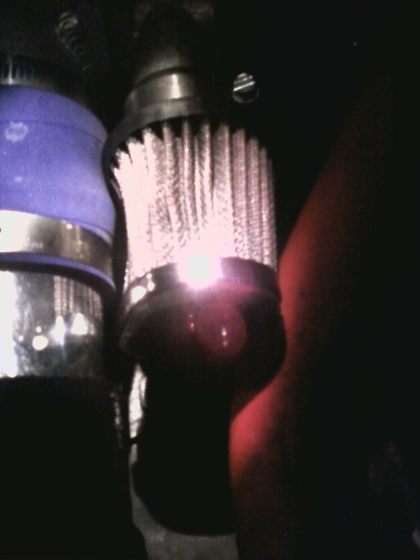

my filter came in today and i just got done putting it on the BPV. the fit is really tight between the coupler on the charge piping and my sway bar (see pix below). was this a tight fit for anyone else?

if u faced it the other way, it prolly wouldnt bunch like that. no problem with it like that though.

no mine is not that tight between the sway bar but did it work for u? is the whistle still there? if there is no compressor surge then ur good to go, but im betting it didnt change anything..sorry if my spelling is off im pretty drunk..lol

+1 face the other way and u will plenty of room.

thanks for the replies guys. i took the car for a spin with the filter on and didn't hear any noises. got into boost a few times and didn't hear any surge or flutter. we'll see if its a long term solution - the whistle is fickle and may very well show up again. also, FWIW, the piece of fabric i used as a temp solution performed great all week with no noises or whistles whatsoever.
anyway, i'm a little concerned about the filter getting beat to hell by the sway bar under load so i'll spin the valve around on saturday when i have access to a friend's pit. it looks like turning the valve around will require me to remove the little panel that separates the engine bay from the bottom of the wheel well. not a big deal...all comes down to what I can live with
thanks again for the replies folks, i'll keep you posted with any new developments.

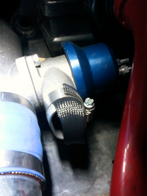

my bpv faces the wheel and my filter is not bunched, i cut out some of the plastic for the wheel well with a dremel...what did that peice of fabric or whatever u used look like?
Old Dec 18, 2009 | 09:32 AM
- bigc -'s Avatar
- bigc -
Posts: 1,014
Likes: 6
i'll snap a pic in a few mins...bout to head down to the garage.

when i flipped my bpv over i didn't have to remove any fender well plastic. Just remove the under car deflector (that i keep removed all the time since i'm OCD about checking everything). It gave me plenty of access and took all of 5 minutes to switch around.

+1 when i looked at it again today in better light, i can see that i'll just have to remove one piece of plastic to get the bpv to face the other way. the filter may touch the wheel well liner, but it shouldn't be a big deal.

yeah thats about what i was gonna do with ur first mod there to keep it quiet...same as mine if i divert the air a little it doesnt whistle...what is that fabric u used?
as far as flipping it around no i didnt need to cut anything then but with the filter on i had to do a little trimming..nothing big and allows me to check everything over easily now..i too have ocd and get under my car all the time just to look things over...

the fabric is just a used piece of tech flex i had lying around after my wire tuck. you can get it at most electronic stores, but honestly, a piece of an old sock would do just as well, lol
