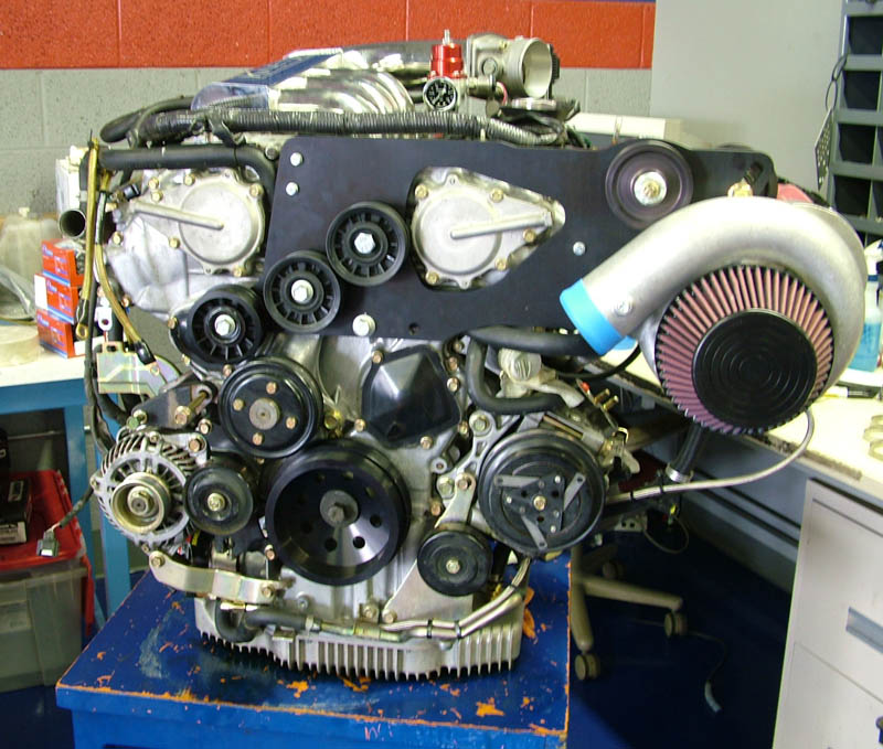

picture attached shows a non-rev. Look at the timing covers (top right and left on engine). non-revs look like that and rev-up look quite a bit different.
