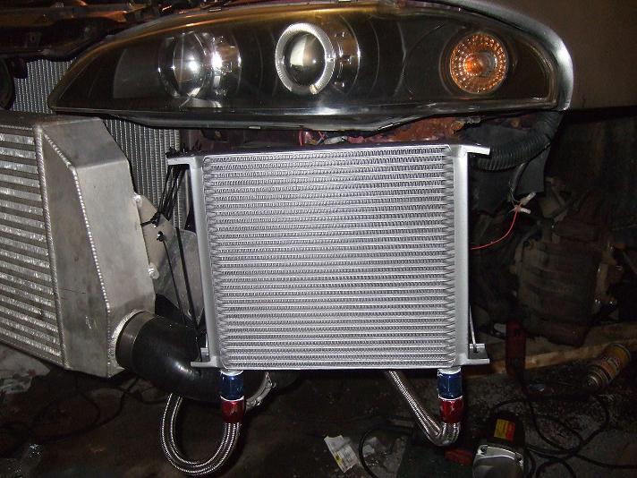

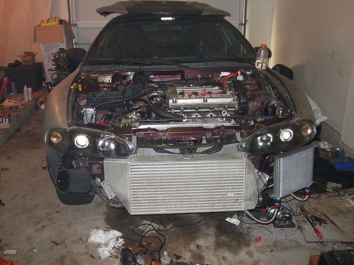

I bought one off of ebay. The core was about 10x10x3 and used -10 an fittings and line. Worked flawlessly. the only thing I had to do was order different -an fittings for the angle that I wanted. Lowered oil temps about 15-20 degrees. Pretty good imho. You will have to experiment with how much extra oil you'll need though depending on the length of the lines. My talon took about 1- 1.5 extra quarts.
