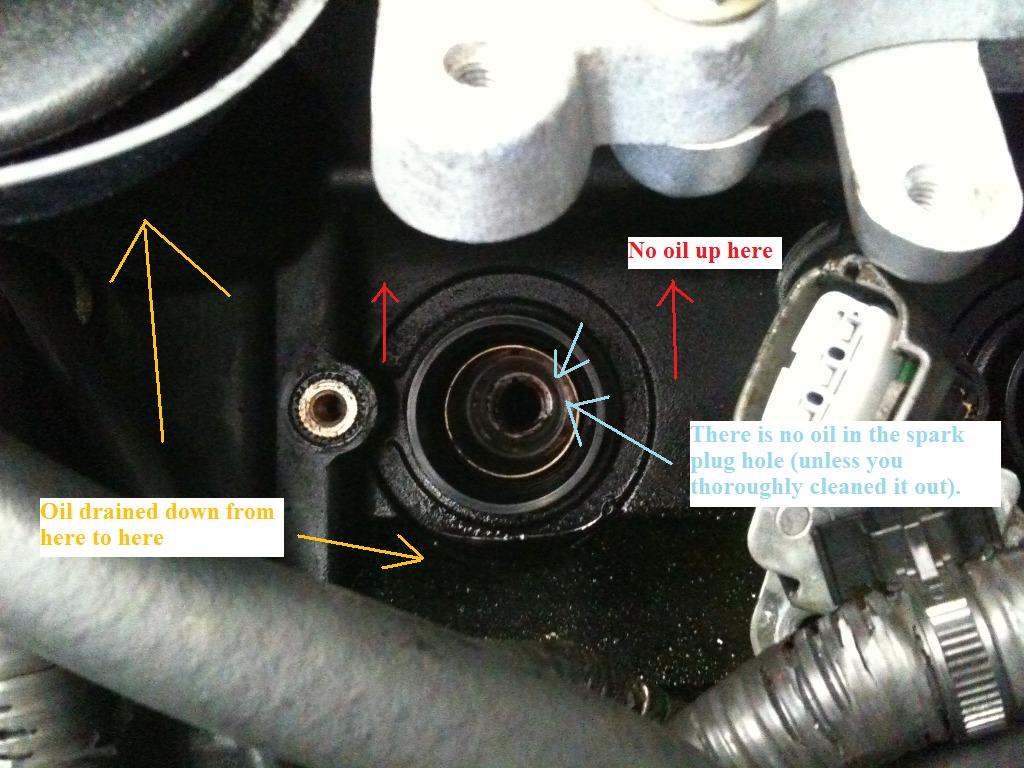

Originally Posted by VG30TTzx
Here are the requested pictures of the supercharger and oil around cylinder 2:
spark plug number 2 you mean, which is directly below the oil fill and exactly where oil goes when it is spilled during filling. clean area well and check at next oil change
We ruled out the rings.
It's great you checked that but it has absolutely nothing to do with oil on the topside of the valvecover. Be at ease that oil doesn't indicate a problem with the cylinders
Upon removing the intake tube with the MAF we saw that two 1/2" wide hoses that were T with a vaccum hose that ran to the PCV were pinched and bent (no pics sorry.) The owner explained that if these vaccums were bent like they were, air pressure was been restricted thus causing a bottle neck effect. This "pressure" shoot out the oil from the oil pan and through making its way to the spark plug holes and oil getting through the seal thus the oil around cylinder #2 and such..
What do yall guys think?
The previous owner is a douchebag. Those are vent hoses. They appear very large so they would have to be pinched a lot to cut off air. Even the pressure would be forced out of other vents (on the other valvecover). Fix the pinches, but again, not the reason for oil on top of the drivers side valvecover. Also, oil won't shoot out of the oil pan up onto the outside of the engine. He's a moron and just making things up to tell you.
was the spark plug hole completely filled will oil? if not then it's probably not the gasket around the spark plug from the valve cover. The oil is on top of your valve cover which means it has to have come from ABOVE that area. Your valvecover gasket would be below where that oil is. It would drip down and not up. Always remember that when looking for an oil leak it would start from the highest point and go down.
I also made some notes on these pictures to show you. The picture shows no oil in the spark plug chamber therefore that seal around there couldn't be leaking.
also, the oil is ABOVE the valve cover gasket (not seen in picture) therefore oil didn't leak from the valvecover gasket then travel upwards onto the top of the valvecover. I would bet money that it came from spilling the oil and it slowly running down the fill neck. Make sure you take the fill cap off and THOROUGHLY clean the rubber around the fill area. That traps oil in there and it can leave residue on the valvecover gasket for a long time.
Also, in the front picture of the supercharger. That bolt i circled i'm almost certain should have a locking nut on it so the tensioner doesn't loosen up.
Attached Thumbnails SuperCharged 350z oil leak!-img_0224.jpg   SuperCharged 350z oil leak!-img_0234.jpg
There wasn't any oil inside the spark plug holes (2, 4, 6,) seems that you're correct and it was a simple oil spill. I took the my Z to 2 Z club-sponsor shops in Austin and San Antonio TX and both came with the same logic of oil leaking from the covers or shooting out the oil dipstick. The best thing they told me was to power wash it and see where the leak was coming from.
Someone mention if I had any pics of the blower, well it seems there's little oil inside the intake tube including the MAF:

The Z just came from the shop and with good/bad news. The good news is that the engine performed excellent on a leakdown and compression test. It turns out that the A/F sensor was bad and was stuck reading 14.5 all the time. There wasn't anything out of the ordinary except the oil that I mention on the pictures on the intake tube.
The bad news is that the oil was coming from the supercharger and also seemed that air was leaking from the top screw/dipstick. In this case the seals on the supercharger are not in great shape and thus causing oil/air leakage. I will be contacting ProCharger and see if theres any warranty left on the C2 ProCharger. Does anyone know if they have a 100k/3yr warranty on their SCs?

The oil that is hitting the MAF sensor is coming from the pcv valves and not from the supercharger, the oil color is brownish, the oil on the supercharger is green/blueish. I called ProCharger and they told me the turnaround for the SC was going to be 5-6 weeks! For now I will be driving her til spring break then I will have time to remove it and use another car til I get the SC back...
I will be installing a oil catch can and trapped all the oil there.
