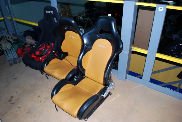

Hey Rotors350, what type of seat do you have in there?
BRIDE Vorga Japanese Edition
Dave actually had it so I could retain the OEM heating units for the seats. I was ready to get rid of the heating option to get the better seats but since I already paid for them why get rid of them if I can keep 'em.

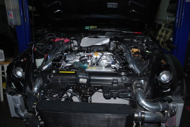

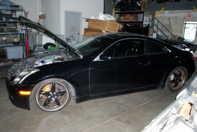

Back to the build...

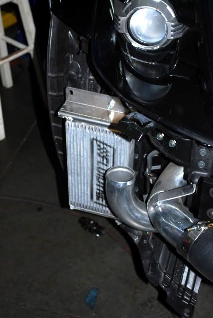

Tranny cooler

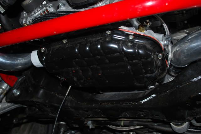

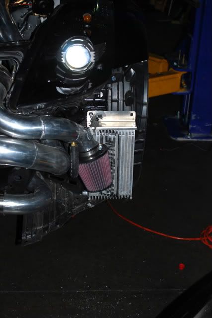

Oil cooler

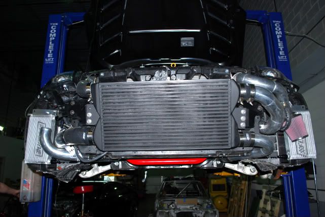

All 3 coolers

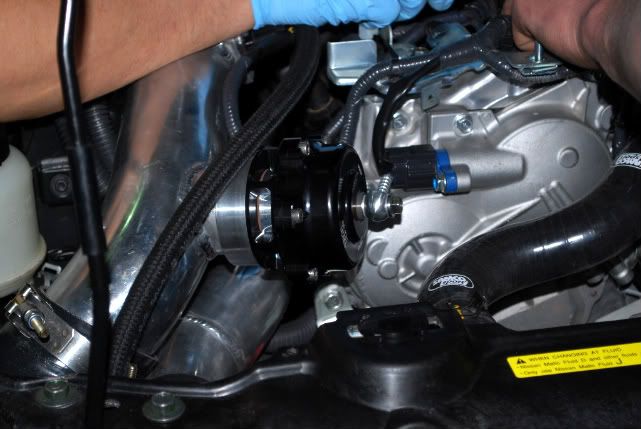

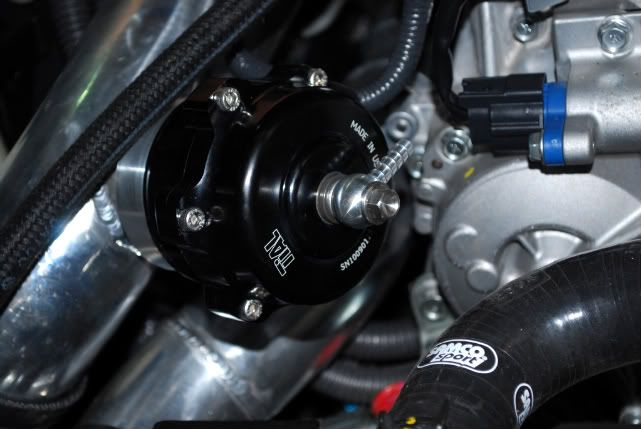

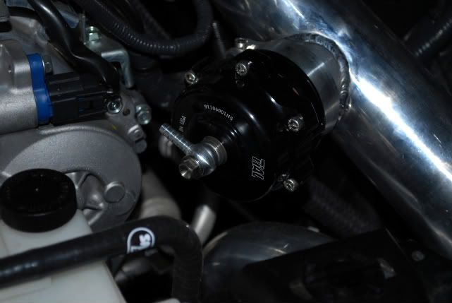

TiAL BOV
Ken and Dave staying busy...

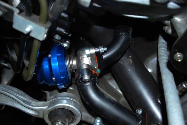

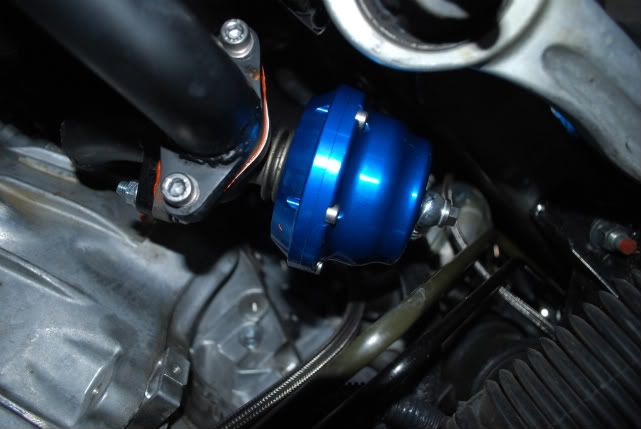

TiAL Wastegates
With all the piping I'm going to not be able to retain the strut bar.

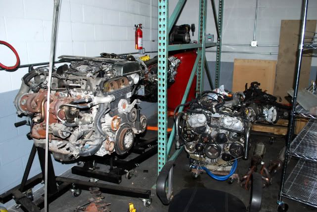

Another beast in the shop getting work done..
This one is set up with Greddy turbos

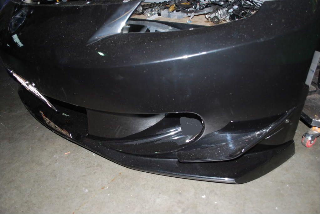

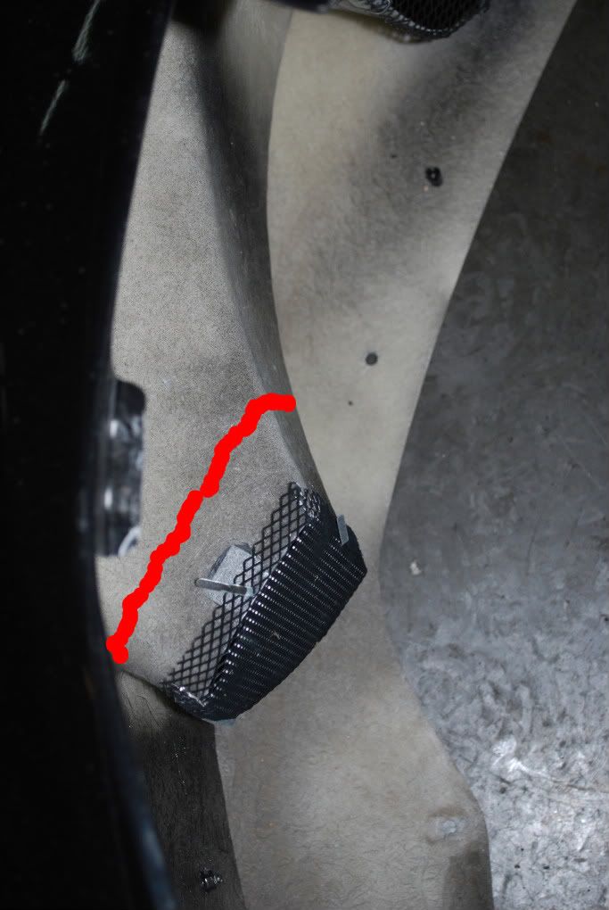

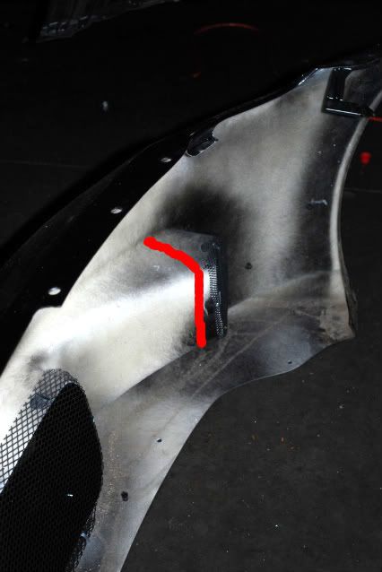

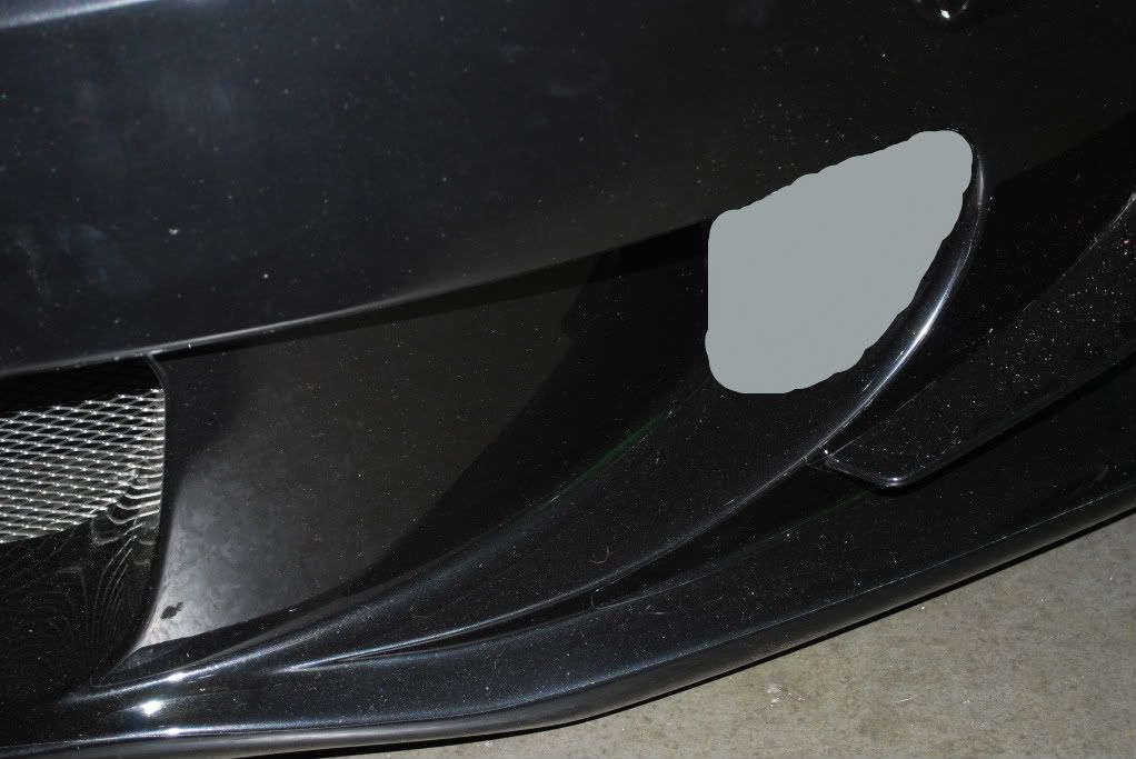

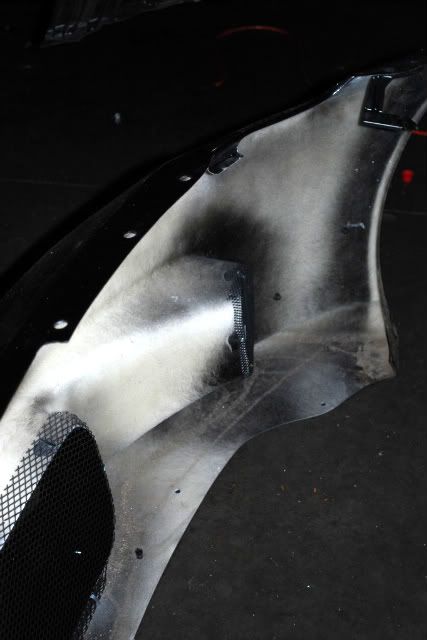

Also with all the piping going on in front my bumper is going to need some minor surgery
These portions are going to need to be amputated
Just trying to imagine what the new face is gonna look like
Nostrils end up flaring a bit, i guess...
Check out the inside!
Bit smudged up but once i clean 'em off it's gonna be suhhhweet!

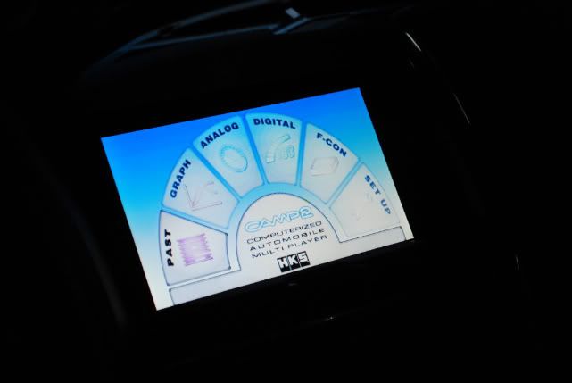

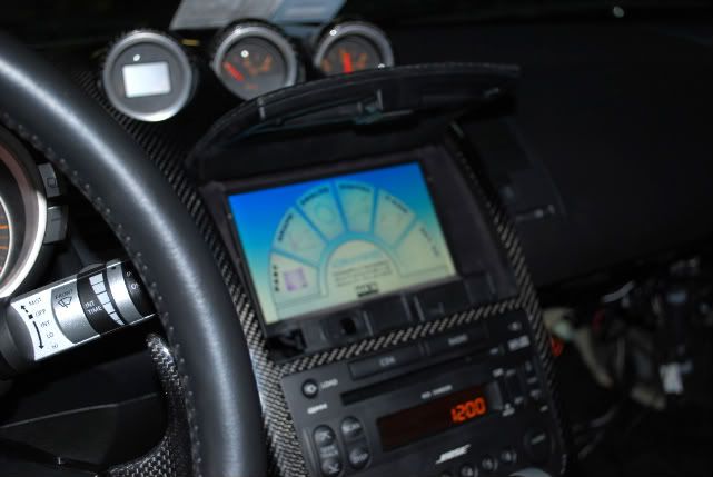

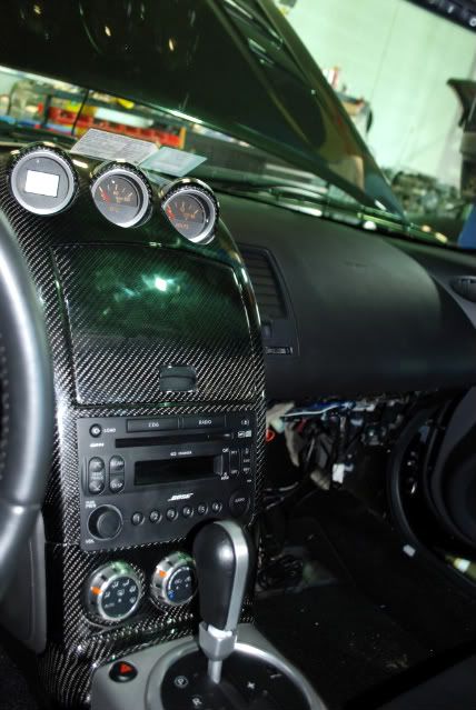

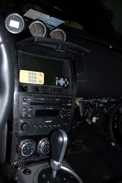

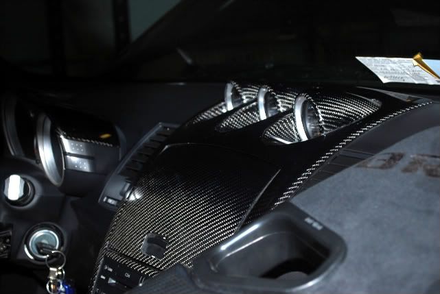

so far it looks to be a great bulid i go one question what screen are you using in your cubby hole do i see a usb port on there would love more pics of the screen setup
Originally Posted by RoTors350Z
Sorry for the late update.
Friday's, the 26th, photos:
Cubby screen for HKS CAMP2
Old Mar 5, 2010 | 05:40 AM
  #49
Driven1's Avatar
Driven1
Professional
Posts: 4,397
From: Virginia
^^It's just a simple Lilliput touch screen 7" monitor. Take the housings of them and you can make them look nearly factory in about anything.

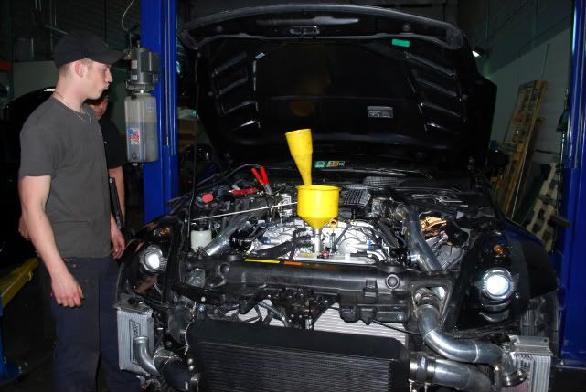

Here's more from my build and Function Tuned....
As I walk in on Friday...

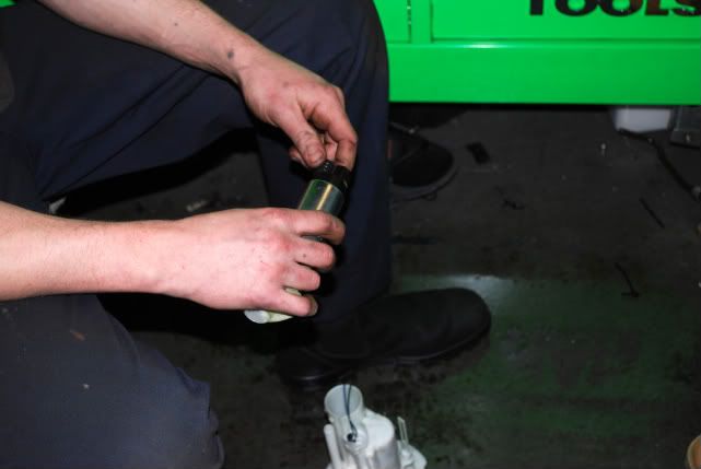

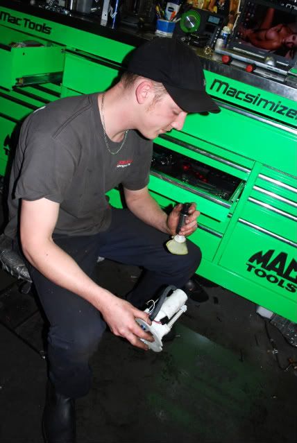

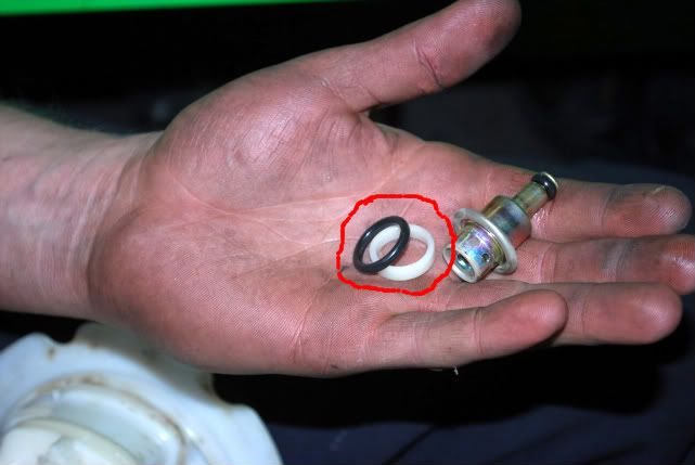

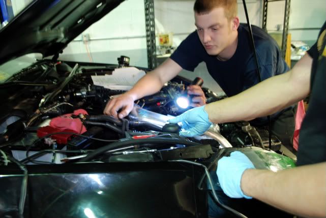

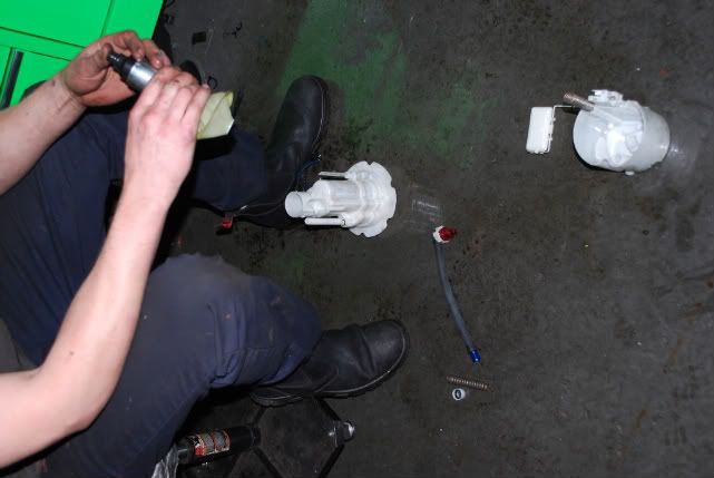

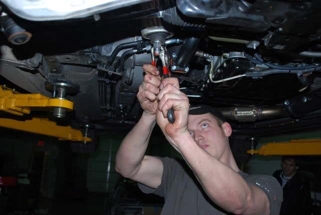

There seems to be a bit of an issue. The Z will not start. No fuel pressure...
Ken starts taking a closer look at the fuel pump..
Hmmmm?
After some cussing and fussing the culprit was found!!!
The fuel pump was put back together without these ^
So while putting everything back together...
took few shots around the shop while Ken was working on getting the Z started...

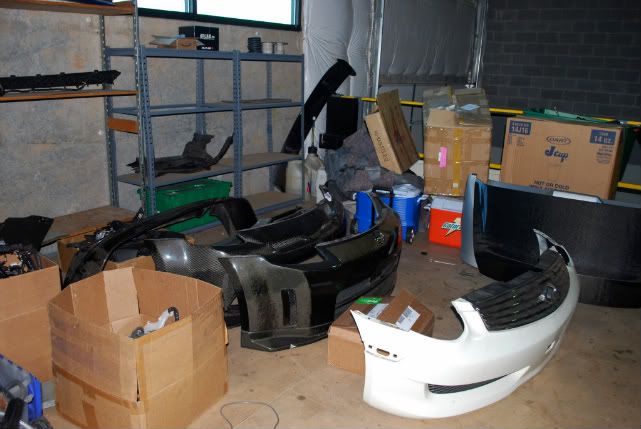

Anyone need another engine^?
Interested in Cobra seats, I believe these are available...
Few bumpers needing a new home..
Here is another set of twins I wouldn't mind getting my hands on ....
Just a few more pics for the CF addicts on the site cough... cough... Jay'z.. cough...
So the moment of truth arrives... Goes to start the car....
My baby starts right up!

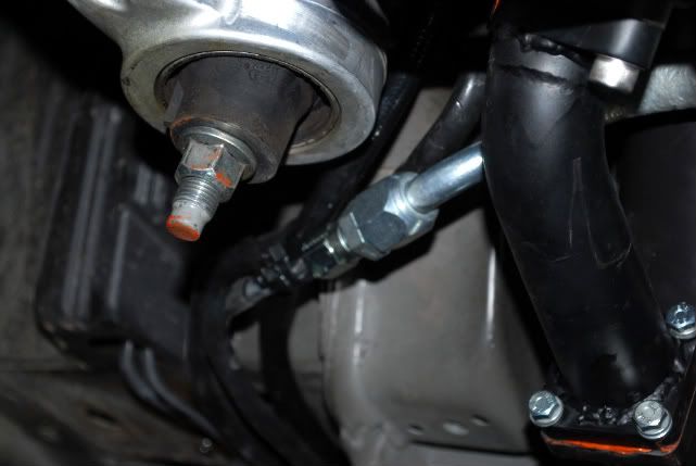

After running for a few we bring the lift up and notice:
... to be continued

^^^^Its called a pressure fitting bud......sometimes....they just aren't perfectly tight the first time.

Awwww.... ROBBIE!!! I was trying to build up the suspense... you know like in cliff hangers and all
I was going to say that she had a Urinary tract infection or something and how doctor Ken saved her
Anyways Robbie spilled the beans and all that was needed was a few more turns of the wrench shown here...
