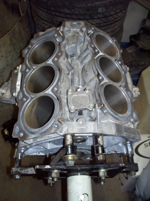

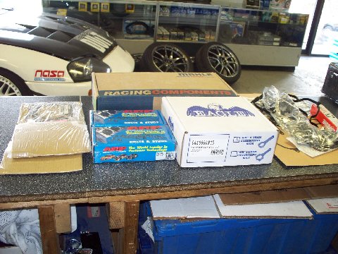

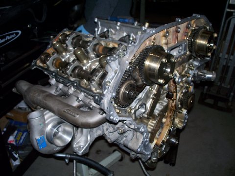

pics
Attached Thumbnails Greddytt Build-securedownloadca6b8rdz.jpg   Greddytt Build-23.jpg   Greddytt Build-securedownloadcak539eq.jpg
