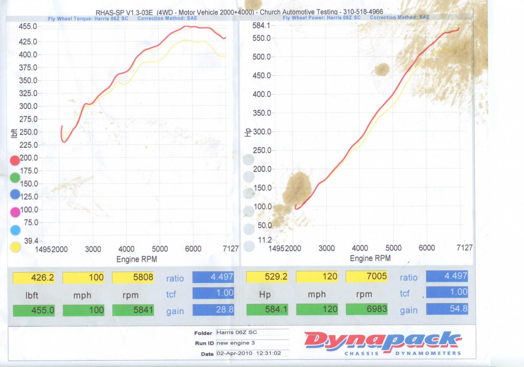

Well...here is my dyno from my initial tune...this tune was done with the following difference in setup:
-OEM Crank Pulley
-2.87 Pulley and 30/34 cog setup
-JIC Y-pipe
At this point I already had the ART pipes...
The yellow dyno info was without Meth....while the red/green dyno info was with Meth...
So...with the addition of the Motordyne XYZ w/ cat and a 2.75 pulley, 30/32 cog and the Fluidampr crank pulley, I got similar numbers as my previous tune with Meth...I still haven't tuned my new setup with Meth, so we'll see how much more I can get...
Originally Posted by jonnylaw
Thank you for the results and video/graphs.
It looks like all testing was done with the smaller pulley and motordyne products--but there was no initial run with your previous exhaust component setups compared to later MD runs?
I am trying to figure out whether the ART pipes and XYZ pipe with HFC will give more power than HFC's and aftermarket y-pipe on a centrifugal SC setup (I have HKS sc). And if so, approx. how much of an increase. I would just like to know if the gain(s) if any would be worth the ~$1300 plus labor and retune to get it done.
Attached Thumbnails Vortech tuned with Motordyne XYZ pipe and ART Pipes...interesting results-tune1.jpg

Thanks for the additional graphs; great numbers btw. I guess there is still no direct dyno comparison b/w standard HFC's w/ aftermarket y-pipe and ART pipes with XYZ pipe w/HFC on a SC setup with no other change in mods....

I do have my older dynos somewhere...however it won't yield any useful info because it was on my stock block with a different blower and different pulley setup...
As for the fluidampr, I didn't install it myself, but my mechanic had no issues...the car definitely feels smoother and less roughness and harmonic vibrations during startup and driving...
