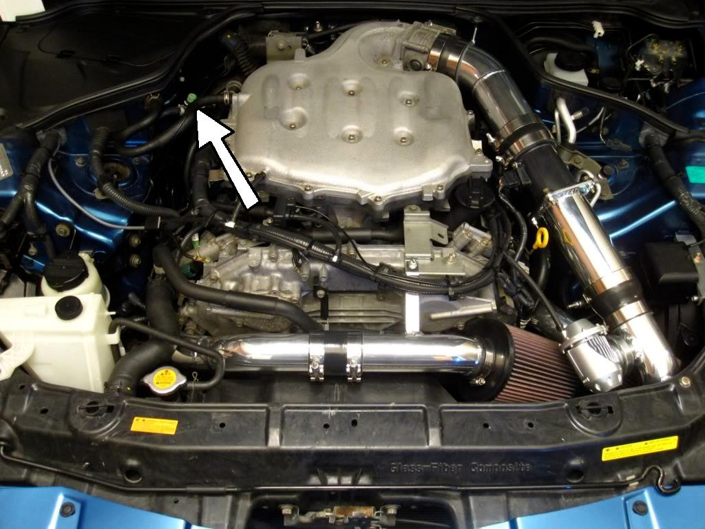

Did you open the green bleed port when you topped off the rad? See picture.
On the APS TT Kit that is removed and a junction is in place for the water line for the turbo.
I still had a rear bleed valve with my kit. OP, I would reccomend trying this bleeder as well if it is still on your car. Otherwise it sounds just like the others have said... you have an air pocket in the system. It also sounds like you have bled it out if the heater is blowing hot air again. Keep an eye on your temps and consider getting an oil cooler just to be safe
Didn't know that. I cut the line and spliced in a tee on mine, hence why I still have the bleed valve. It's handy in these situations!
