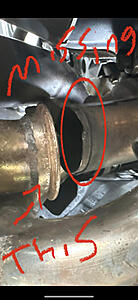

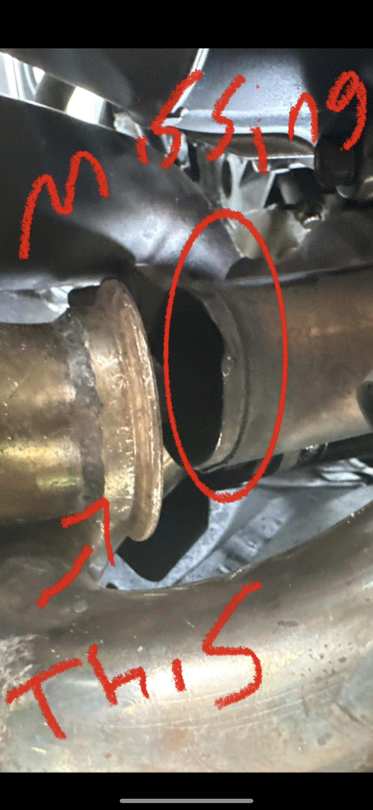

Exclamation Rev9 kit y pipe broken
My car sits low a, so when I got under it to do an inspection I noticed that I have a break on the hot side. Is the pipe replaceable or do I have to get it welded back on? I can’t find the part anywhere. Has anyone else ever had this problem with the rev 9 kit? How did you fix it? This is the infamous Ypipe that’s a pain in the *** to install
Old Jul 10, 2023 | 05:22 AM
iideadeyeii's Avatar
iideadeyeii
Joined: Nov 2011
Posts: 4,029
Likes: 479
From: Lawtown
IDK why you are posting in this thread, but my weld broke in the same spot. except I caught it before it completely fell off. Take it out, clean the collector up and get a new v-band flange. You can see how I opened mine up in my budget turbo thread
