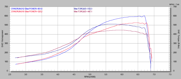

something else to be asked is.....are you running off the WG spring or a boost controller. Mine reacts pretty different when the BC is doing its thing VS just the spring.
Here's mine for example...the blue line is with BC doing its thang, the red is with BC off (don't worry about power numbers, obviously the more boost is more power....but look how much laggier it is with the BC off).

^^^Wouldn't that mean that you back pressure is high as soon as you get in to boost?
If you have to use the BC early on, your back pressure is hight and pushes the w/g open (from the plunger side) before boost reaches spring pressure. Hence having the BC work with the spring (agains back pressure) to keep it closed.
Just my line of thinking.
It is hard to judge though, not knowing what spring is in the w/g and what those boost levels are.

I have no idea lol...I just know for most folks in general, the BC changes the boost curve vs the WG spring

Tom, boost vs rpm would better demonstrate what you are explaining.
A wastegate begins opening BEFORE you reach target boost, otherwise it would overshoot. It is not strictly open or closed, it moves between. With a boost controller targeting much higher boost, you can keep the wastegate CLOSED as it passes the wastegate spring pressure on it's way up to the higher target boost.
