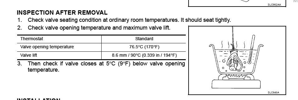

I hate when internet mechanics try to correct someone that actually builds engines. Read the service manual. It starts opening at 170*. Once it's open it doesn't start closing until 161*
Section CO page 23 in the Nissan service manual. I took a screen shot in case you've never read the manual.
Attached Thumbnails Cooling w/ removed heater core-thermostat.jpg

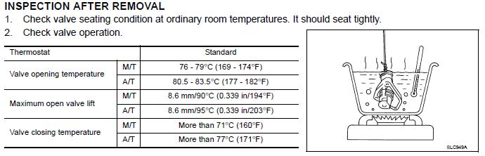

correct. in all fairness, though, the FSM varies by year. the info for the 2005 G35 (my car) is attached.
Attached Thumbnails Cooling w/ removed heater core-stat.jpg
Thank you for your correction and your benevolence.
I apologize for not reading the FSM in its entirety.
that's wild since the thermostats are the same part number between those 2 years and even between a/t and m/t.

that and the fact that thermostats are rated at what temperature they are open, not what temp they start to open. My oil cooler thermostat is a 180* thermostat and it starts to open at 130* due to it's design.
tell me about it! when i looked them up last year on courtesyparts, there was no distinction between 5AT and 6MT, yet the FSM says there's a difference. at the time, i thought maybe that was why some people said their temps never got out of the 190s while others regularly see 205. beats me man

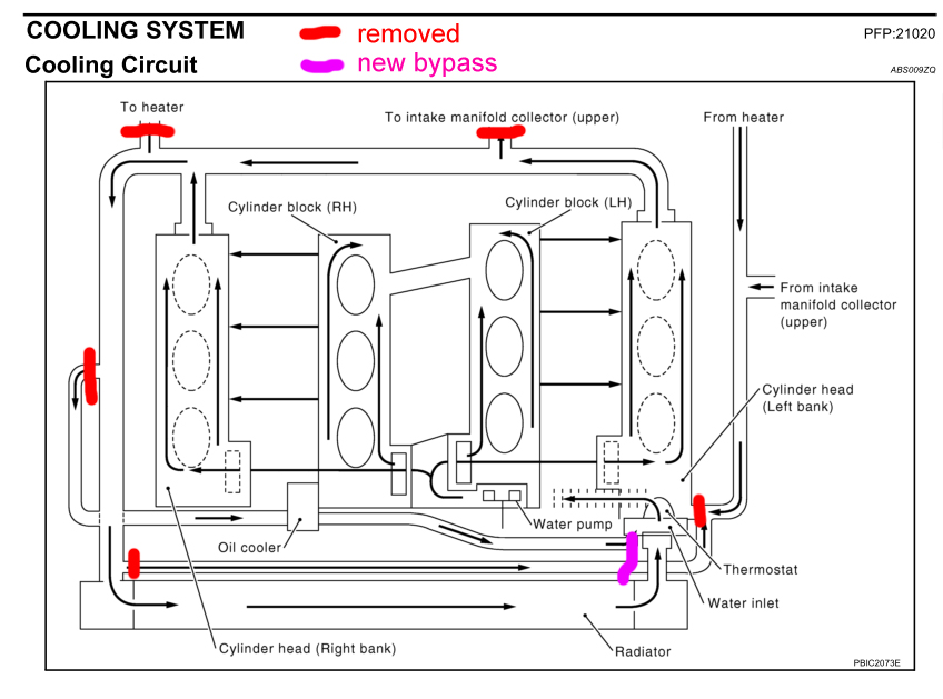

On the coolant pipe on the back of the engine, there was a nipple that I was not using for warming the intake. I went from that nipple to a new nipple that I drilled and tapped and put on the block off plate the previously blocked off the heater/bypass line. The thermo opens now, and at an idle, I'm running about 185-195deg F so Im a happy camper. The line I ran also runs from the back of the engine so I didn't have to do some hideous crossover on the front of the engine. Do you guys typically leave that intake manifold coolant lines alone or remove them?

Here is the cooling flow chart, and why my first setup did not work, and the second what I will be doing to get flow to the rear of the stat.
Spent any pics of what you did?

I'm running from the "to intake manifold collector (upper)" to the left cylinder bank inlet with a 5/16" fuel line I had lying around the fit the nipple on the backside. I'll try and get some pictures up tommorrow.
But, ya, there is no reason your second setup should give you problems. Your first was just feeding in cooler coolant so the thermo probably wasn't opening as fast as it needs to. Are you going put a new fitting on the rear water pipe? It really is convenient to use that intake nipple since you're not using it... I was going to use the "to heater" nipple but the engine is so close to my firewall that the hose was kinking.
