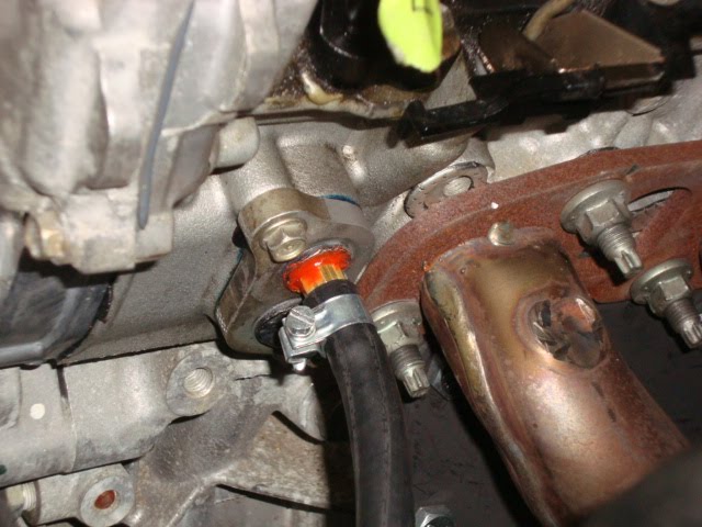

Originally Posted by spent
I'm running from the "to intake manifold collector (upper)" to the left cylinder bank inlet with a 5/16" fuel line I had lying around the fit the nipple on the backside. I'll try and get some pictures up tommorrow.
But, ya, there is no reason your second setup should give you problems. Your first was just feeding in cooler coolant so the thermo probably wasn't opening as fast as it needs to. Are you going put a new fitting on the rear water pipe? It really is convenient to use that intake nipple since you're not using it... I was going to use the "to heater" nipple but the engine is so close to my firewall that the hose was kinking.
The bypass line I created was from the top of the radiator so it was not cooled, which should have been hot enough to open the stat.
I am going to weld a 6an fitting on the rear crossover pipe. and then another on the stock driverside pipe.

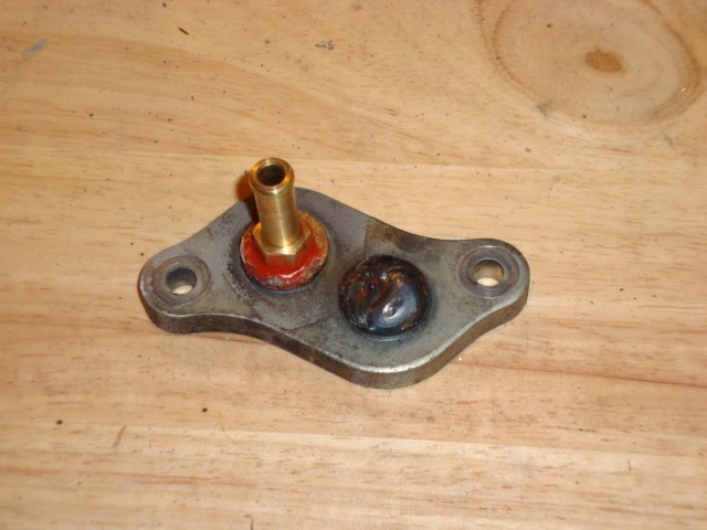

I pulled this plate after I got it all working in order to put a thermo sensor in the other hole... Now my cooling system is having issues again... I think I might do a larger bypass line so the engine is pushing air out quicker. I burped it for hours last night, took it out this morning, and both the intlet and the outlet pipes are warming so I might have fixed it again... dunno.
Here's what I am workin with...

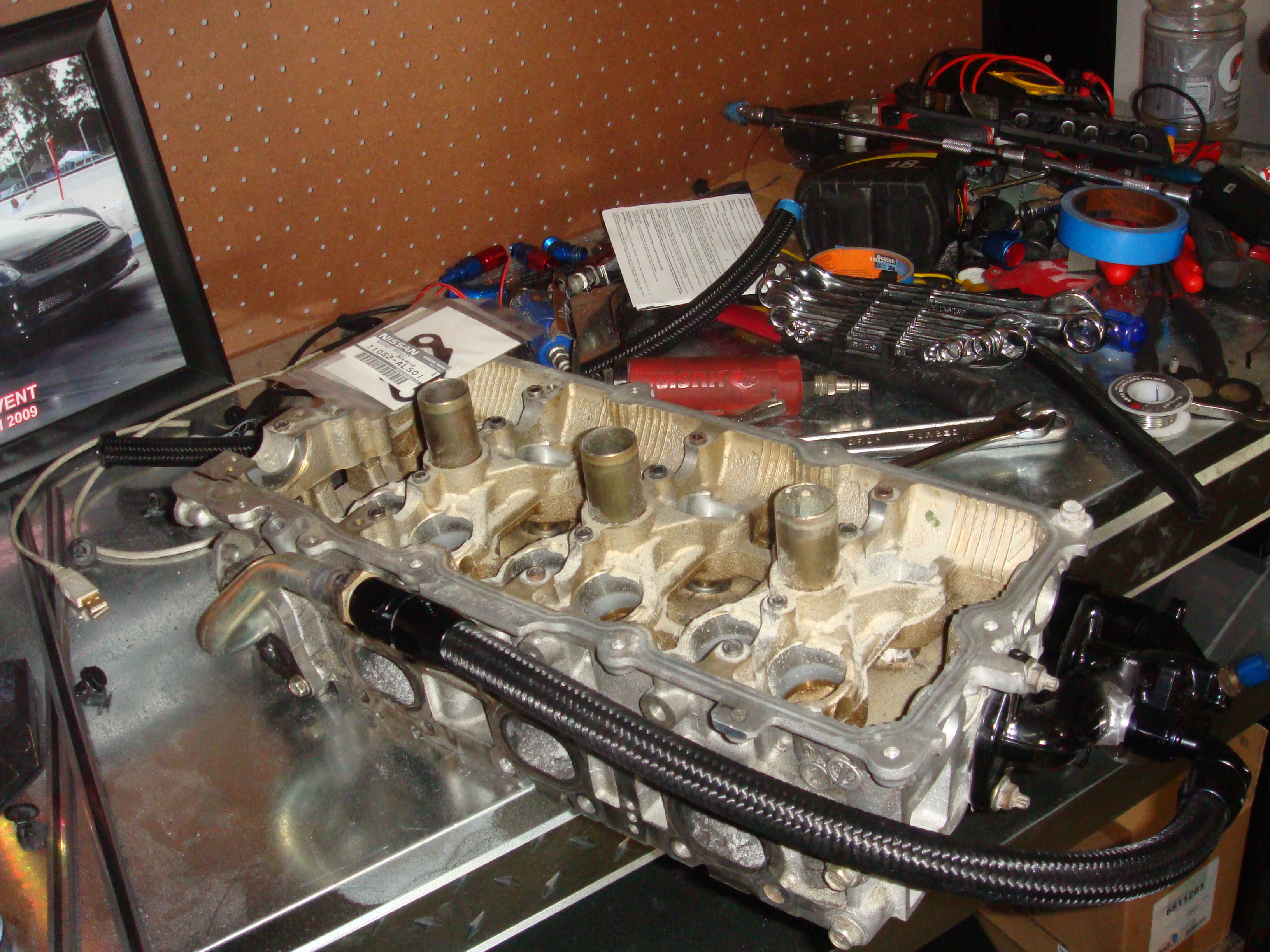

Some work more r&d for the heater delete, and maintaining temp with working t-stat.

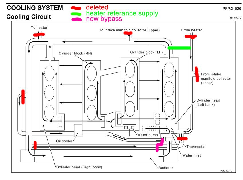

This is what worked for me...
http://i90.photobucket.com/albums/k2...lesolution.jpg
Made new bypass line
http://i90.photobucket.com/albums/k2...y/DSC02962.jpg
Simulated heater loop
http://i90.photobucket.com/albums/k2...y/DSC03127.jpg
