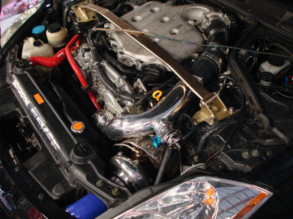

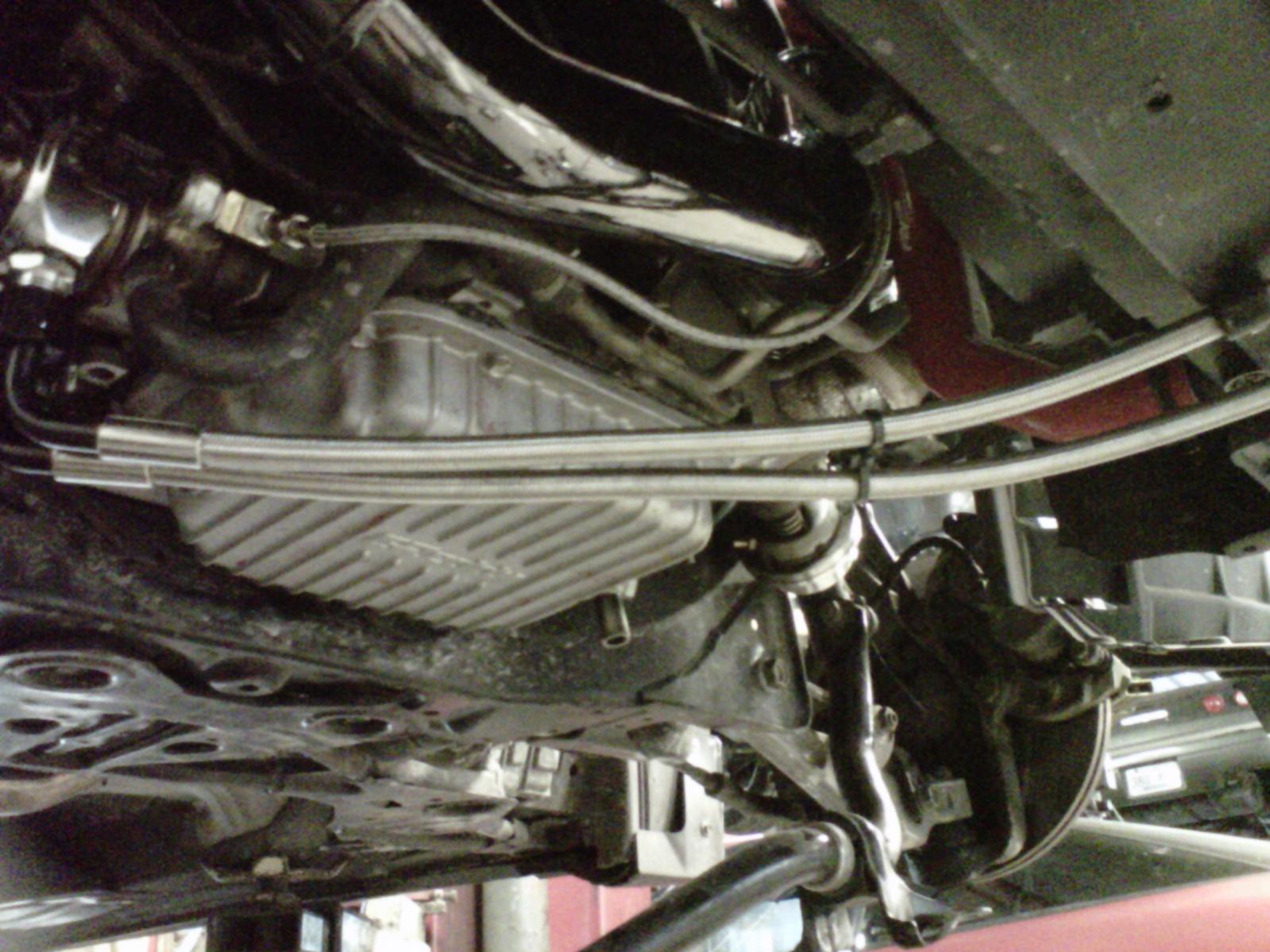

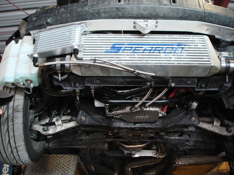

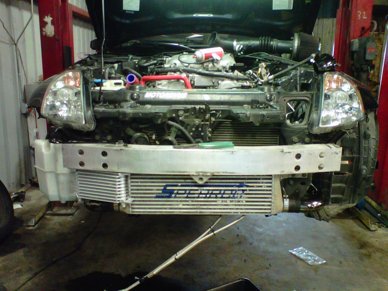

Still waiting for my car to get done, went to the shop today and snapped some pictures of the Oil cooler and intercooler mounted. Works out nice and fits neatly all behind the front bumper. Also theres some pics off my Greddy Oil Pan.
Install also consist of :
TN Kit used for 5k miles.
Custom Oil Cooler
Oil Catch can
Greddy ALUM Oil Pan
440CC Injectors
Turbosmart Blowoff Valve
AEM Wideband
AEM Truboost Controller
Osiris Tune, with daily and aggressive maps.

Looks good. Make sure to post dyno results. You should throw some meth injection in there to keep those Turbonetics temps down a bit.

Yeah, I’m liking the mounting location of the oil cooler. Good luck OP!

personally would never run my cooler lines loose under the car like that. even with the undertray on.
Looks like they might interfere with the sway bar as well.

There tucked up, in that picture they were just kinda hanging there. Hes got them routed beautiful and tucked up.
And no undertray for me, ive been thru 3 already and they always seem to find a way to come off. I just try not to drive in real heavy rain and flooding. Im worried though now because I want the intercooler to get the right amount of airflow, and with the undertray not there im thinking it might not get the full blast of air.
There is air going under the intercooler now with the tray off though.

They have decided to re-route the oil cooler lines. I was there today and they said there just a little to down low still, there going to get new lines with 90 degree fittings coming off the sandwhich plate.
