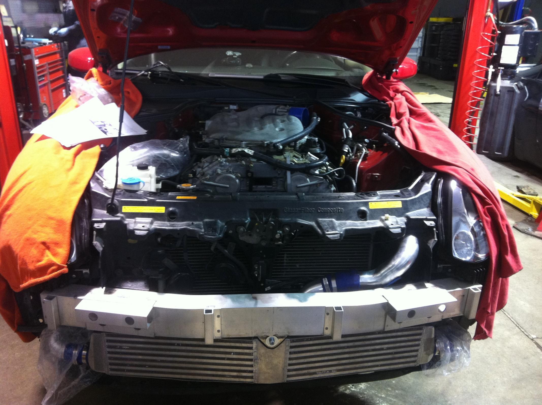

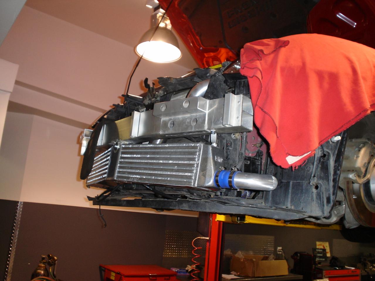

Okay guys... well the build has begun. Sorry it took so long but as I'm sure you're all aware that's how things like this go sometimes.
Well, this is the collection of emails that I've woken up to:
Hi Ian, yes things are progressing with the g......lot more work than i thought,,,,,,couple things we need to chat about, would like to remove the aftermarket ground wires as they are redundant....also, with the turbos, the wastgates that came with the turbos are opening at around 10psi and should open around 7, do you know if these turbos are for the kit or are they ones that will work with the kit, as far as i can see these wastegates will need to be replaced.....
Hey Ian,
We have confirmed that your wastegates are rated at 12-14 psi, they are part number 480009-6. From our info we've gathered, your kit is supposed to be rated at 7 psi for your stock motor. So...
you need something like this:
http://www.frsport.com/FRS-Universal...09_p_9624.html
We can only assume that these turbos were off a "built" motor, or a stock one that went "boom".... :-D
Hi Ian, further to my last email, contacted jim wolf about the kit, from this info, we have some large concerns, the three areas are, 1, the turbos are larger than the ones that come in the kit, thus the wastgate problem, designed to work with an engine with lower compression, 2, fuel system, changing from returnless to return style was built for a low compression engine and you may have huge problems with tunning with these injectors and system, 3, sounds like the intercooler will require new plumbing in some areas, and fitment of the intercooler may be problematic, as we can see already, when triing to drill the 3" holes for the intercooler, they will interfere with the air conditioning tubing......
Not sure which way you would like to go.....we would recommend going with the factory pieces from jwt....
Sigh.
So yes- we're into our first problems. I'm not sure if they're assuming it was a 530bb... but it sounds like everything is for the 700bb kit but they're looking at it as a 530 maybe? Anyway, I'm going to call them in a bit here but any feedback from the network would be a big help!
Edit:
I've just talked to the shop and they were aware of the different kit sizes- even the guys at JWT are saying that with the built fuel, enormous injectors and large turbos... I may have bitten off more than I can chew. And I can almost hear Gord slapping his forehead shouting "noooooooooooooooooooo don't chicken out you puss!" I'm still forging ahead but they made a couple good recommendations.
From JWT: Even if you can dummy down those 700 turbos, they'll be so choked down and inefficient, while still delivering so much air that it will cause problems. The intercooler from the 350 will be less efficient than that designed for the G.
Apparently the shop did have to lift the engine 3" to get the turbos to get in the ballpark, and even then nothing seemed to be coming together. Apparently the fuel system is already in... but JWT has stated that having the return system causes problems as the system gets downgraded... and needs to be "de-tuned" so much that it again causes enormous headaches.
I did toss out the idea of just getting it over with and building the bottom end- wondering if that was going to be the same as purchasing the replacement parts for the turbo. To be blunt, as much as I am into spending good money for good things- a built motor isn't going to be THAT good.
Additionally- I don't have the experience that guys like Sasha, Dustin, Gord and so many others have to deal with the leaks, the blown up motors ( ) and tweaking. So as much as I want to keep the fuel system in after all the trouble Dustin went to get it to me... if I downgrade the working parts to the 530 it'll be too much fuel... especially with the 680 injectors I have from Gord.
So I think the course of action I'm leaning towards is: Purchase new intercoolers (G35 variety), 530bb turbos, and take out the fuel system. Maybe we leave the rails in and get smaller injectors?
Anyway... I'll post photos if I get some over the weekend. I'm putting it out to the community for feedback on this course of action. Are the shops being too conservative- Seems to me I heard a stock block is good to 10psi but it doesn't sound like choking the 700 turbos will work the way we'd want.

my thoughts are in bold type
Fire your shop
Thats stupid. Boost is a reference of back pressure. YOu might only make 400whp with 10psi. To assume thats too much even before the car is built is assinine
Hey Ian,
Its always easier to make more boost, so this seems like a cheap solution
Ya so, proper boost pressure negates any of those concerns
Only if your tuner is a complete retard
are these high school kids tryin to do this install? Doesnt take a genius to realize you can easily band the AC lines out of the way. Its right in the JWT install manual. Very simple
Thats dumb
Edit:
Those are not enormous injectors by any stretch of the imagination. There will be zero issue dialing those in.
+1
If you do step down the actuators, theres no way you can get too much air. Do they not understand how turbos and wastegates work?
Based on their "issues" thats not surprising
WTF? Theres no de-tuning needed. A proper tune by a qualified tuner would pull everything together in a second
Your injectors and fuel system are just fine and very appropriate for this build
So I think the course of action I'm leaning towards is: Purchase new intercoolers (G35 variety) Waste of money unless your AITs are too high, which on a stock block would be a very small chance, 530bb turbos Dumbest idea ever, and take out the fuel system [well even dumber idea]. Maybe we leave the rails in and get smaller injectors?
The injector size is fine

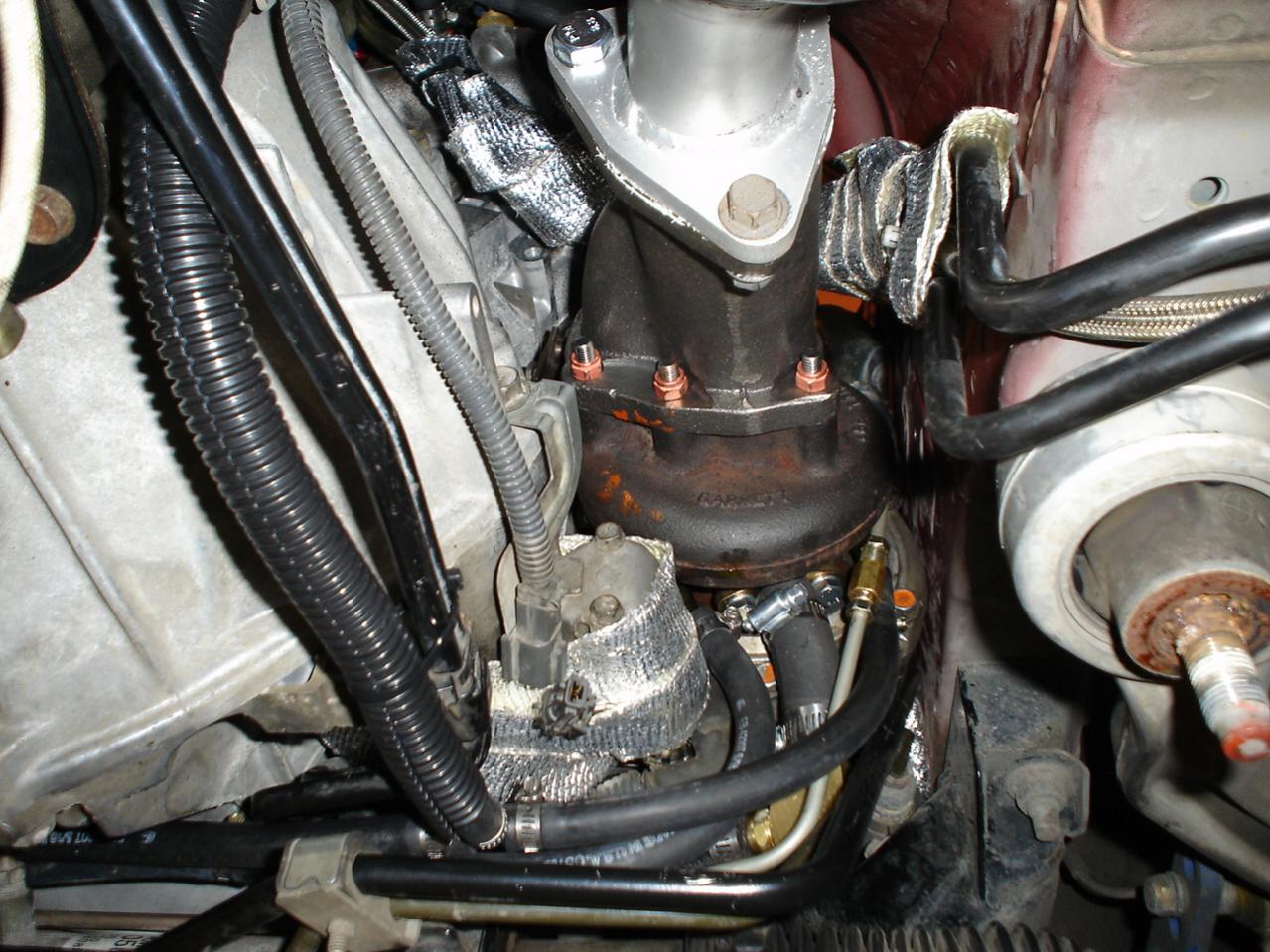

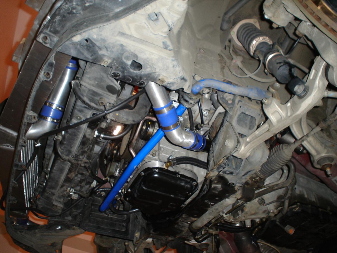

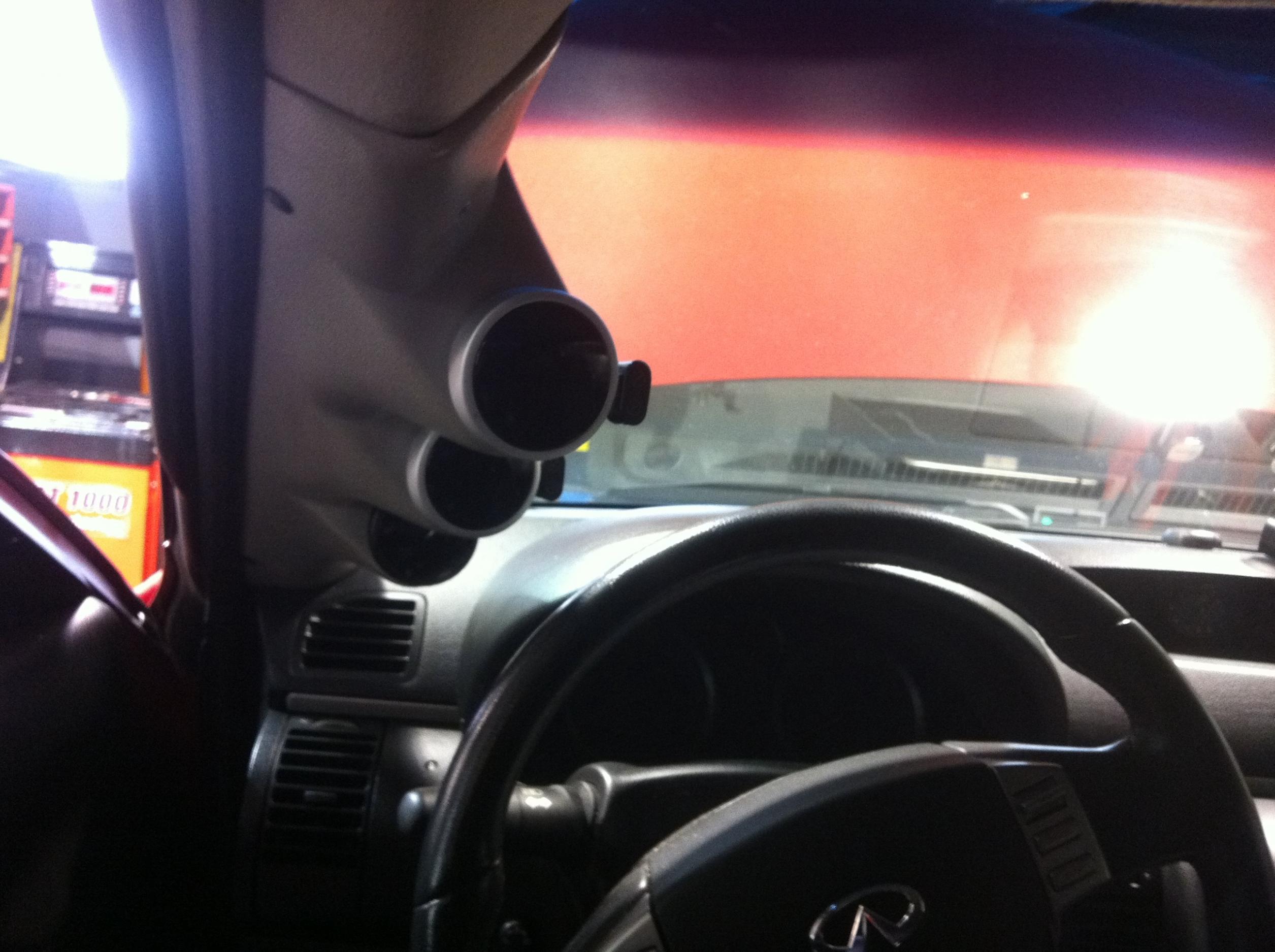

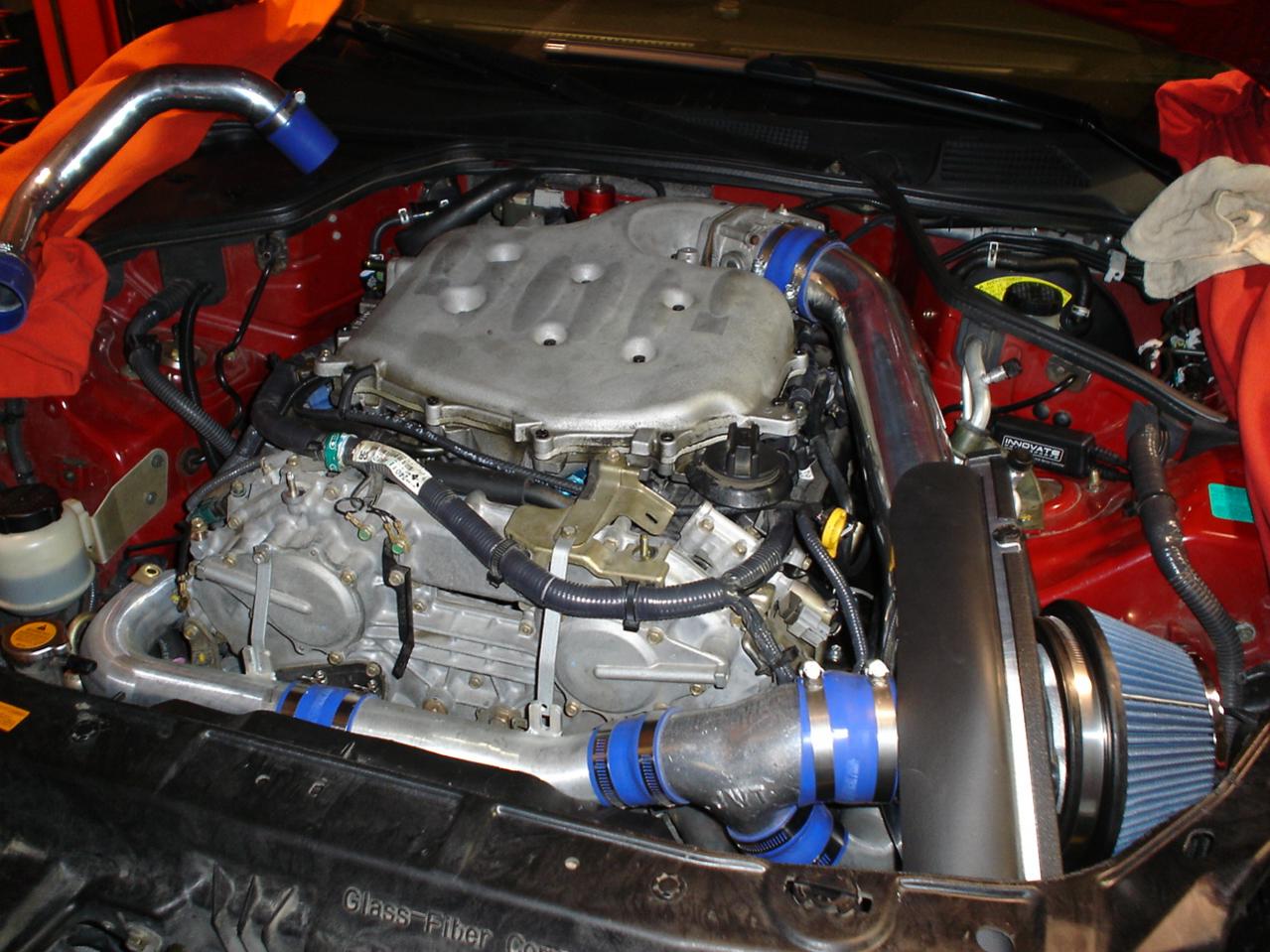

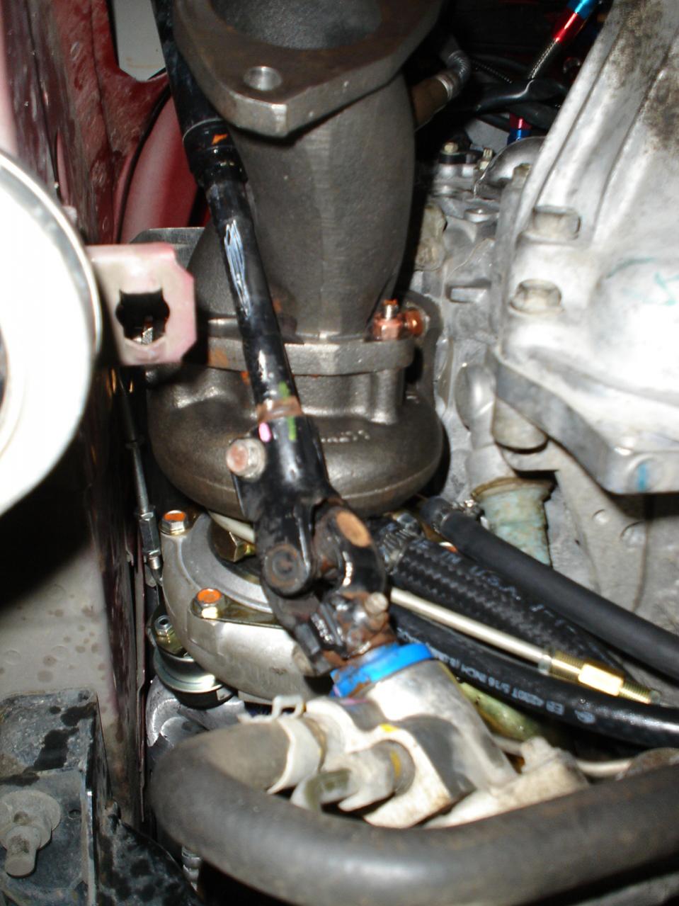

Well the build has carried on through the original challenges and is nearing completion... On the hardware side, anyway. Everything is as it should be- I didn't get them to downgrade anything and apparently most of the issues have been worked out.
I've run into a bit of conflict with regards to the tuning side and whether or not the cobb will manage. Someone I trusts says it should be fine with the right guy tuning it- another guy I trust say it'll be a stretch and I should go to something with more mustard... Haltech came up enough times in the past I figured I'd go with that.
I'm having a bit of trouble locating one- though it looked like there was one on sale from a sponsor / vendor from this site I've inquired about. Sounds like it was an awesome deal so we'll see.
I'm including some photos. The shop has pushed through the wastegate issue we were having with some help from Cam at Lightspeed Innovations from Red Deer, AB. There has been some obvious and anticipated clearance issues but the shop seems to be going strong with it.
If anyone has a line on a used Haltech or they're planning to upgrade please drop me a line and let me know! I don't have any itrader rating in here but I can be found with the same name over in Driver.
To the pics!
To the pics!
