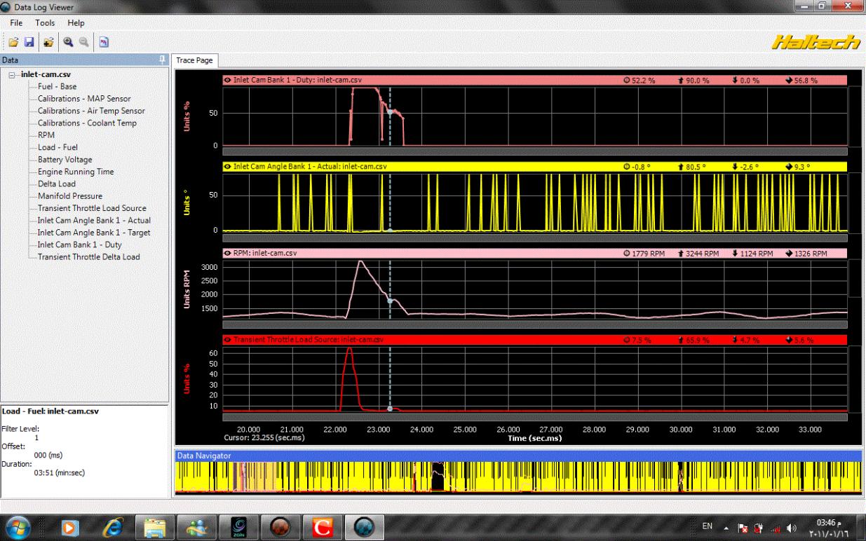

i have log inlet Cam Angle B1 Actual in degrees, and its showing me Crazy high timing without reving.
that was on idle !!!!!!!!! god whats wrong ?
then, i unpluged the valve solenoid connector and checked it, its still showing me high timing, its hitting 80* under no load, just idle !!!!!!!!!!!
and when i rev to 3000 RPM it goes to 0.
here is the log
is it a stuck VTC pully ?
bank2 is working fine.
any hlp plz ? befor i do this

i allso did check the pulse signal in terminal 11 and 10 with the CONSULT-II
by oscilloscope to confirm that the stock ECM is doing its job
everything is good now, i hope.
time to go for the dyno to confirm and see what will happen.
