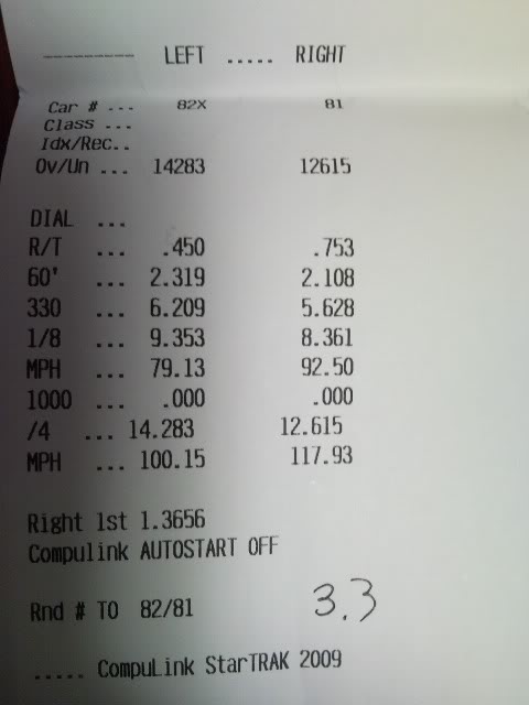

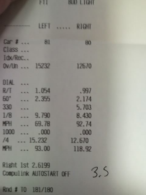

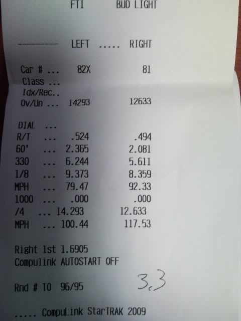

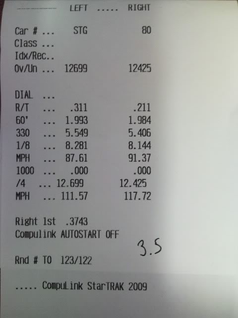

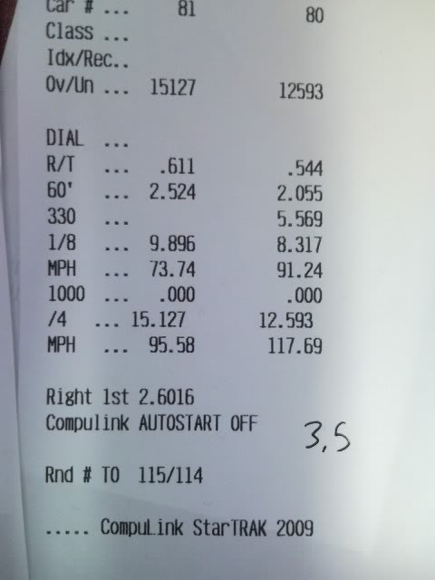

So this weekend i swapped to a 3.3VLSD since i had to drop mine to replace a broken Diff mount stud. And i know that this swap has been debated on at what power level you should consider this swap so i figured i would post my results. Last Sunday i was at the Dragstrip with my 3.5VSLD, had all day and got plenty of runs. After finishing the swap this Sunday i went back for the last hour of test and tune.
Here are my results,(all on street tires) im posting multiple runs to show what i consistantly ran, on the 3.5 i was pretty consistent at ~12.6 but i had one great run and ran a 12.42
*RIGHT LANE*
With the 3.3VLSD installed i still had the same wheel hop issues at before and didnt have as many runs to get a perfect launch (without hop) but here are the results

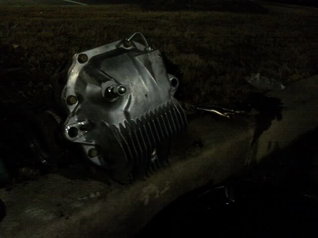

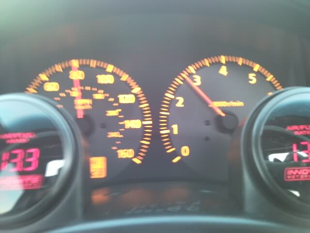

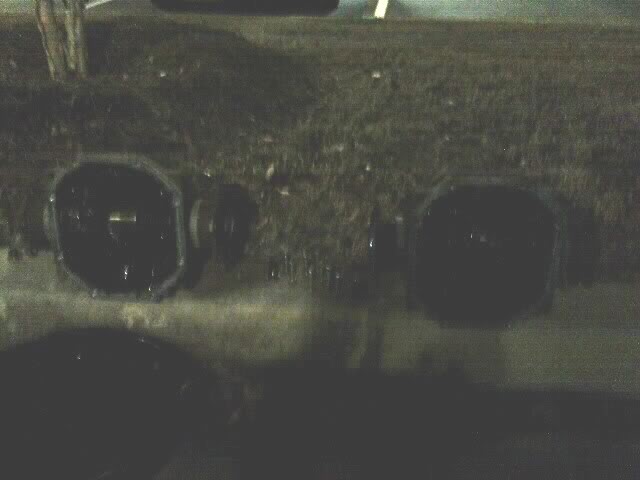

Here are some pics from the install
Conditions were nearly identical between the 2 days, so based on just the timeslips it appears the 3.3 slowed me down with 484rwhp/440ft-lb. But i honestly thing i just didn't have enough time to get the launch right, you can see that based on the 60fts, or maybe the 3.3 hurt my 60s. The car feels quicker especially in the seemingly never-ending 4th gear. I wanted to post this info to see what everyone has to say and to possibly help people make the decision of when to do this swap.

You are allowed to circle your car number on the time slip for easy reference.
I give you a thumbsup for running 400 plus horsepower on street times. 1.9 seconds is good.

Sorry didnt do that, but i was always in the right lane

It doesn't, Cruise Control and VDC are still 100% functional, trust me thats the first thing i confirmed after the install
edit: the light is out of view in that pic but i was actually on cruise control when i took that

With the 3.5 were you shifting in 5th? Same queston for the 3.3FD?
The big advantage for most is the ability to stay in 4th with the 3.3 and avoid a shift after 113mph or so.
If you run a large rear tire like say a 285/295/35 then you are already effectively elongating the gearing, so combine that with the fact you are a litte under somebody who truly needs a 3.3FD power wise IMO, and the result of you being slightly slower is right on. When I made the change my car "only" made 525whp/490ft/lbs at low boost and that seemed like JUST enough to not feel slower and be slower as I compared to several vehicles.
On the street though, where you used to spin in 2nd, now you wont. And thats worth more than the 1mph you seemingly lost the back half of the track.
You arent launching as well with the 3.3FD though so if you did the traps will go back up. As it seems now the car isnt quite hitting its sweet spot in 4th yet, as can be seen by the back half numbers below.
3.5 FD
26.4mph
26.3mph
26.2mph
3.3 FD
25.4mph
25.2mph
Shift slightly higher in the rev range next time with the new gears (especially 1st and 2nd gear), that will help overall. Where is your rev limiter?
**For all the people chiming in with what you trapped, you also have to share your 60ft and 1/4 ET, as anybody can spin to a high trap and $hit time.

Im running a 295/35R19 rear so i had that advantage but with the 3.5 i was hitting the limiter in 4th (7k) crossing the line almost everytime.
I realize i probably didn't NEED longer gearing right now, but i was dropping the diff anyway, will be building a block in the near future and figured if i throw DRs on it the gears will keep me from having to shift into 5th.
I know that i need to stretch out my gears more by shifting higher but my RPM gauge is off just enough to make that tricky, and since i am stock block i try to stay off the limiter as much as possible. I consistently shift at 6750 (via logs) except 1st when im spinning or hopping.
With the 3.3 when i cross the line i feel like i have alot left, before it would start to fall off right before the line, now it feels like i'm in peak TQ (not sure @what rpm i cross the line now)
Those back half numbers are interesting, never thought of comparing those.
