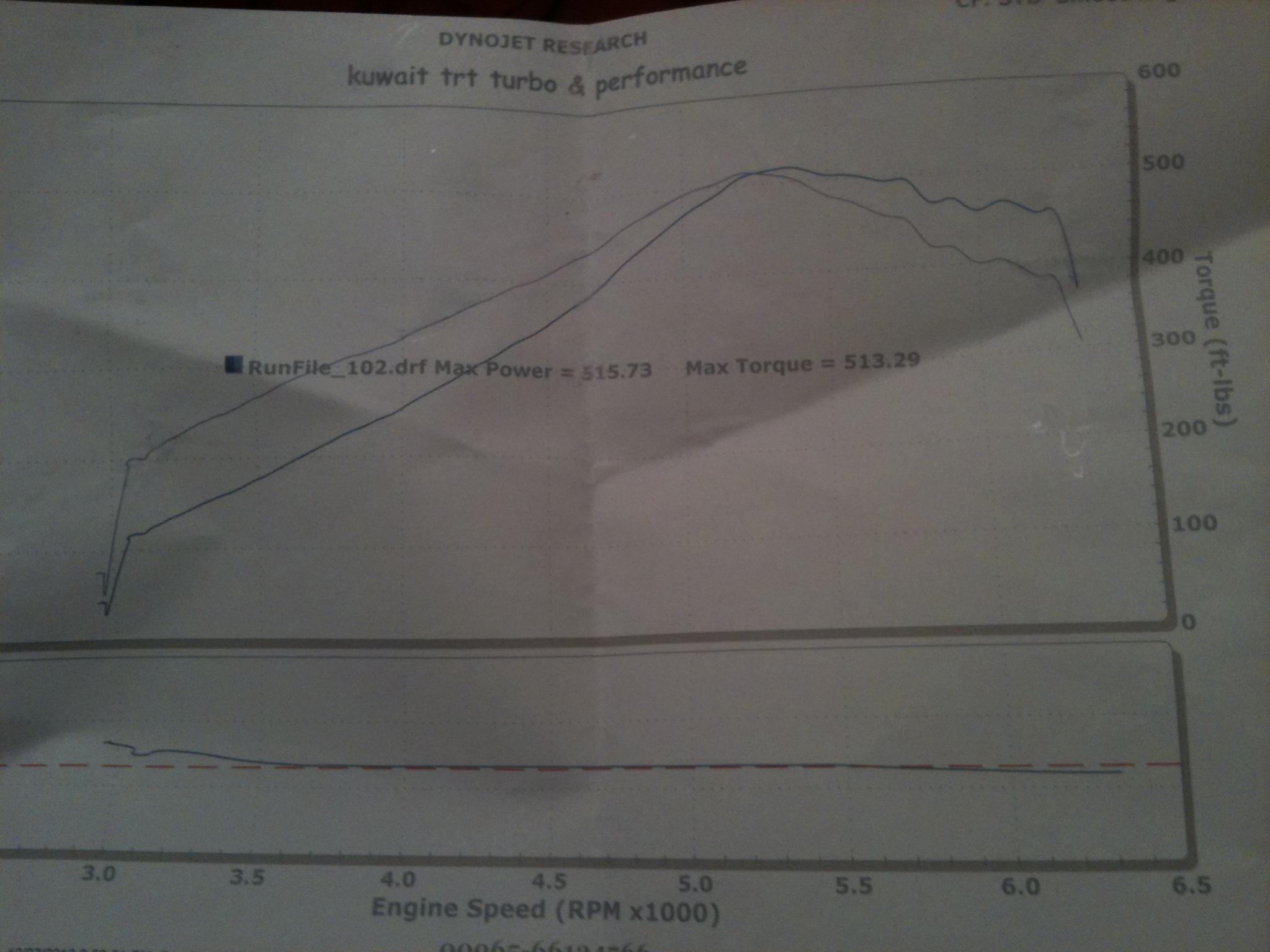

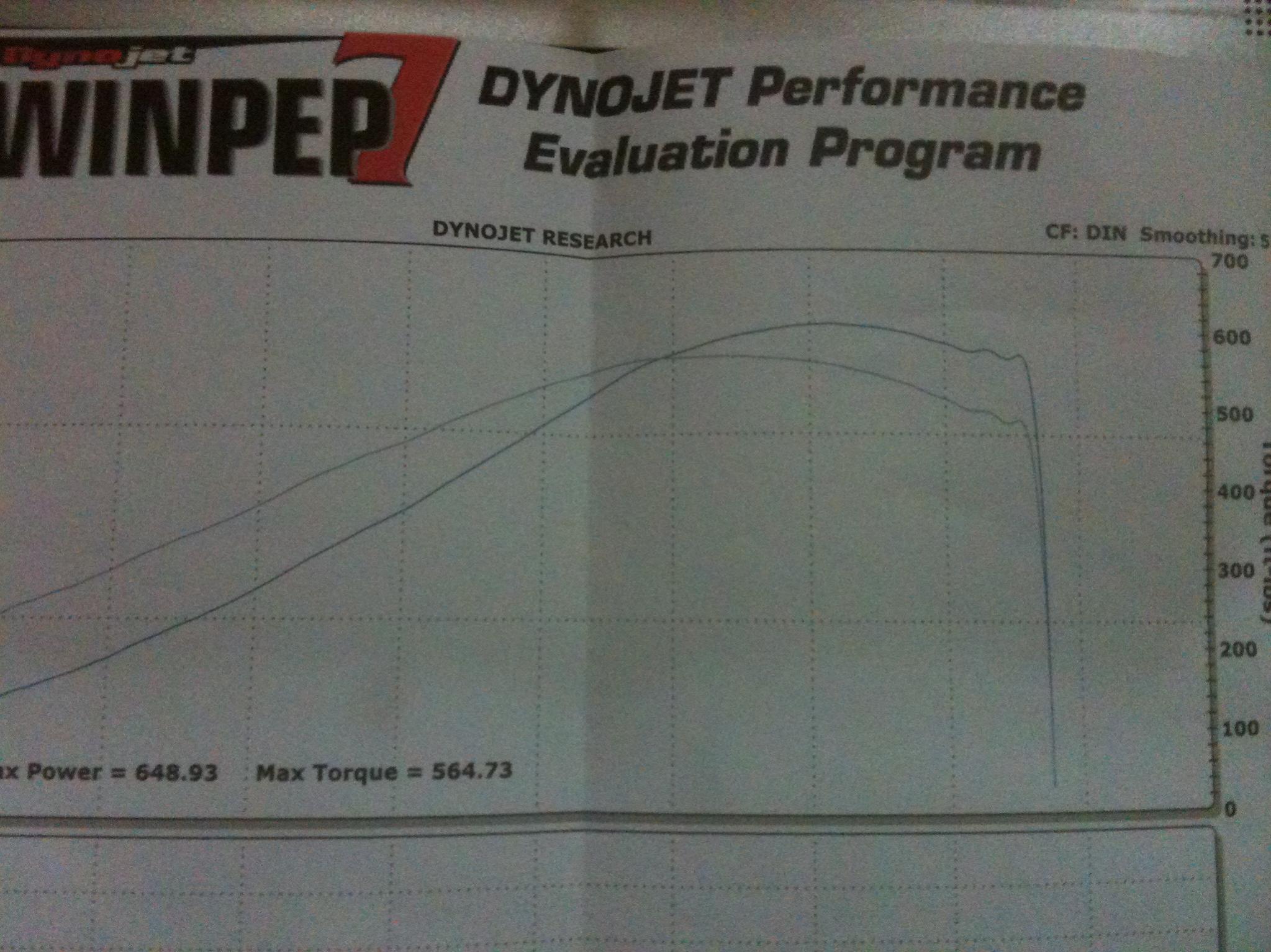

i dunno from where i should start, but here is the dyno runs and graphs.
http://www.youtube.com/watch?v=f4_7ZKKUoJY
after i did some tuning for the intake variable cam control with 16 psi Crazy power came in 648whp and 564TRQ
all runs ar DIN CF
and still using old spark plugs from last year
first graph - 515whp 13 psi with valve float issue.
all are pump gas runs
Attached Thumbnails GTM GT3582R twin turbo-img_0315.jpg   GTM GT3582R twin turbo-img_0427.jpg

still dont like the power drop after 6200RPM
looks like the stock intake manifold is not helping me with my big turbos and big cams, specially with a 3.3FD

maybe get a cosworth intake manifold
i wish !!
is there any cosworth intake in stock ?
Old Mar 21, 2011 | 07:08 AM
dikspiel's Avatar
dikspiel
Chestons Toilet
iTrader: (70)
Posts: 8,859
Likes: 92
From: Cheston's
A few shops carry it, I don't think you will have a problem finding one and it will help with the upper rpms.

Originally Posted by SmallTuner
thanks Alberto
how much cam timing do you have from 6200 and on? might have a little too much and that might be causing your hp drop up top.
thanks, but its not the cam timing.
im sure its the intake, thom000001 have the same issue, im not sure but he dont have a dyno run to 7000 RPM with out hp falling down.
i allso searchd and found some cars have the same issue.
they all use stock intake manifold.

so how much cam timing do you have up top? even on stock intake manifold with cams we still have a constant pull to redline.

its 0 degree from 6100 .
On both the intake and exhaust?
Old Mar 29, 2011 | 06:41 PM
Sharif@Forged's Avatar
Sharif@Forged
Forged Performance
iTrader: (92)
Posts: 13,733
From: Marietta, GA
Rev up Engine? If not...cam phasing on the intake only.
If with stock cam timing, you shouldnt see a huge drop-off in power. Bone stock, the intake cams go to low single digits towards redline. Cam phasing only improves midrange power and turbo spool, assuming the cams are actually phasing correctly. A bigger cam, and a better intake will definitely help the cause, however.
