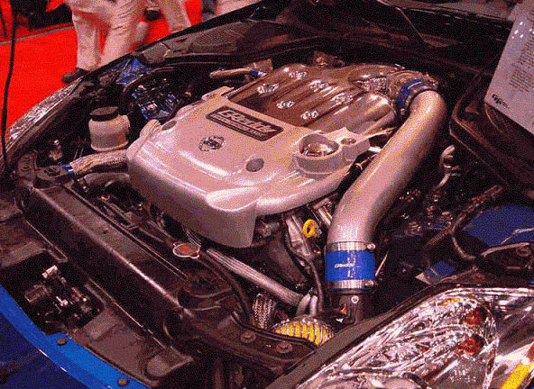

OK. I have finally lost my mind. I am actually considering this. $6,995 plus installation for the Greddy TT with intercooler. Maybe someone is selling it for less? I think I saw $6,600 somewhere.
Question, how many of my N/A mods (see below) would I have to get rid of in order to install the Greddy kit? Obviously the Crawford Plenum and JWT Popcharger Intake have to go, and probably the Crawford Strut Brace, but what about the pulleys, grounding kit, etc.

headers, pullies, popcharger and strut brace would have to go and you would have to get the ECU flashed back to stock except for rev and speed limiters. you may want the rev limiter reset too. this is one reason I don't have any of those motor mods yet.

Why would you have to remove the pulleys? Is there something about the system that I don't know?
You might be able to keep the Crawford Strut Brace. It's possible it could fit.

You can get the Greddy kit w/ Intercooler cheaper then that for sure. And you can keep the pulleys on, no doubt.

1. you would need to reflash the ECU to a turbo program (if you choose) or you can have it reverted to stock with the rev limiter raised and speed limiter removed. or tune it with the turbo in place to optimize performance.
2. your pulleys can stay. i think the only reason to change it is if you went to a supercharger since the supercharger system is connected to the belts and you want the larger stock drive pulley to spin up the blower faster.
3. Plenum imho is nice for NA, but for the turbos.. its overkill.. since you're already force so much air into the system...

Are you sure I could keep my Crawford Plenum? Everyone else says no. If I can keep the plenum I can keep the strut brace too (I think), which is important to me.
Looking at the picture of the Greddy TT I posted at the beginning of this thread, it looks like Greddy uses a different plenum, but mabye I am wrong. The engine cover says "Greddy" but maybe that piece is just for show. The stock engine cover had to be taken off my car to accomodate the Crawford plenum and strut brace, so maybe I just get rid of the Greddy engine cover.

plenum can stay..no reason it cant especially since you dont want to incur anymore costs ..why get rid of it you have it.

Yeah Id think plenum and pulleys can stay, dont see a problem there. just intake needs to go I think.
Id get the ecu redone tho, Id be concerned about the strength of the engine at higher output above the 6600RPM that greddy tests at... might be ok, might not, with all that extra HP is an extra 600RPMs needed.

Cheston is right. Nice for NA power but unneeded for turbo. You may as well sell it though and put the money towards the turbo. Trade it to somone for their stocker and some cash.
Headers obviously come off too.
How much overlap on those cams? Too much is no good with turbo.

Oops I put pullies and meant plenum. Of course you CAN keep the plenum but it isn't needed. I think the cams are small enough for FI. I don't know the overlap specs but I will venture to say they are ok just by what I see out on the market right now.
