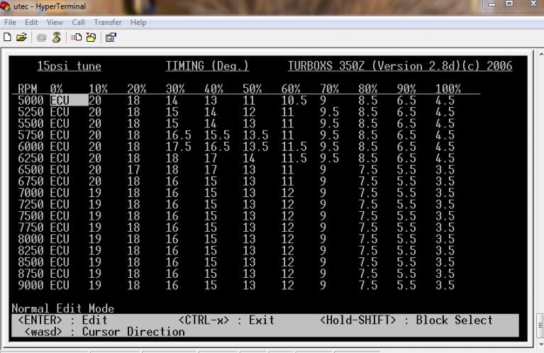

here is the timing table that is currently running off the UTEC.

those -98 dont belong there.
thats really conservative timing, but for 15psi, not too retarded. but you shouldnt be knocking with that timing unless you just dont have enough octane in your gas.
that seems to be the case, so you just cant run 15psi. i'd just @ run 10psi, and get back on a dyno to dial in the timing to 10-15* at the lower boost

I will get rid of those.. just put them to ecu..
I just ordered different wastegate springs.. 10.15lb springs..
i am going to get it tuned at maperformance in mpls... we will see what he can do..
