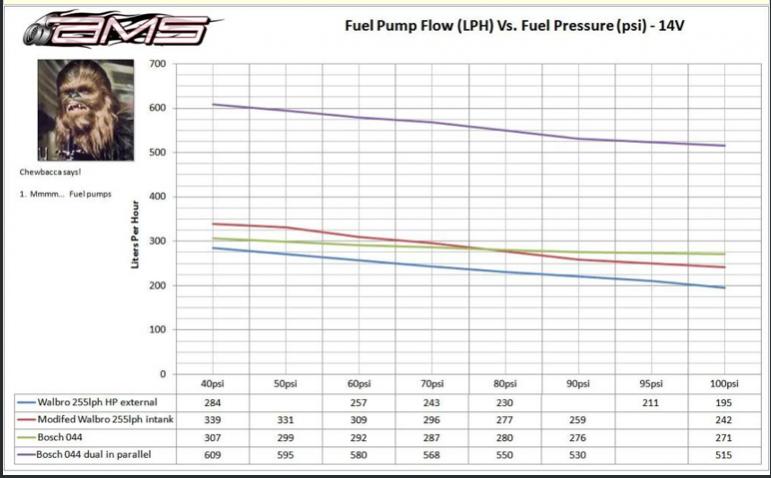

Over kill? Yes, that's enough pump for about 1000hp. Is there anything wrong with over building any part? IMHO nope.

If you can do it relatively cheaply, then go for it. If it is going to cost over let's say a grand, then I'd tell you not to do it, just for the sake of putting the money else where if your goals are only 500whp. As others have stated a 300lph pump is plenty for 500whp. So I'd say just do a 'standard' in tank upgrade then spend the money on tune/ecu. Unless you have a good ecu already, in which case go for it.

For what it Worth.......
I found these FuelSystem Comparisons, Intank with inline, dual Intank and Dual Inline. In parallel and in series.
Attached Thumbnails Twin external Bosch 044's over kill for 500RWHP??-fuel-comp-1.jpg   Twin external Bosch 044's over kill for 500RWHP??-fuel-comp2.jpg   Twin external Bosch 044's over kill for 500RWHP??-fuel-comp-3.jpg
