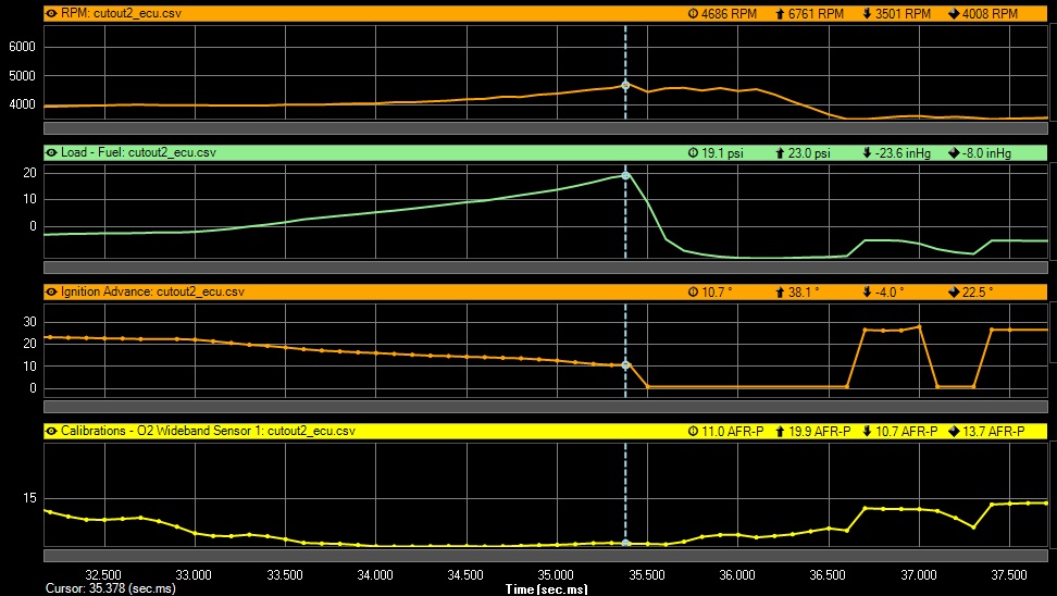

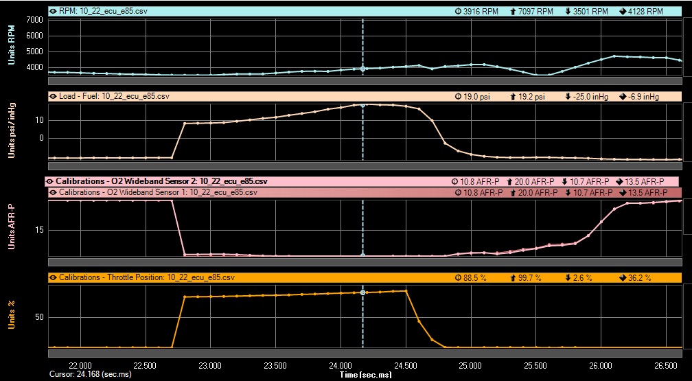

so this log was on E85 and that an 800 rpm faster spool? Seems lazy, and on pump would be worse. Would really make people think about going to a 76mm. A 76 would prolly not be spooled to 18psi until around 5200rpms on E85 and way lazier on pump.
Be interested to see how the new exhaust/turbine setup changes the curve.
Old Nov 17, 2011 | 09:10 AM
  #49
binder's Avatar
binder
Posts: 6,457
that's a bad picture to use for change because i altered other things on the car with that. that image is the large housing and oem exhaust with cutout. Cutout doesn't open until 11psi so up to that point it's stock exhaust and i also do'nt have my boost controller dialed in properly so it was having to add 20% duty cycle over what my base was which took it a couple hundred rpms to ramp up to. So that picture is the cause of going to a larger housing and not adjusting my boost controller.
here is the first spool with my previous setup with nothing changed but e85.

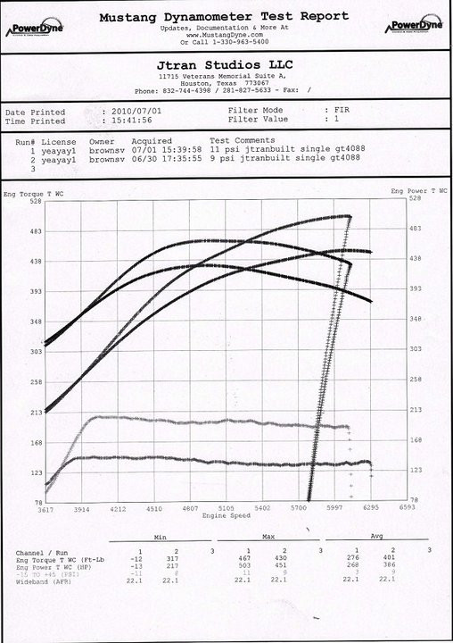

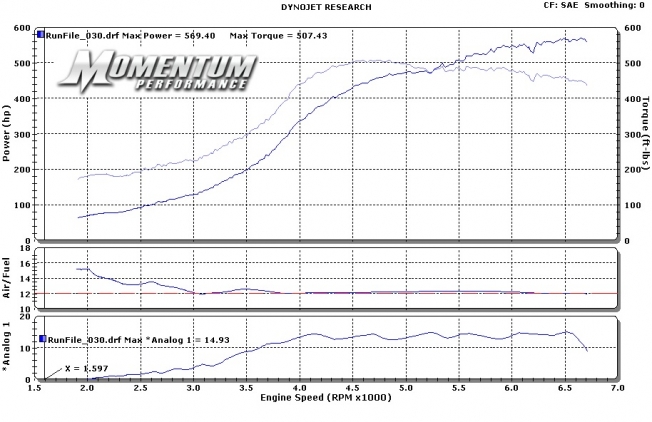

rich, here are some other dyno's to compare. Also if you look at my 19psi i'm not STARTING the WOT until 4k rpms so its only taking 600rpms to get to 19psi.
So these dynos show that the jtran 4088r turbo (similar size to mine) starts well below 4k rpm and is only making 11psi at 4k rpms.
The other is a momentum kit with a gt35r. Smaller turbo and they are taking 4200 rpms to get to 14psi.
I'll start my pull at 3k rpms and i'm sure it will spool a lot sooner than that log.
Attached Thumbnails Billet 76mm turbo experiment-jtran_4088r.jpg   Billet 76mm turbo experiment-momentum.jpg

that sensor calibration is wrong^ that car runs 17.5-18 psi.
for the momentum chart*

ya 4000ish is more expected. 4600+ is like my twins which feel very laggy.
That makes a whole lot more sense now. This is the setup that Hal tuned I think, where you put about 516whp on the DD. I was comparing it to one of my customers who made 513whp on that (DD at IP) dyno at about 18psi as well.
So the efficiency is on par as far as hp/psi goes. I think you guys had cams and a Cossworth IM with that setup though, and my customer had just a simple short block build.
Yep that was the one, car has 262's cosworth cnc heads and IM.That graph is from when we first got it back. Did some minor changes and it made 601 yesterday on the DJ.

The thread i pulled them from said 14-16psi so you might want to go edit that.
Also remember i didn't go wot until 4k rpms and most of the people post dynos that go WOT at 3k rpms. It was the same outcome when i started WOT at a higher boost level on my old housing also. 600rpm to build from vac to 19psi isn't bad. it definitely doesn't feel laggy when i step on the gas.

601 at 18psi on a single GT35?

Binder, I was ill informed about the problem with their dyno sensor, apparently they have it fixed for the new graph.
yeah, they found some exhaust leaks pre turbo, fixed them and put a production cross over pipe on the car(previously had flex coupler rather than slip joint). It had collapsed. picked up a couple HP/TQ and spooled faster. 17-18psi at 3750.
