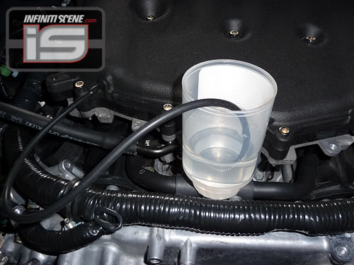

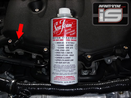

There is a nipple in the front of the intake manifold.
The one where the hose connected to. No need for drill/tap your plenum.
