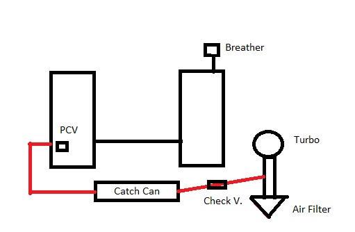

With the breather system I was supposed to say that it goes into the turbo intake pipe. See image below

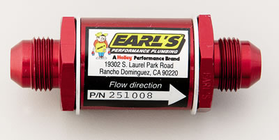

^ why the check valve in that setup? doesn't appear to serve any purpose except restrict flow.

To be honest i read through the long a$$ thread about catch cans and crankcase pressure on this forum and the above is what I ended up with. The check valve is a earls -8AN so it has a decent opening.
Does my setup help CC pressure nfi however open to suggestions.

not sure Mr RIzk, if that passenger side vents when under boost then it should flow enough but it would be restricted by the small openings on those ports. If you have abnormally high blow by then they might not be sufficient for your exact engine then.

A quick update. I have now drilled out the rear drivers side port to about 10mm and also enlarged the PCV to 6mm. I hope this helps.

It should help a lot with crankcase venting. The unfortunate thing is if that rear seal has already been compromised then it might be damaged and continue to leak no matter what.
