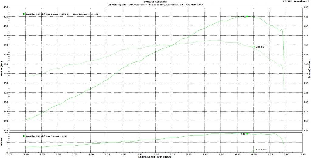

Just wanted to share with everyone my results from my vortech supercharger. I know I don't post very much because I know how to use the search button Lol. I had my first dyno done at z1 Motorsports about 3 years ago which resulted in me making 240whp with an intake and exhaust. Now fast forward 3 years and back at z1 Motorsports my car ended up with 425rwhp and 362tq at 9psi and I couldn't be happier. my mods are:
2.87 pulley
gtm pulley mod
stillen headers
kinetix hfc
HKS exhaust
Kinetix SSV manifold
JWT clutch and flywheel
DW 600cc injectors
Walbro 255 fuel pump
UpRev MAF GT
Osiris for tuning
I definitely want to give a shout out to Rob and Jon at z1, They are awesome, they literally stayed until 1 in the morning fixing hiccups and tuning the car.
Here is the dyno sheet

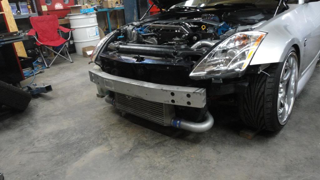

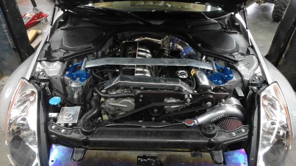

Yes I do, engine bay isn't polished up, harness cover or front bumper is not bolted on though

Nice #'s and good looking car. You should looking into a custom CAI. Search around here for ideas.

Really good numbers for 9psi...Enjoy!!!!

Great numbers for 9psi, merry Christmas to you hahaha
