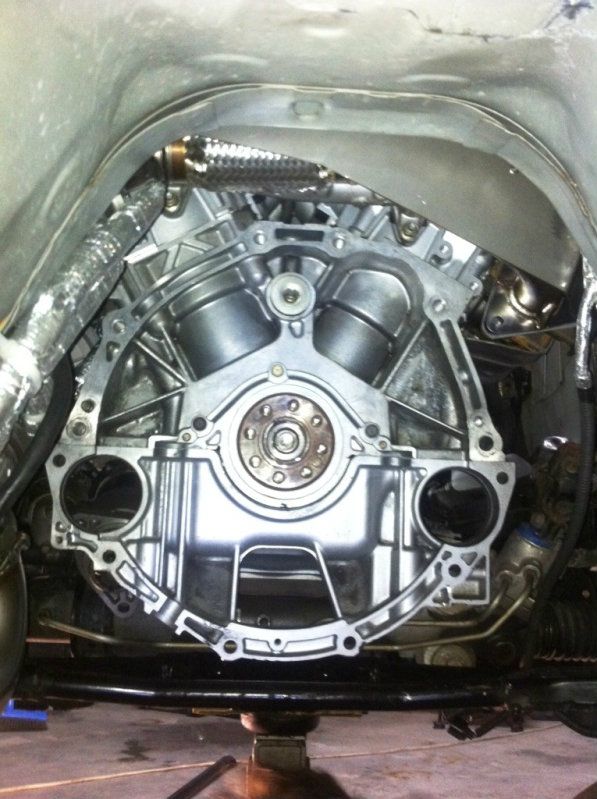

So 7 hours of dropping trans, fixing the flywheel so its now lined up with locator pin (pin had been hammed in by engine builder...) but its bolted in so its in the right position, but still not sparking more than once ... Any ideas?

Check the crank pos sensor for damage.

Just remove it and inspect the tip. Its under the car on the bottom of the bell housing.
