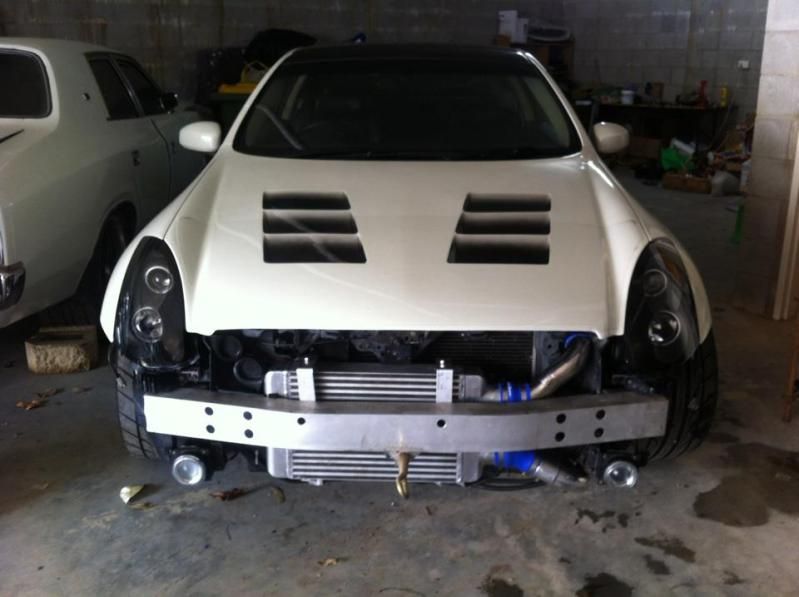

Pics update
Intercooler in, bonnet and fenders back on
Off it goes to tuner in Australia !
