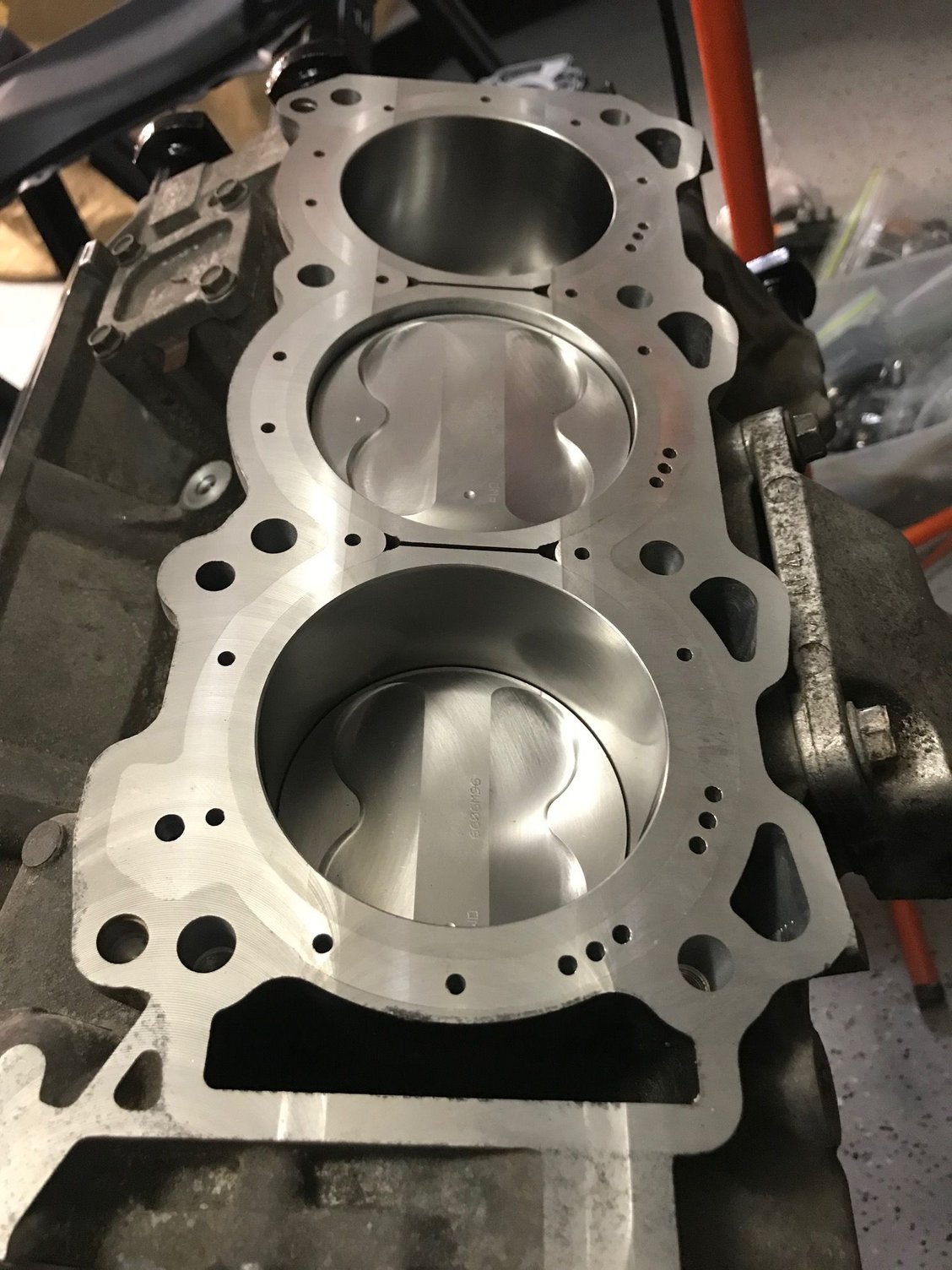

My new closed deck block from RJM with Turbo Tough rods and Wiseco pistons. Ported heads with Ferrea valves, seals and BC 272 deg cams with springs.
I like where this is going. Ohhhh yeaaaaahhhhh
