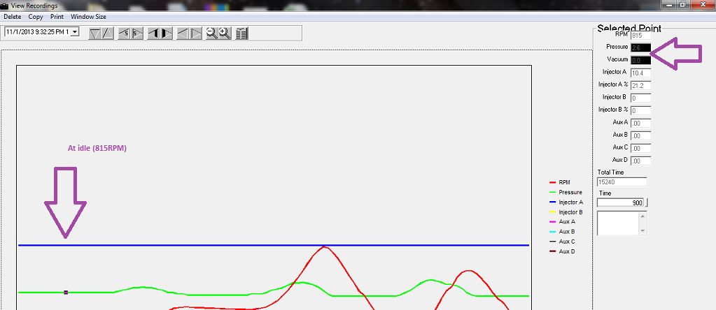

^I hooked up my laptop to the box tonight. In system settings should it be set to Additional Injector Controller or Programmable Signal Calibrator? I picked Vacuum/Pressure for display mode.
However watching the real time variables with the engine running, at an idle my Vacuum/Pressure manual Autometer gauge registered about -12ish PSI of vacuum. At the exact same time the SS box was telling me that the Pressure was 2.1 and Vacuum was 0. To me this suggests even at an idle under vacuum my SS box thinks it is under 2PSI of boost.
What are the settings for AUX pump supposed to be?

Looking at the RealTime Chart, is not the way to do it…….
If you want to verify how it's working, run your car while watching the Highlighted Cell in the Maps. If you give it some gas, you will see the Cell move very quickly thru the cells.
Here are the Settings I used when i used an Aux Fuel Pump.
System settings
Display mode, you should have vacuum/pressure selected
Application, you should have programmable signal calibrator
Output settings
PWM mode, pressure 0 to 30 PSI/5vdc
Output A mode, Aux fuel pump with abortive start time
Output B mode, over RPM and Pressure
Over RPM, 950
Over pressure, 1

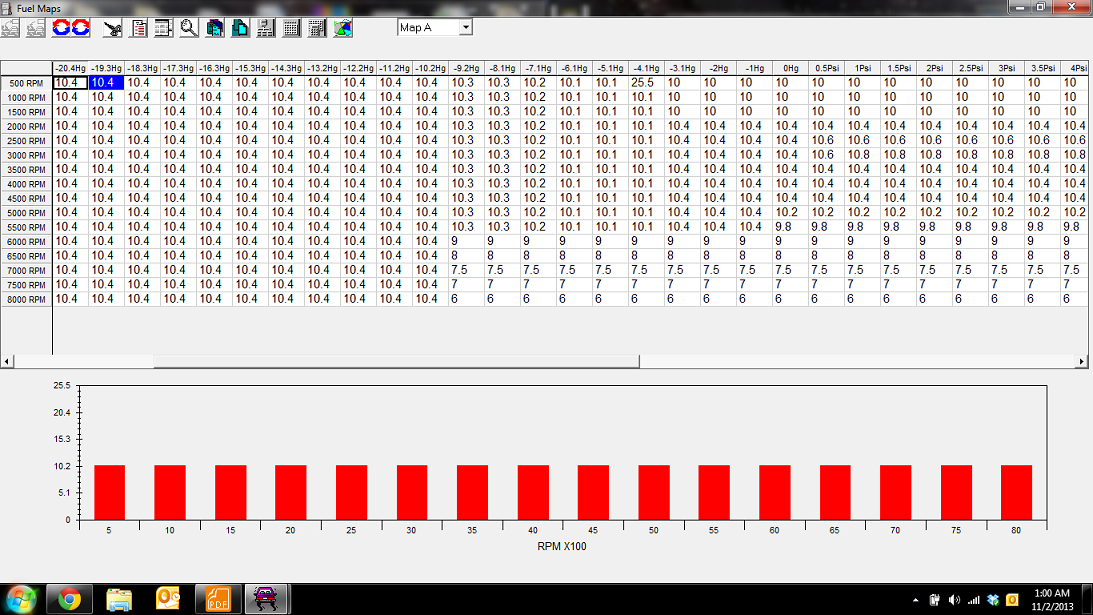

Thanks, I will try that tomorrow. Meanwhile here is a SS of my Fuel Map. To my knowledge it has never been changed from default values. But it seems like in the upper PSI/RPM ranges, the trim leans out?

I can not tell you from your fuel map what you AFR's are doing…..
Who did the Tune?
The Stock maps from Vortech Are Crap.
But, I can tell you IMO, Who ever did the tune did not know what they were doing….
In the Fuel Map, Values should not very more that .5 from Cell to Cell in any direction.
Also, can tell you from looking at part of your map, most likely your car does not run very well.
