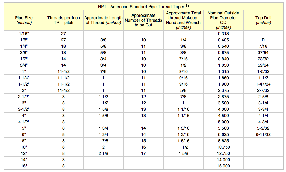

Old Dec 30, 2013 | 03:56 PM
OldManZ350's Avatar
OldManZ350
Posts: 2,429
Likes: 230
Who knows……

9/16 is 36/64 very close to 37/64
Old Dec 30, 2013 | 04:34 PM
str8dum1's Avatar
str8dum1
Joined: Oct 2007
Posts: 8,807
From: raleigh-wood NC
ya 37/64 is an odd size bit. available on amazon etc, but not often in drill kits bc its very big.
9/16 will easily tap to a 3/8 npt. Just make sure you dont tap more than around 1/2 or less way down the tap. Obviously the tap is tapered so if you drive it down too far, you'll never tighten the fitting properly.
