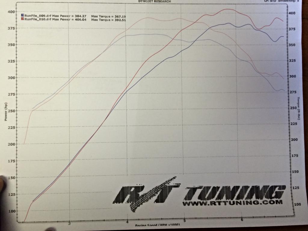

Low boost 7 psi made 384hp/367tq
High boost 10 psi made 406/392tq
I love it so far! boost is definitely a different world! I especially love that RT tuning got the tune really good that the car feels like stock out of boost and boost comes on really smooth. It is a lot of fun! I am still getting used to the new power so I haven't been able to get on it as much.
Here is my dyno sheet - Vince said that he pulled the timing back a bit at the top since it's a high mileage motor, he said this was a pretty conservative tune.

did you do a compression test before your build? Might be a better indication of your engine health than your odometer?
great numbers though and enjoy the rig!

I can tell he tuned it pretty conservatively... I'm making 443 whp @ 8.5psi on a 132k mi engine with a worn out greddy 18G kit with modest timing. Word of advice -- watch the oil level carefully, like checking it at every fill up.

Yeah I remember looking at your build prior to getting mine installed I wanted your numbers but I'm still happy with a conservative tune. They put motul 8100 5-40 I'll check it at 1000 miles. What oil are you using?
