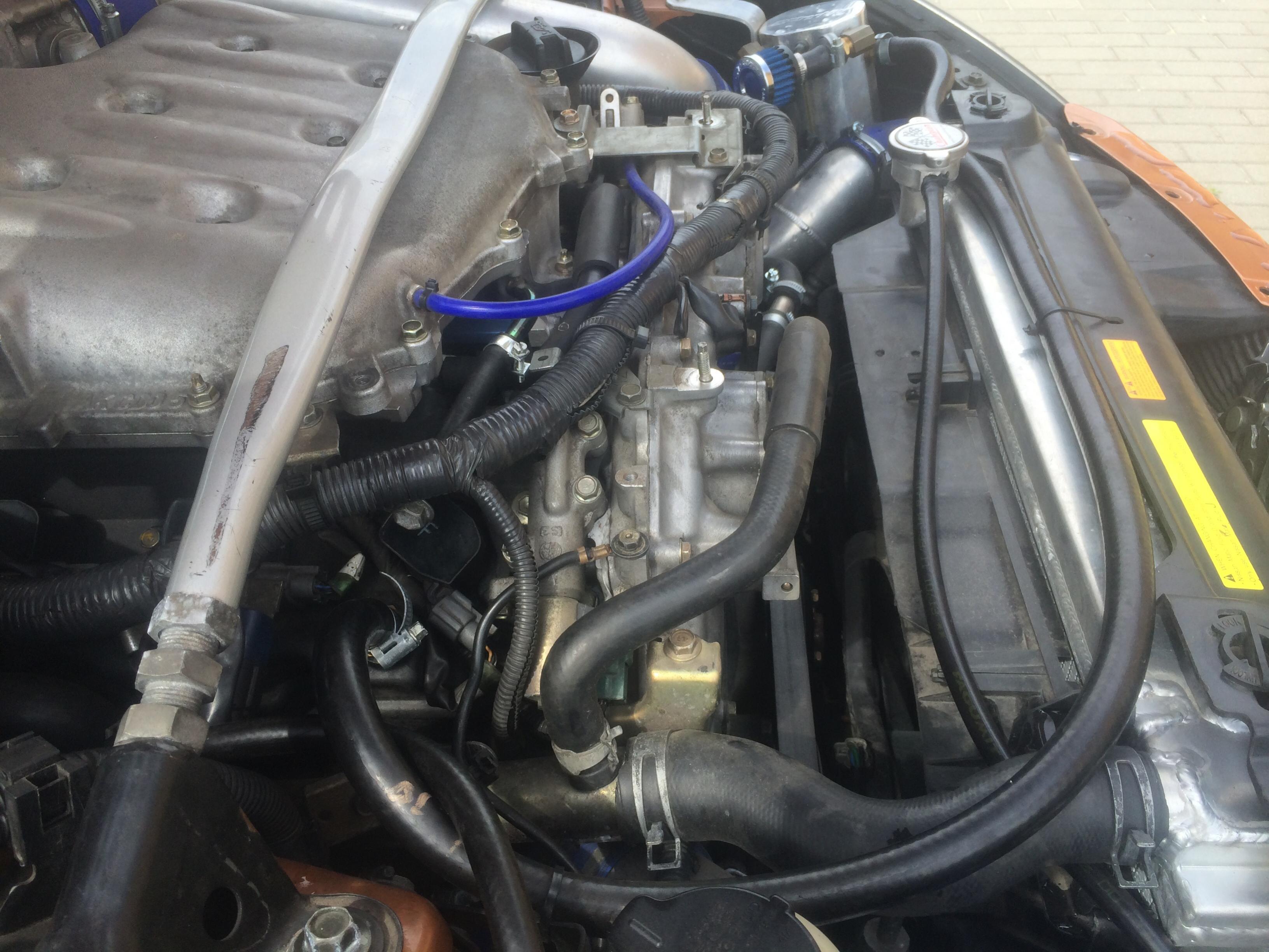

this is how my current setup runs. pcv and driver side of the cross over have filters, passanger side of cross over and rear of driver side cover run to catch can with an additional filter. just cleaner to make new covers though and not have a small filter smashed between intake and valve cover

Ok I pluged pvc and intake,valve covers connected with catchtank with air filter. How do you think wil work or I should connect to catchtank pvc with back valve?
