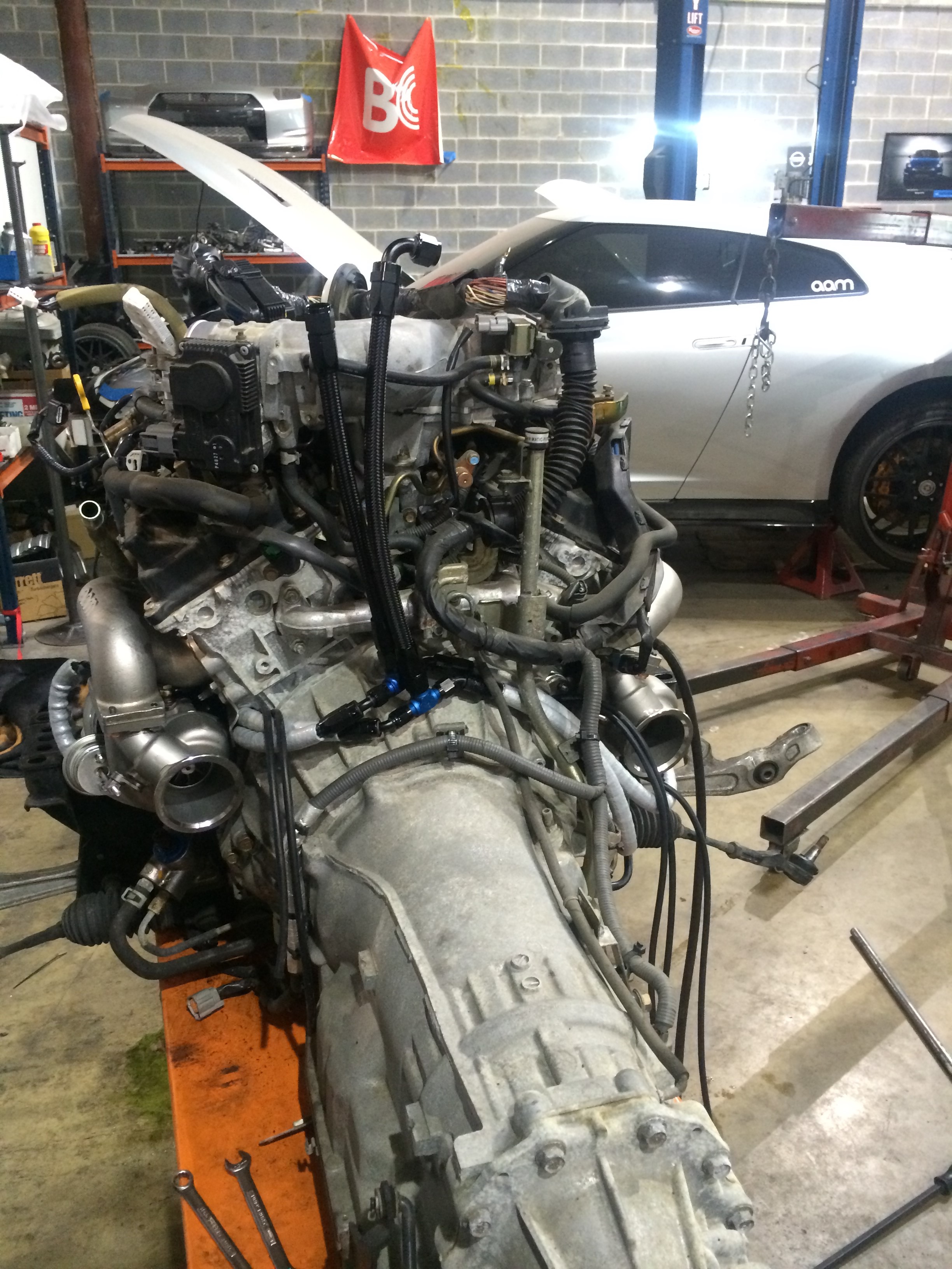

This is my daily driver so not much hard driving. Boost comes on at 3k rpm and is constant up to redline. There is very little noticeable lag. The TQ is noticeable but not over powering. The installation was done at AAM’s shop so I cannot comment on the ease of installation. From the pics I was given, the installation looked straight forward, once the engine was out. The final result is unassuming from the top, a hint of the intercooler from the front and a very clean appearance from underneath. The turbo’s are tucked away from sight, but to be honest there is not much room to begin with. Everything looks to just fit nicely and neatly under the hood. I have a VERY mild setup at 6psi giving me a 60% increase in HP and a 63% increase in TQ. With the base tune, the Z drives like you would expect it to have come from the factory.

So you made 394 at 8.5psi, while they just posted another dyno on a 6mt making 605 on 9psi?? weird.
But that looks like classic boost creep. might be able to port the internal gates, but prolly not.
Looks like you are out of fuel or they didnt tune for the creep. Either way, that needs to addressed even if you dont rev that high.
And looking more closely, do you know if that was just on wastegate springs? Boost seems very uneven if its just on a spring. Can you get the graph with a smoothing of 0?
My application is with a DE + AT, the 605 is using a 370 MT. not really comparable. If you want to compare the two I would use the % of increase then account for the AT. I had a 60% HP increase at the 6psi setting. I don't know what the 370 had before the install. or if its tune eliminated the boost creep.
Yes, it looks like boost creep, I know I need to do some tuning work. That graph was just to compare against my baseline (from the same local shop).
The turbo has a wastegate actuator that can be set from 5 to 10 psi. Mine are actually set to 6psi. They are not the most stable at that low setting, what I should do is use the integrated boost control solenoid valve and an aftermarket boost controller, like a Haltech. That's next years project. Right now the snows flying and the Z is in storage.
