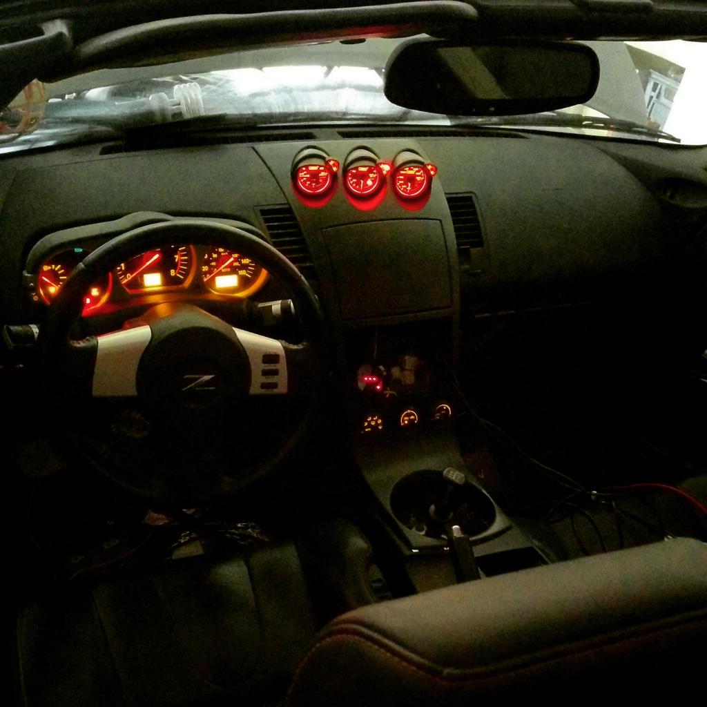

Assuming he's doing this on a budget and doesn't have a standalone or some kind of boost controller (and is running WG spring), a failsafe will be useless (especially with an uprev setup). You have no boost controller to drop to WG pressure, no alternative map/ignition/fuel cuts to turn on, nothing to help you out
Op buy pretty much anything aside from an unknown Chinese brand. I know a few people with great experience with pro sports so I have a few in my car... Autometer works.
Do whatever you want. I'll upload a pic of my gauge setup if I can figure out how
