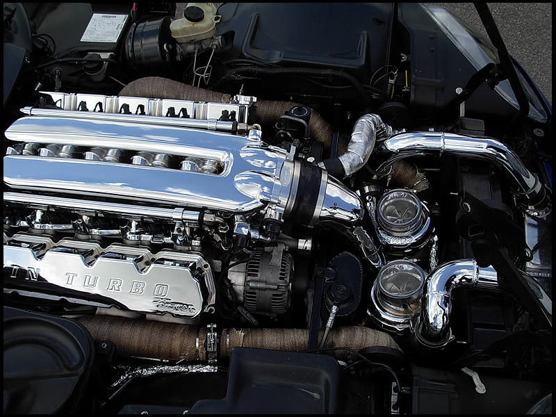

Originally Posted by Resmarted
If you like them, do more research. There isn't that much out there. When you're building a turbo system, keep it simple. Less crap to fail means more time on the road. So whether that means oil or water for you, whatever. It's your car. Knock yourself out, but I for one don't want to mess with them.
Understanding what you're saying, but my personal opinion seems to like the water kit. Yes it is more money, in certain aspects. There are different things to consider when going with/without oil.
Your point about the cooling system not being made to pump that far/hard makes complete sense, however, out of all the reading I have done on these, I have not found one person that has had an issue with the coolant flow. Granted, there are not too many people that have tried these.
And here is one of the more popular viper setups
