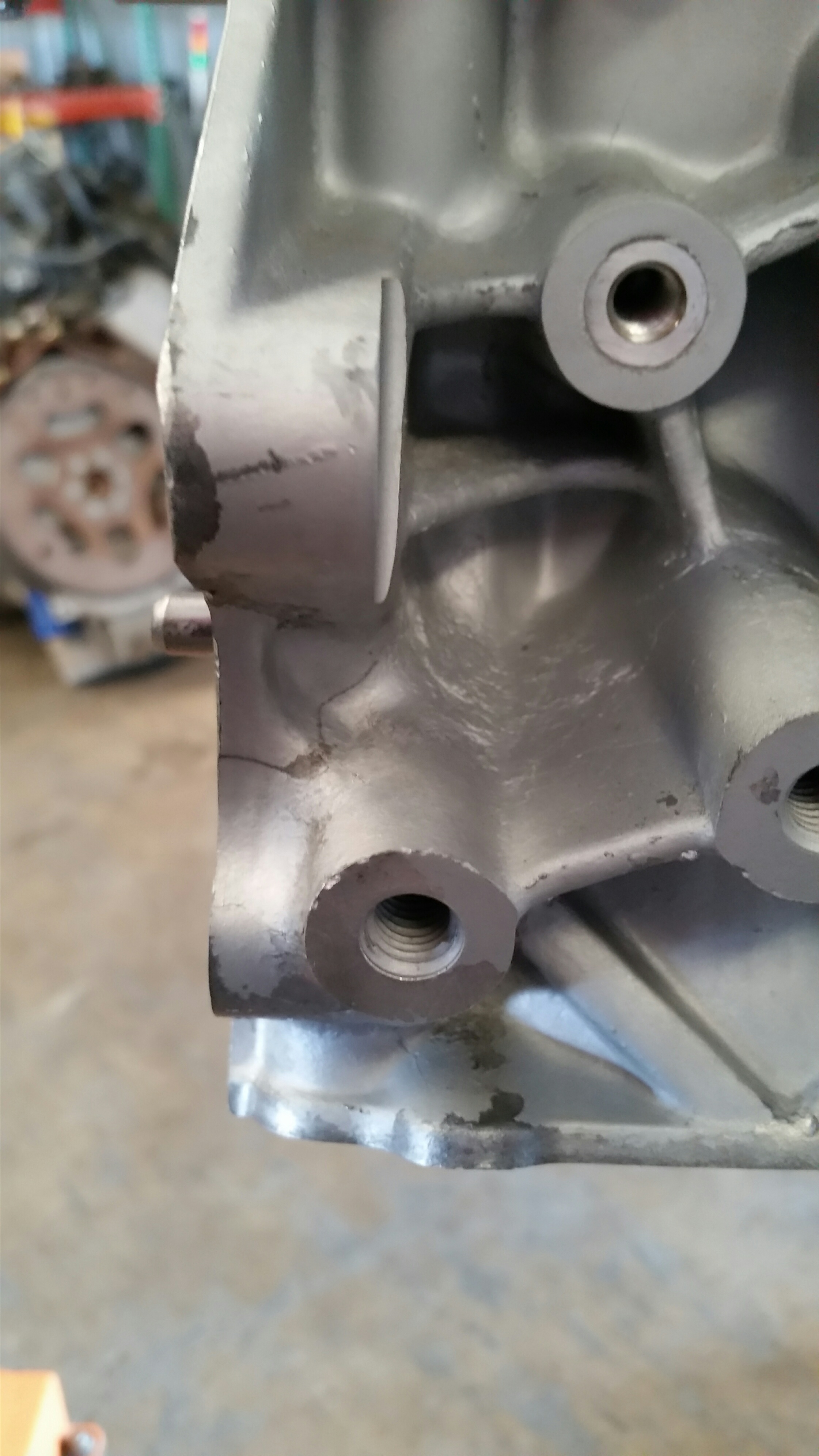

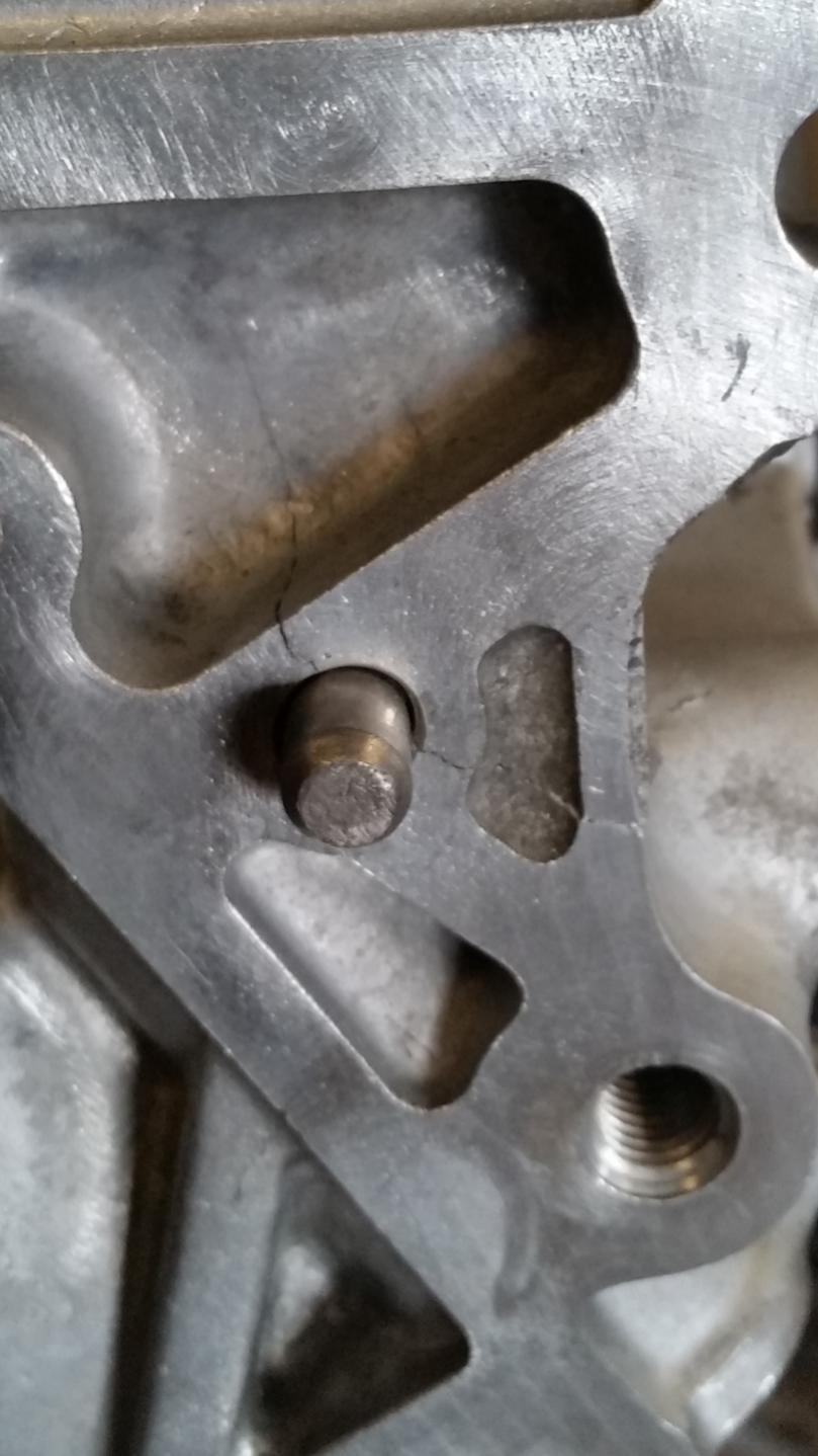

I am in the Process of having my engine assembled right now,, However when I dropped off the Head gaskets yesterday, my Engine Builder showed me this small crack. My question is will this effect anything and What can I do about it? In a normal block I would just get another and move on, But this block has already been Sleeved by Darton........ The crack is on the Right lower side of the block where the lower Guide Pin is, I am building this motor for at least 750WHP and just want to make sure that I will not have to have it back out in a short amount of time.... I have done alot looking and basically that ear of the block is just used to fasten the front cover to the engine. The Engine builder says he is not worried about it at all, But I just dont want this to become a bigger problem later down the road, because I know that ANY crack has the potential to become a bigger deal!! Thanks in advance for any info....... BTW, this is going to be a Twin Turbo, Darton Sleeved, C8 cams, E85 motor so there will be alot of stress on the motor.....

doh! I wouldn't risk it, with a high HP motor i wouldn't want any possible issues

JB weld.

That's not a small crack. Get it Tig Welded!

^ a little bit of solid aluminum to reinforce and tig weld it. I wonder if the sleeving process cracked it.

Unfortunately, I have a decent idea how it happened, there is a fllat spot just out of the range of this pic...... It was either dropped or happened during shipping..... However, I am taking to the machine shop Monday morning to have them repair it.... Hopefully it's just a day procedure so the build can carry on. Thanks for confirming what I didn't really want to see or believe.. Lol

bare blocks are under 200$. i'd start with a new one.

True, But the sleeves are $1200.00 and to have them installed by Darton is $1400.00 + Shipping.......... So that being said, I am having the machine shop weld it.....
