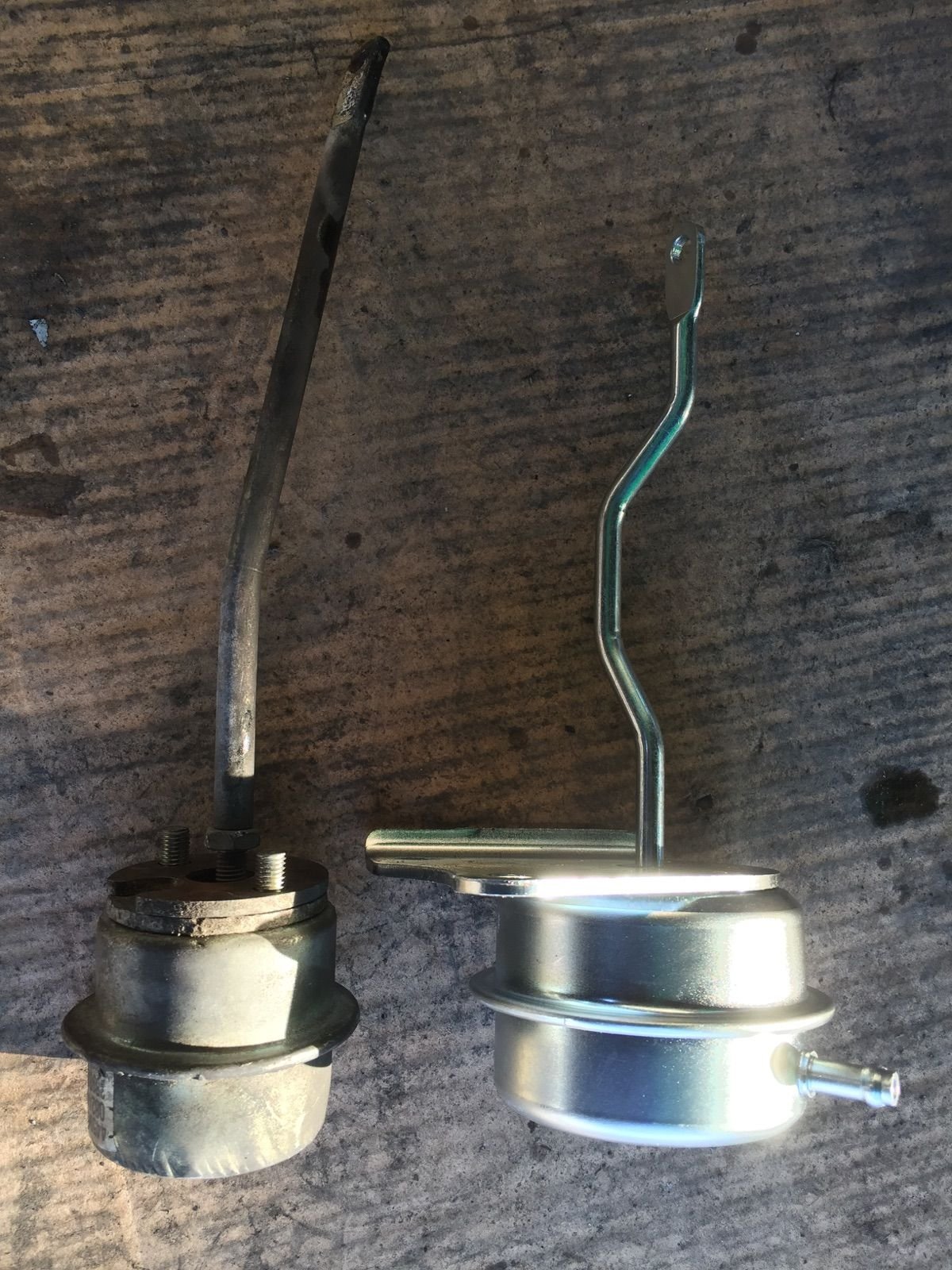

I bought the wrong size. any ideas? I need the one on the left. I bought the one on the right

cant return it? if not, maybe you can straighten itout and it should work if the rod is long enough once straightened. or you can get an extension welded onto the rod

Rather than modifying the rod I would modify the bracket to sit closer to the bypass valve

I would like to buy one that fits without modifying it. Halp!

fyi: it appears that maybe the actuator has been fabricated a bit by aps. at least that's what the turbo shop said when I've send them the info. hopefully they can fabricate something for me. The angle and the length of the rod has to be the same. i've seen a few where you can adjust the rod length.

Looks like the old one unbolts? Can you just buy a piece that allows you to thread the old rod back on?
