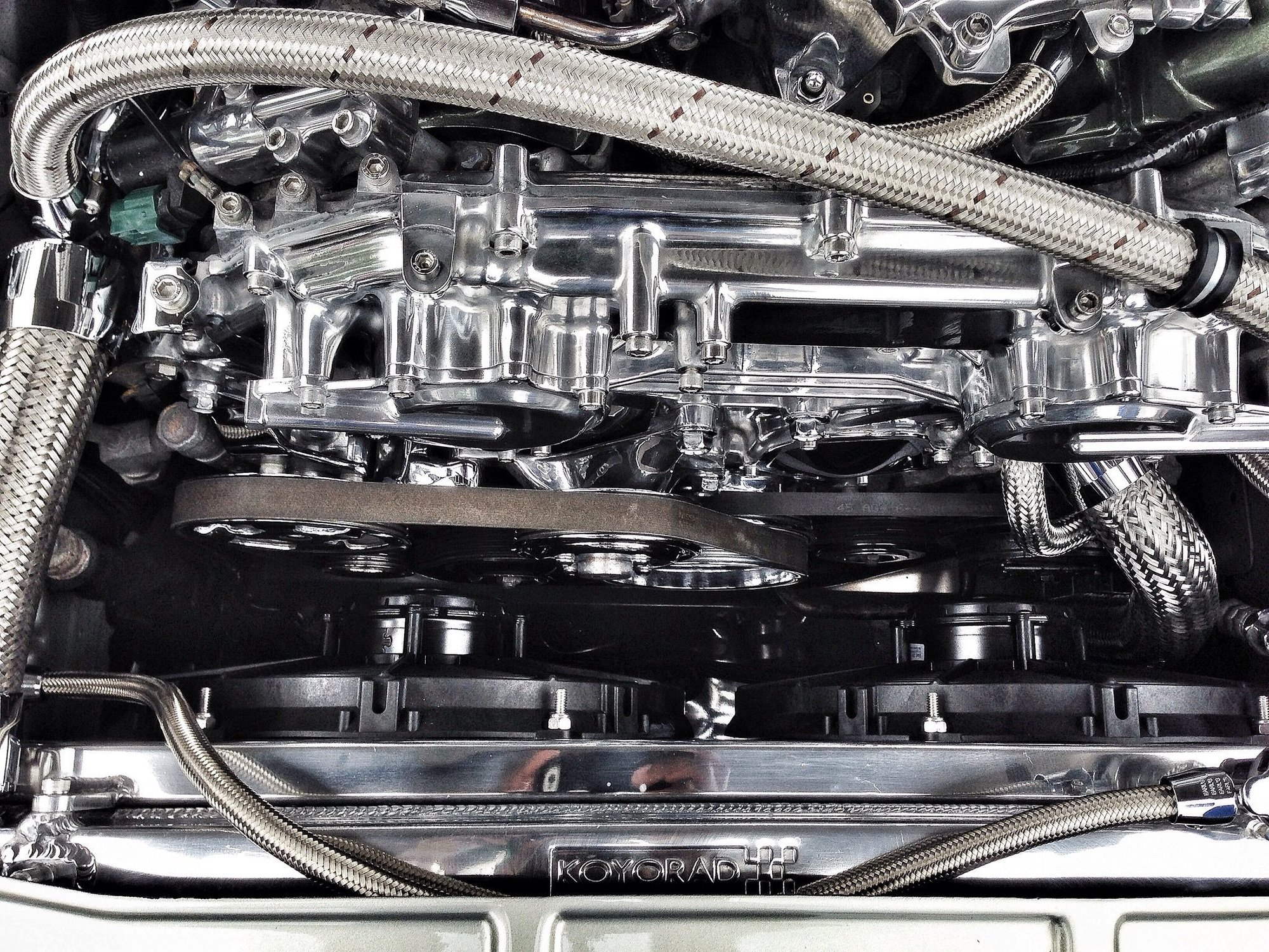

How did Koyo fit on the G35? Did you have any fitment issues in stock locations.
considering buying koyo for my 5at G35 and just want to know what i am getting into before tackling the install myself on a daily driver.
I actually bought the Z version of the Koyo. But still the fitment was fine. No issues at all. These are some older pics but you can see how it sits

wow. that is one sexy and clean looking engine bay.
By any chance are you familiar if the OEM fans suppose to bolt up to koyo or is it necessary to go with aftermarket fans.
the upper points on the radiator do not seem to be sitting in stock locations. are you using the z race koyo or the v-core?

The OEM fan shroud should bolt up to it.

how come your upper mounting points on the radiator do not sit in stock location with clips? did you do away with them for show purpose or they did not line up?
sorry to bug you with so many questions.
Remember I'm using a Koyo that's made for the 350Z. The mounts won't line up because the G and Z core supports are not the same
