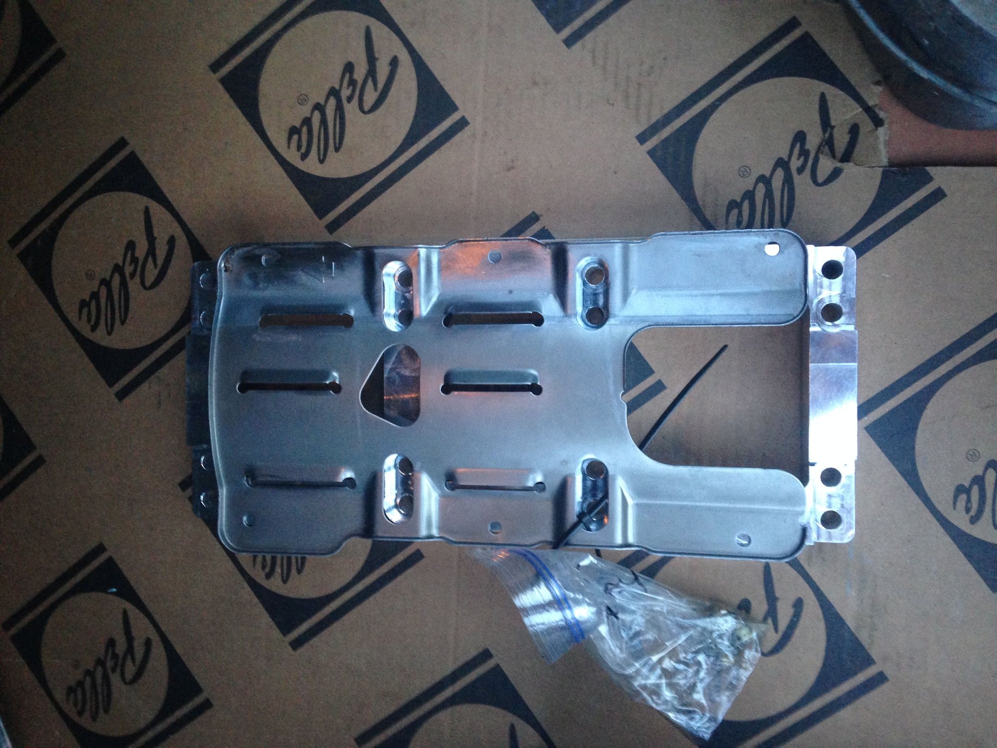

Got my main girdle today from danasty. They said the windage tray needed to be modified. Put it in my car to drop off to builder and noticed there are no whole drilled or tapped to bolt the tray to the girdle. Nor do the holes on the tray even fall on the girdle ( hole half on half off ) anyone give me an idea as to what I need to do exactly? Is this how it is and I need to drill and tap?

By chance I just saw this in their original thread selling the girdle when researching parts for my build.. Dynosty states it is deleted and not necessary.

That's weird cause guy that placed my order said it had to be modified. Idk if it's not necessary then that's even better

@35reilly Most street cars are discarding the windage tray. It bolts directly in and no modifications are required without windage tray.
For a dedicated road race application I would recommend keeping it, which will require drilling and tapping the girdle to accept bolts to secure windage tray. Additionally you will have to clearance the upper oil pan to fit the windage tray since the girdle is much larger.
@jdm-v35 The billet girdle is a great idea for all builds, but becomes especially important for higher revs and higher power. It's cheap insurance so we use it on most performance builds to help keep the bottom end securely in place. I would consider it mandatory on high power / high revving builds.

Thanks!!!! Yeah I talked to Logan and he explained it all to me. Thanks for responding but we're gonna run no tray!!!
