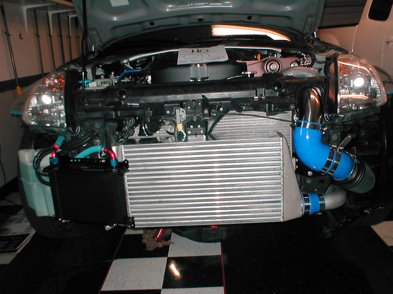

Yes, you will have to relocate the horns and my need to trim that bracket.
You will also need to make some mounting Brackets
Attached Thumbnails Smaller intercooler vs Higer flowing SC-p1010004.jpg   Smaller intercooler vs Higer flowing SC-p1010016.jpg
