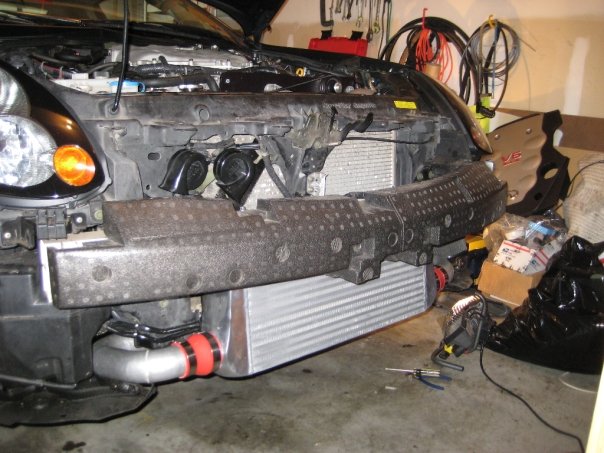

you can fit a 4.5" IC behind the stock crash bar no problem.

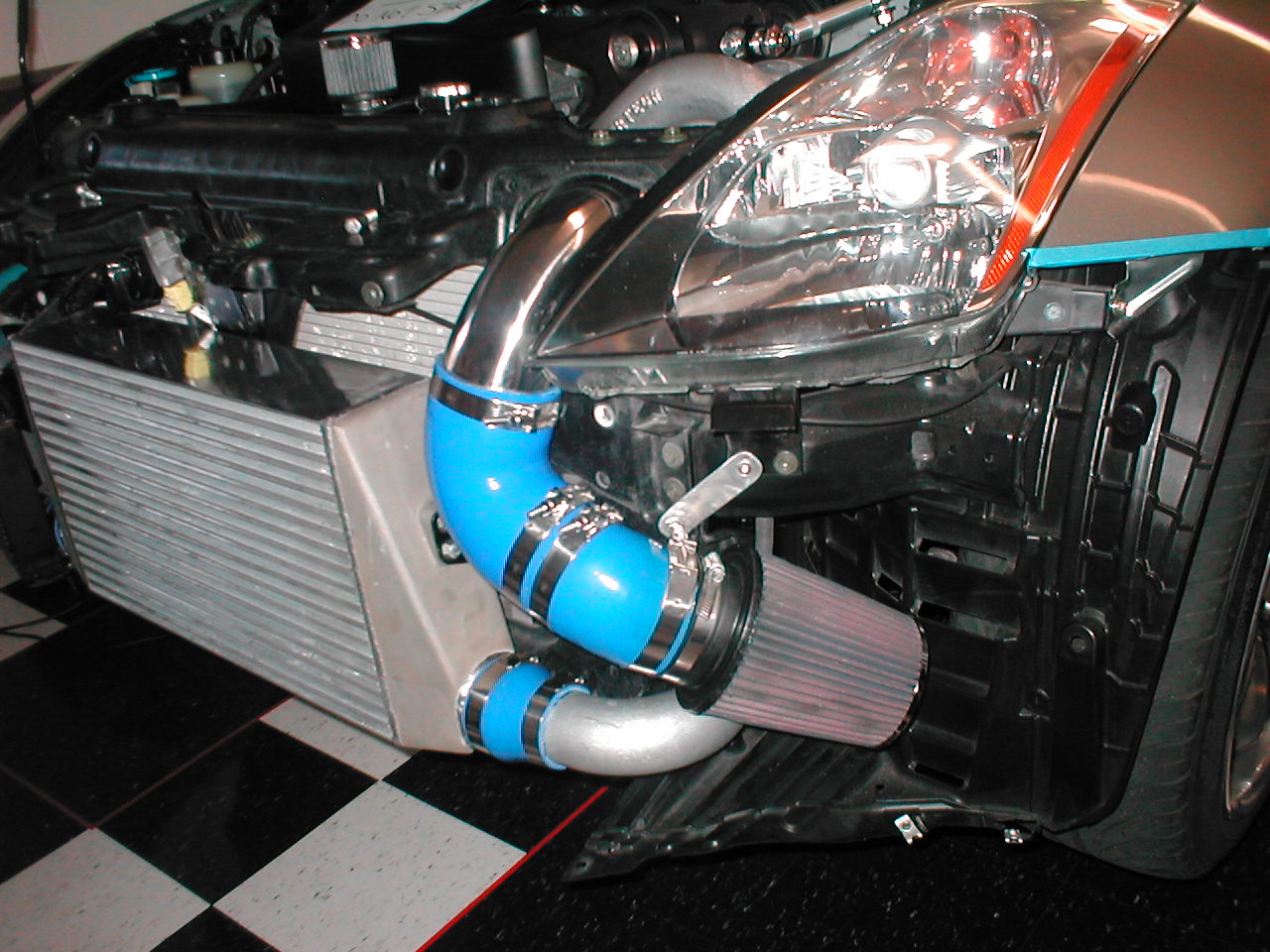

I have a V2 SC-Trim only a 1000cfm and I use a TreadStone TR-1245rated at 1469cfm.
Did you cut into the cash bar to make it fit? Or is it completely intact?

Pic of Catch Can for Logiqal

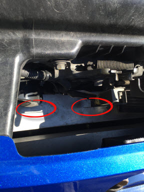

Default TR1245 Fitment
To fit the TR1245, do i have to relocte the horns and trim what looks to be some sort of metal gaurd for the hood latch? I have a pic below. Anything else I should be aware of except for re-routing my air intake that currently sits on top of my tiny 8 inch intercooler.
