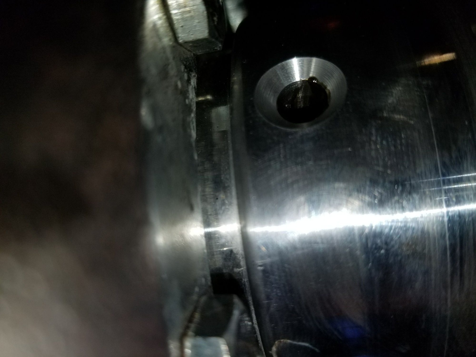

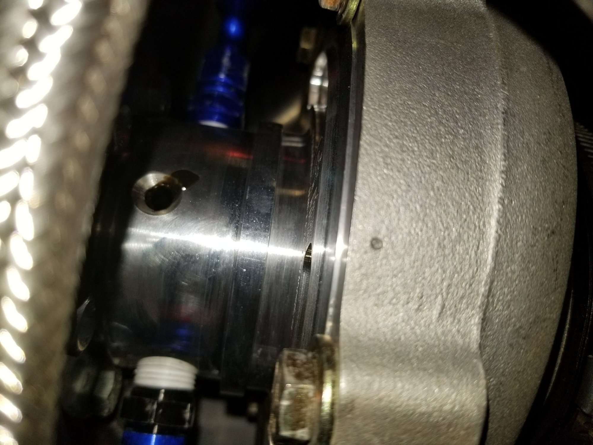

Since being tuned I've put on about 700 miles with no issues....until today. I lifted my car up to just check everything out underneath the turbo and exhaust are and noticed that the Comp Turbo oil-less zerk fitting is no longer there. Please keep in mind that this is the second turbo that was sent to me from Comp under warranty. At this time I am unsure on how bad this is. Without the zerk fitting being there I am assuming that the oil has been leaking out of the hole....how much and how long I do not know but I assume its not a good thing. The zerk fitting hole does not appear to be a threaded piece since no threads are visible on the zerk port. I will be sending Comp a email here shortly to see what they think happened but was hoping members with the boosted performance oil-less turbo kit can chime in or Sasha himself.
Here's a pic before installation when it was new.

Wait is this the water line? Or the grease port? It looks like the grease port but your bottom pic highlights the vibrant water line 90 fitting.
Old Mar 31, 2018 | 08:01 PM
  #77
knuckles899's Avatar
knuckles899
Joined: Sep 2009
Posts: 153
Likes: 26
From: NorCal
Sorry, disregard the red line, it was a older pic I used for something else but I attached this pic to show where the zerk fitting used to be, but yes I am speaking about the grease fitting.
*I have changed the photo without the highlight red line.*
